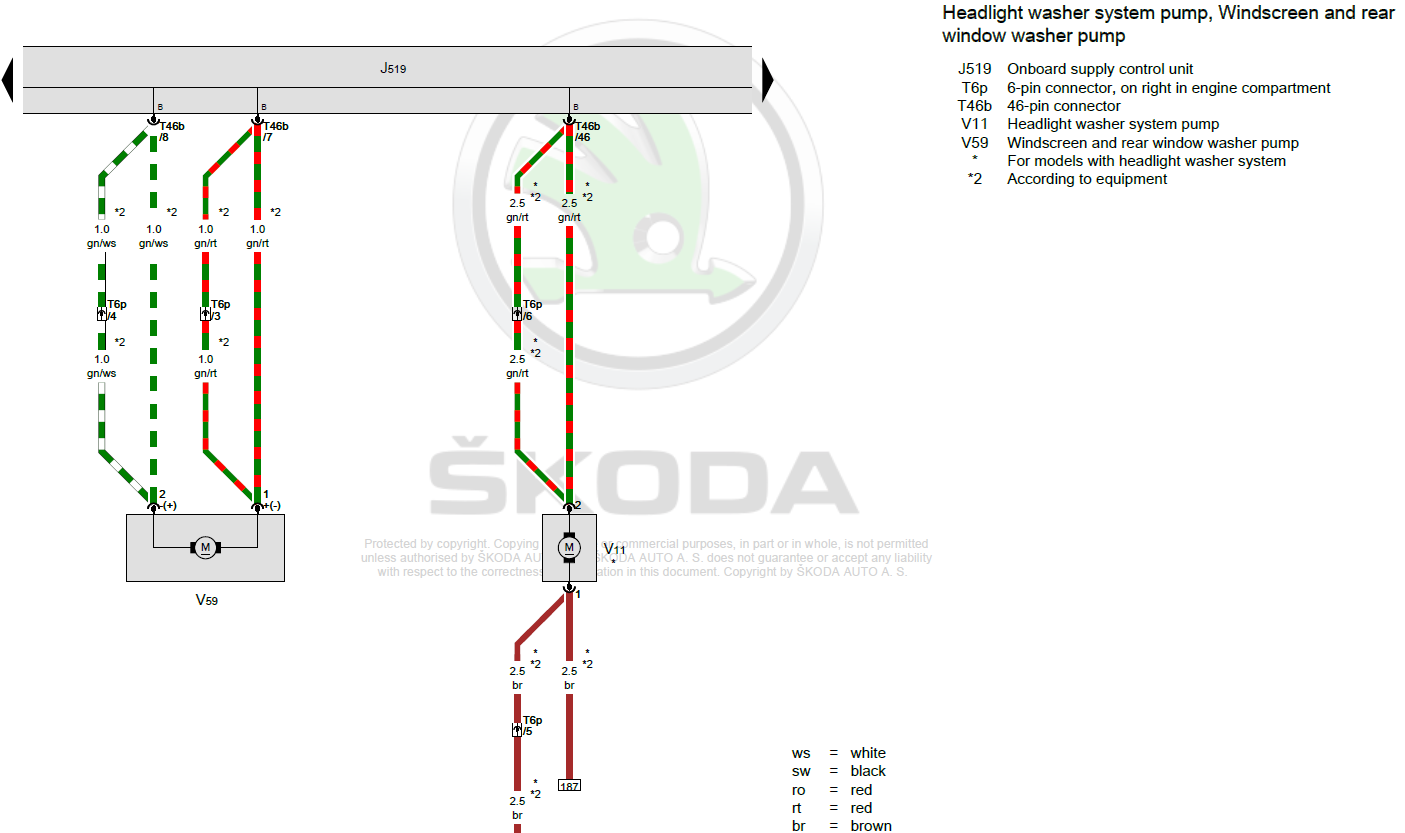

You may wish to check T6p to see if signals are reaching this location, if not then we can track back futher.
662201732_HeadlightWindscreenandRearWasher.thumb.png.edfadebd1b7d8296419ab75e219c9865.png

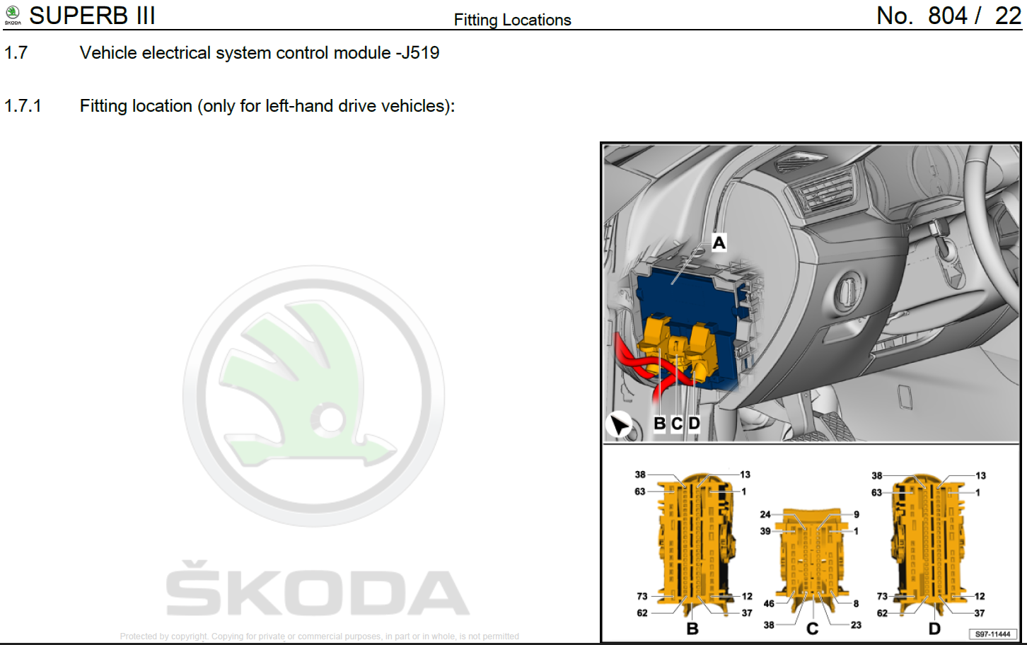

J519 LHD - T46b (Connector C) You can check here if you need to see if this is outputting power.
If not, then we need to look for signal from stalk to next location.

So if both wiper systems move physically, then you need to see if J519 is sending power on the numbered pins from diagram.
If no output on the pins, then you need to look towards the stalk and where it sends the "go" signal to.
If the J519 is sending Voltage towards water pumps, then check if signal reaches connector T6p.
If signal makes it to that connector, the the wire is broken between that connector and motor.
If no signal is making it to T6p, then break is between that location and J519.

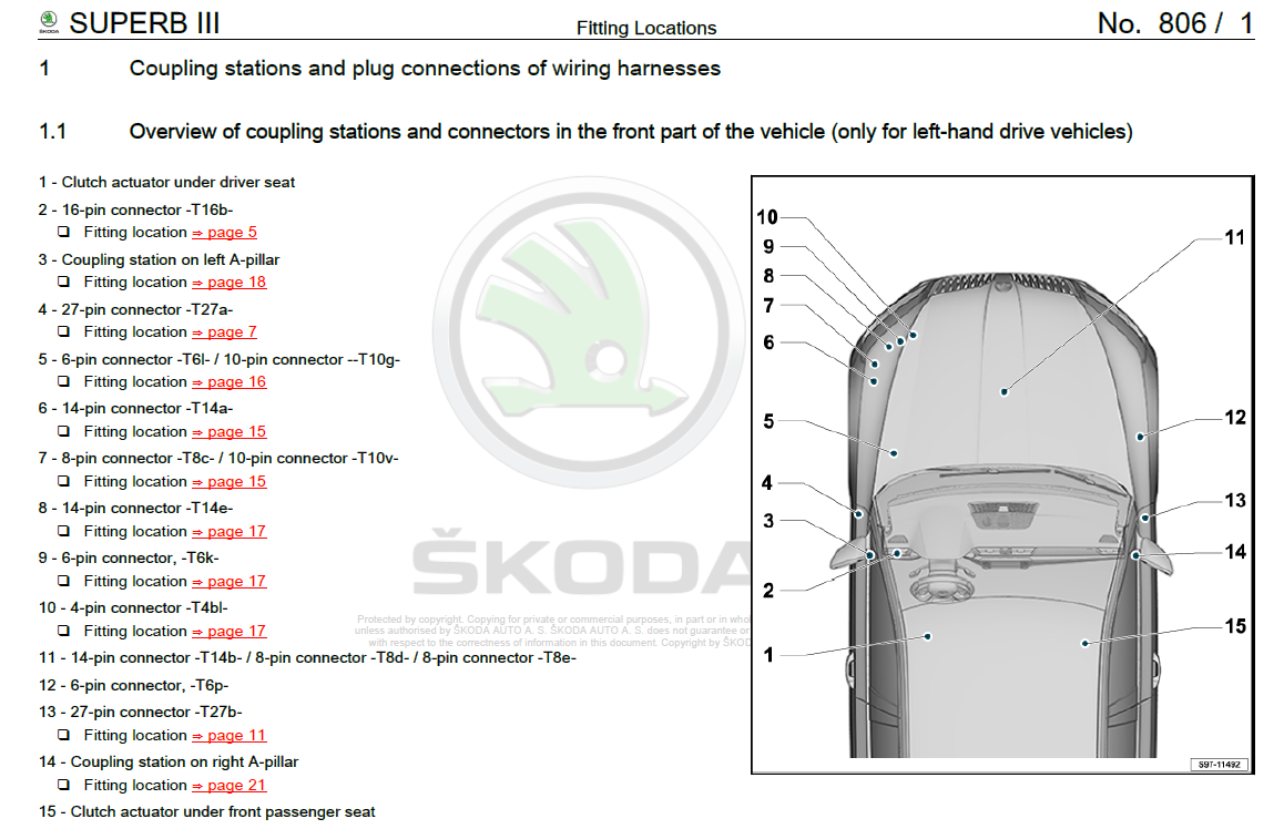

I did not find t6p yet. In the description it says: in the engine bay on the Right hand side. What is the right hand side? Is it right hand side in the driving direction? Of on the right hand side when I am looking at the engine bay?
Always quoted as you sit in driver seat looking forward.
It should be not too far from washer bottle area in theory.
That is what seemed logical to me. However, the BCM is on the LH side of the car as is the washer reservoir...
It does not sound logical to put the connector on the RH side of the car.
T6p location for LHD
Thank you!!
It is a black 6 pin connector on the right hand side.
