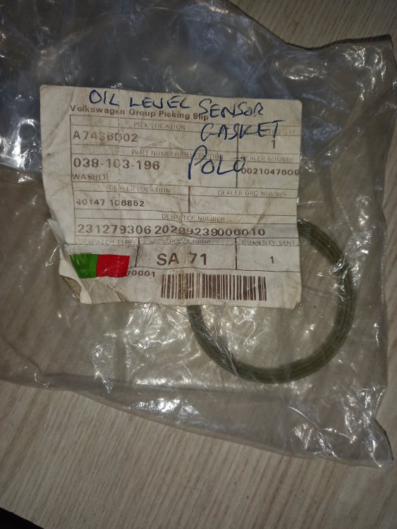

Looks like you'll need item 1 from here which is the o-ring: switches and senders on engine - Octavia(OCT) [EUROPA 2005 year] (7zap.com)
PN - 038103196

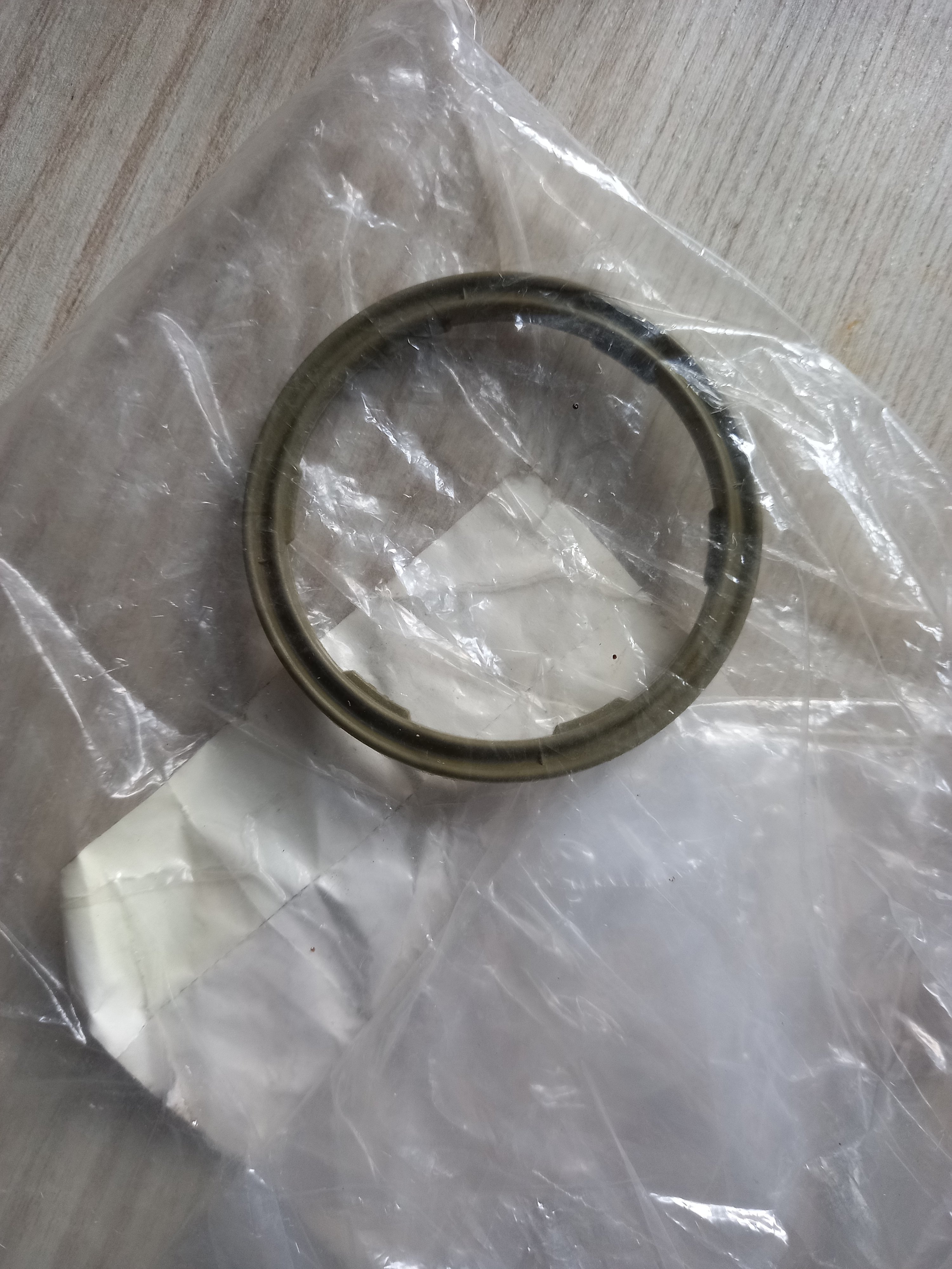

Did find o-ring, it's been around in a drawer for a few years but you can have it for postage plus a couple of quid if you want. PM me if you like.
Hi Pete
I found out through Skoda garage my engine code is BLF.
I have ordered the part through skoda as it was £5 all in and will arrive next day. I hope this fixes the leak, I hope to update you all once the seal is changed.
