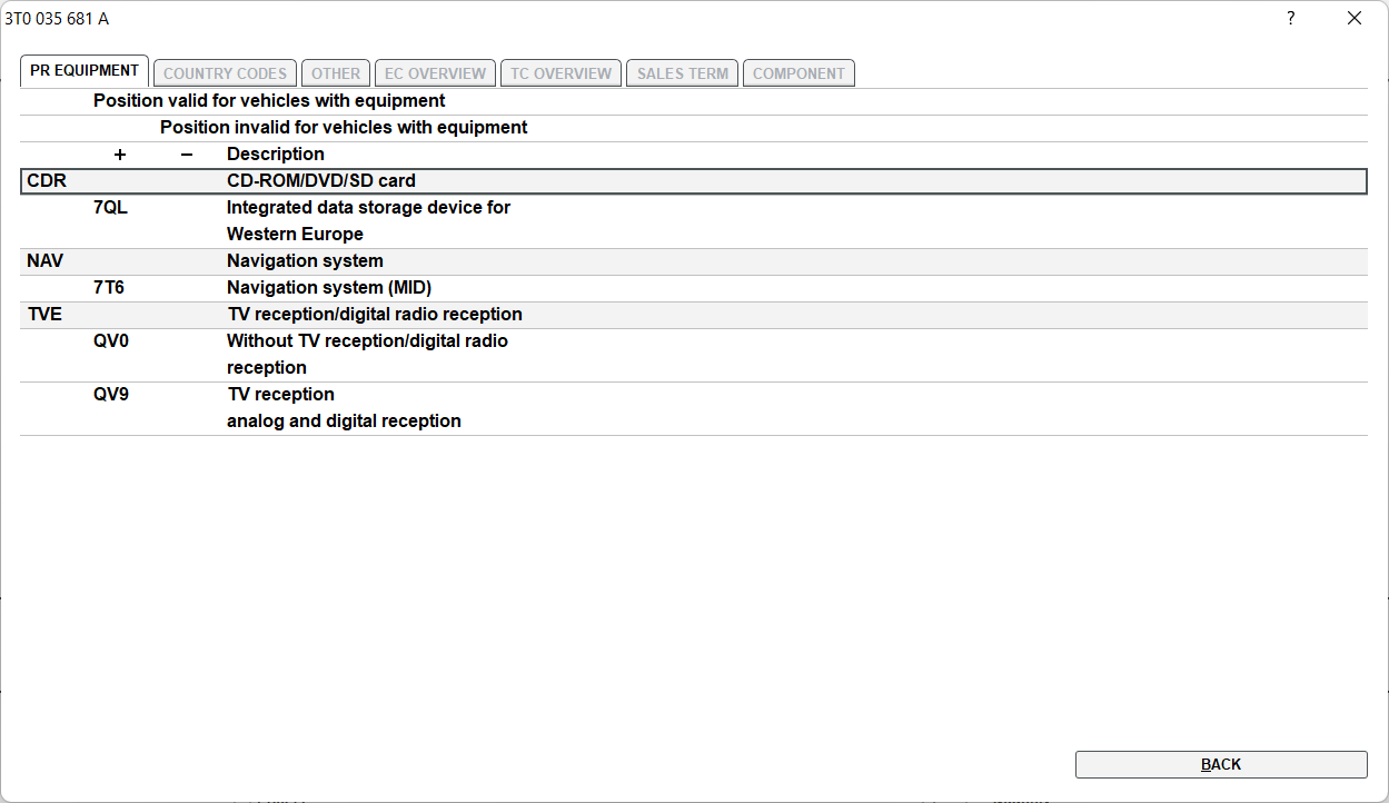

3T0 035 681 C
Fitted from 27.05.2013 to 04.11.2013
3T0 035 681 A
Fitted up to 04.11.2013
No DAB or Digital TV reception
Ideally try to get your exact fitted part, but grab the first choice for it has DAB that (unless you listen to CD's)

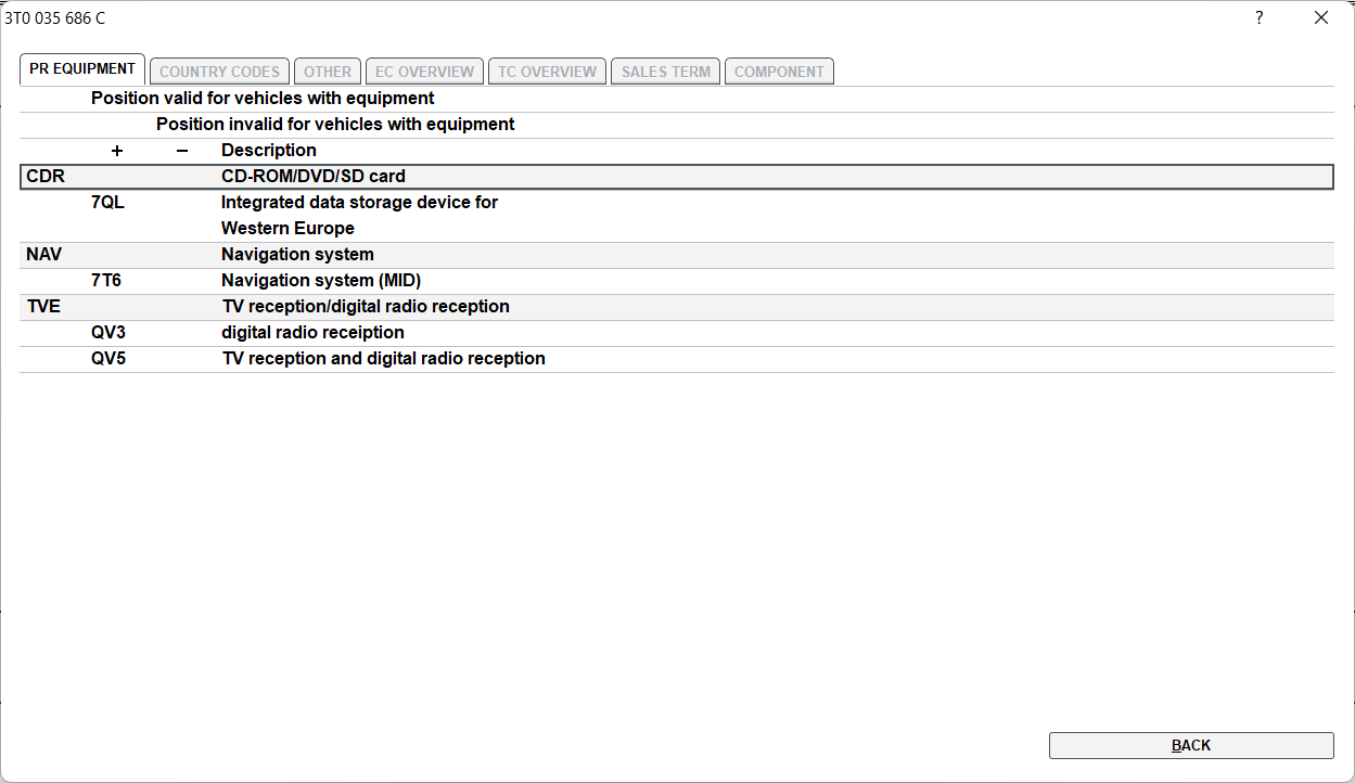

Try and look for anything that is 3T0 035 686 X where it has last 3 digits of 686 seems they are nearly always DAB with PR Code: QV3 = Digital radio reception
The X doesn't matter too much for now, mainly a revision as such.
See what you can locate with those parameters.
Attached a printout of all the numbers, something you can sift through.

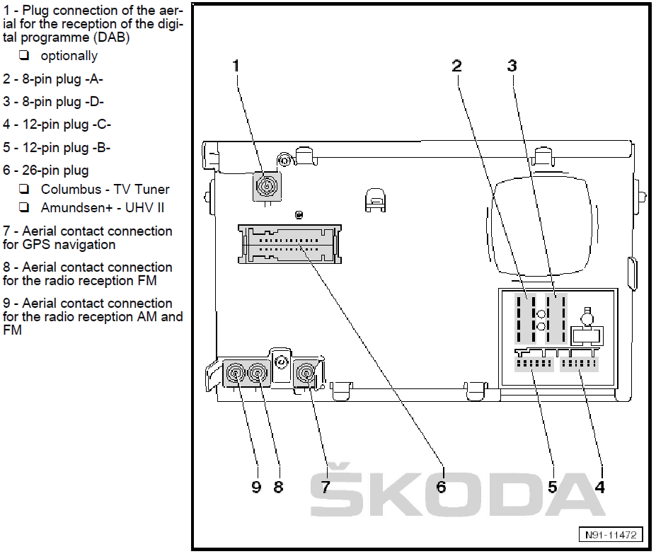

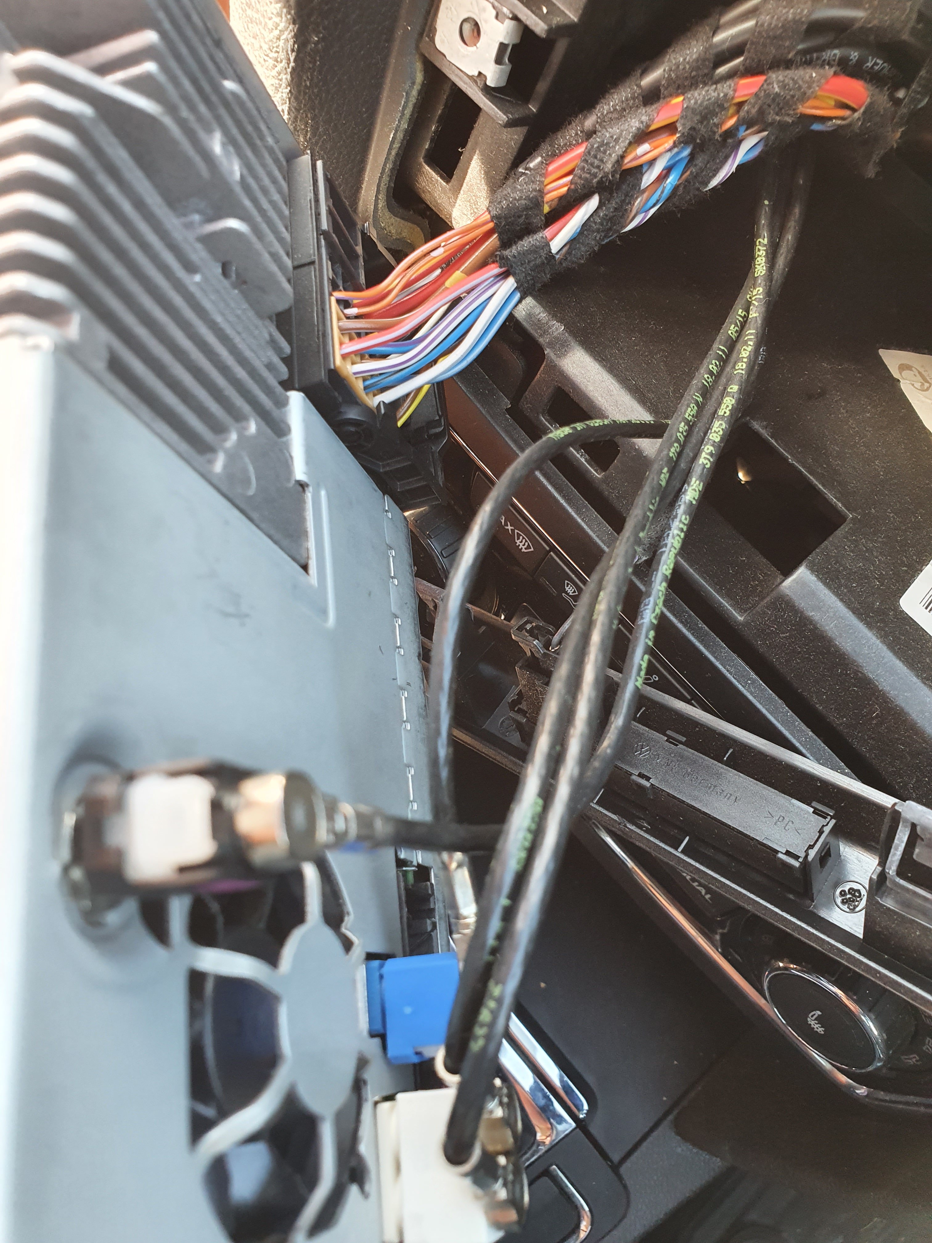

This is the rear of my unit..I have seen most on ebay and none appear to have thar top input above the blue and white inputs.does anyone know what that input is for..Cheers20220821_102730.thumb.jpg.031134da9720efaaca9177203d29f76a.jpg
Here you go Carl,
My gut said DAB, and our survey said...
21 minutes ago, varooom said:
Here you go Carl,
 That is great.thanks for this...as dab doesn't bother me going to opt for the one I mentioned on ebay and like you said he has offered me £100 for old one so thats ok.i am sure the Bluetooth connection is amongst there somewhere...
