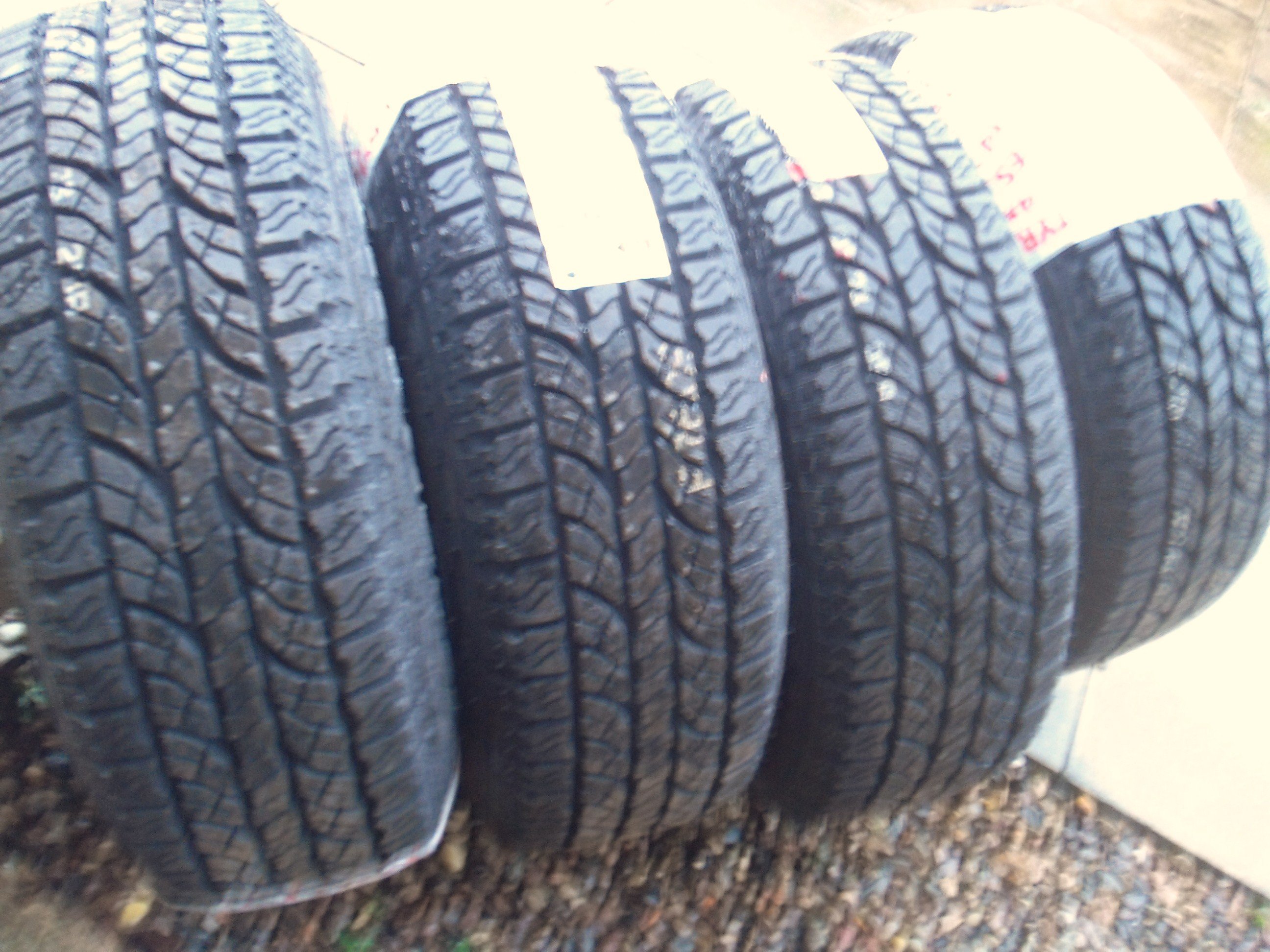

Yokohama Geolander A/T G015 205/70R15 96H (all-terrain tyre, so good on muddy tracks where normal road tyres can really struggle, ie. get stuck)
Yokohama Geolandar A/T G015 4 x 4 Tyre
https://www.blackcircles.com/catalogue/yokohama/geolandar-at-g015/205/70/R15/H/96/m?tyre=35841793

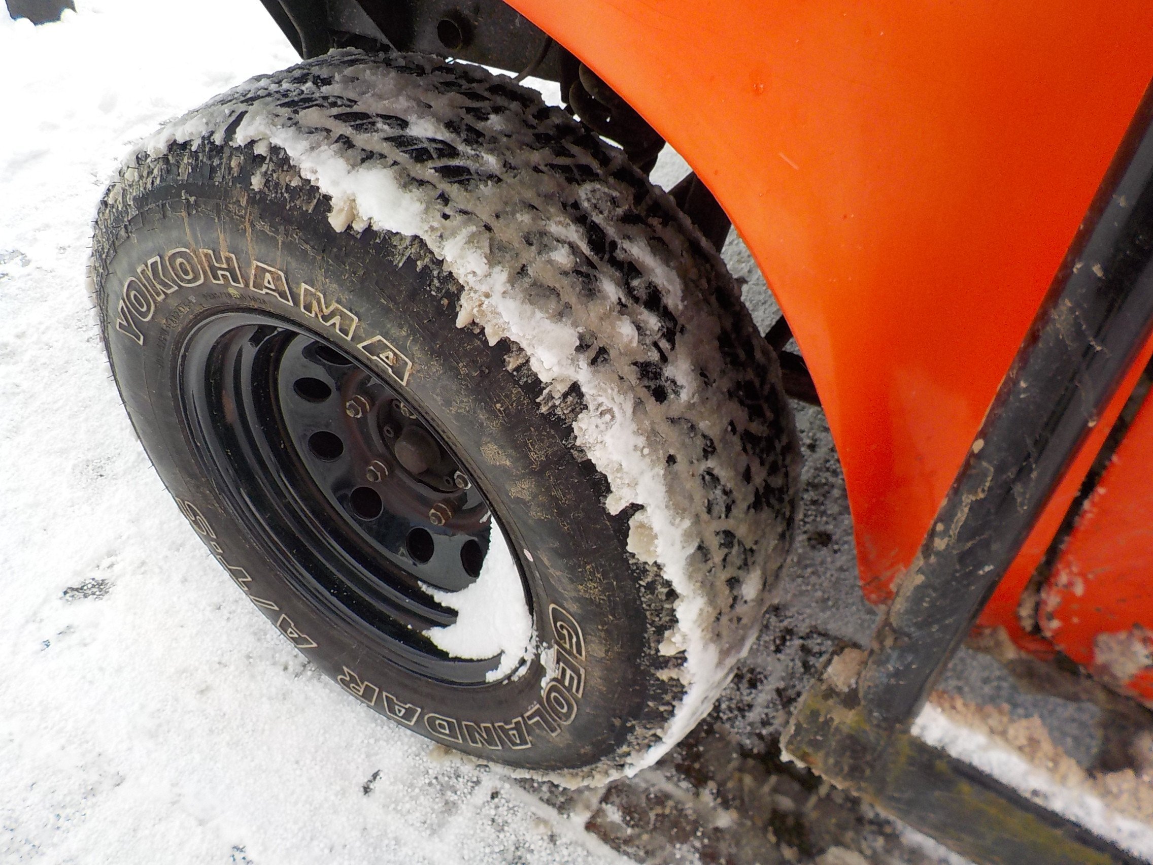

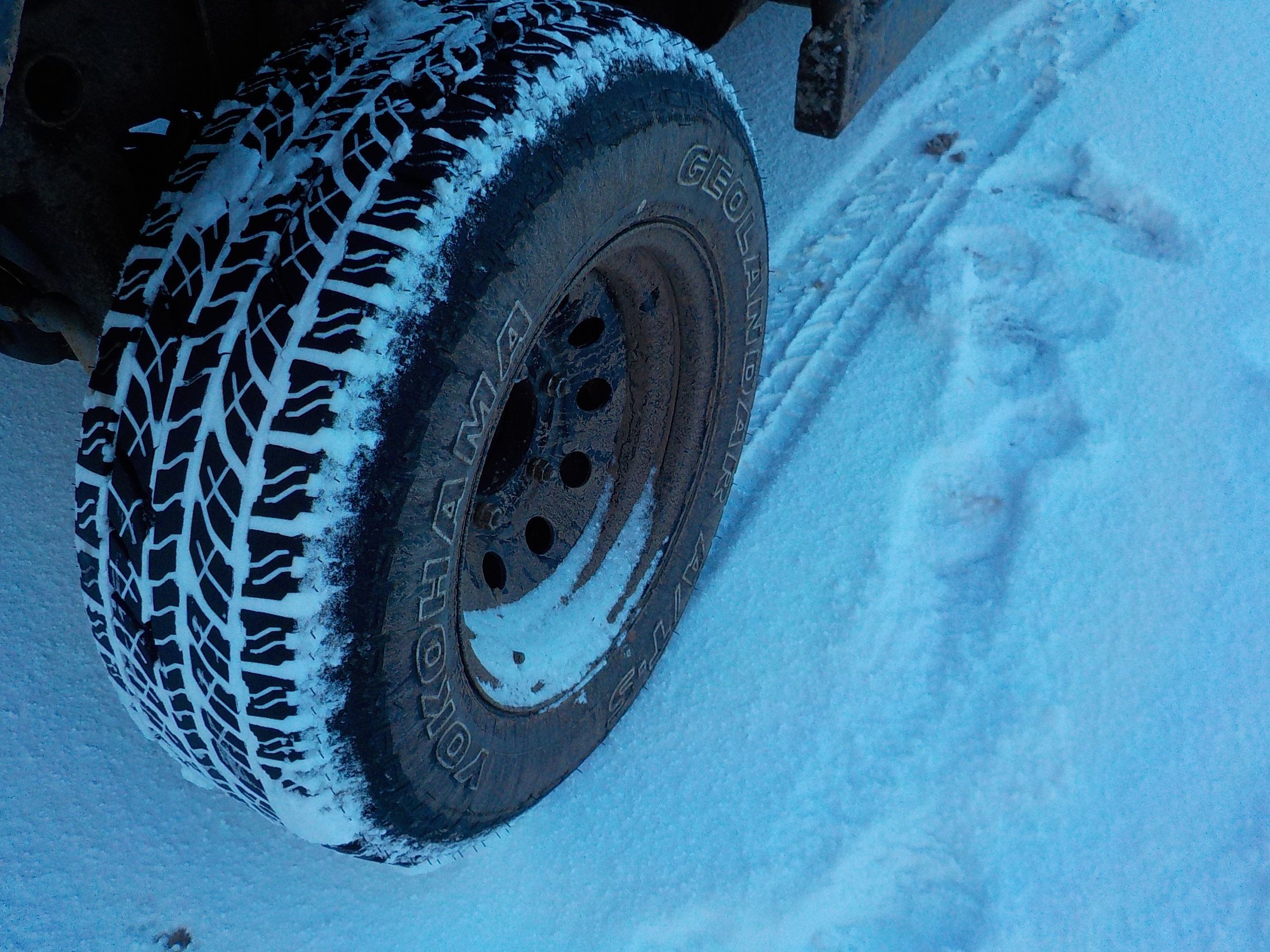

Rocking about in the South of England with Geolanders on 15" wheels fitted to a Kamiq is a bit of overkill.
Then you have to remember as winter tyres they are pretty crap.
But then until you use tyres you do not know these things.
They will smooth out the ride but not reduce the noise.
Anyone who drives across muddy fields and muddy tracks in the summer could get stuck if they don't have all-terrain tyres. For winter it's probably best to change to something with the 3PMSF symbol.
All-terrain tyres don't appear to be available in the 205/60R16, 205/55R17, and 215/45R18 tyre sizes...at least not Bridgestone or Yokohama.
