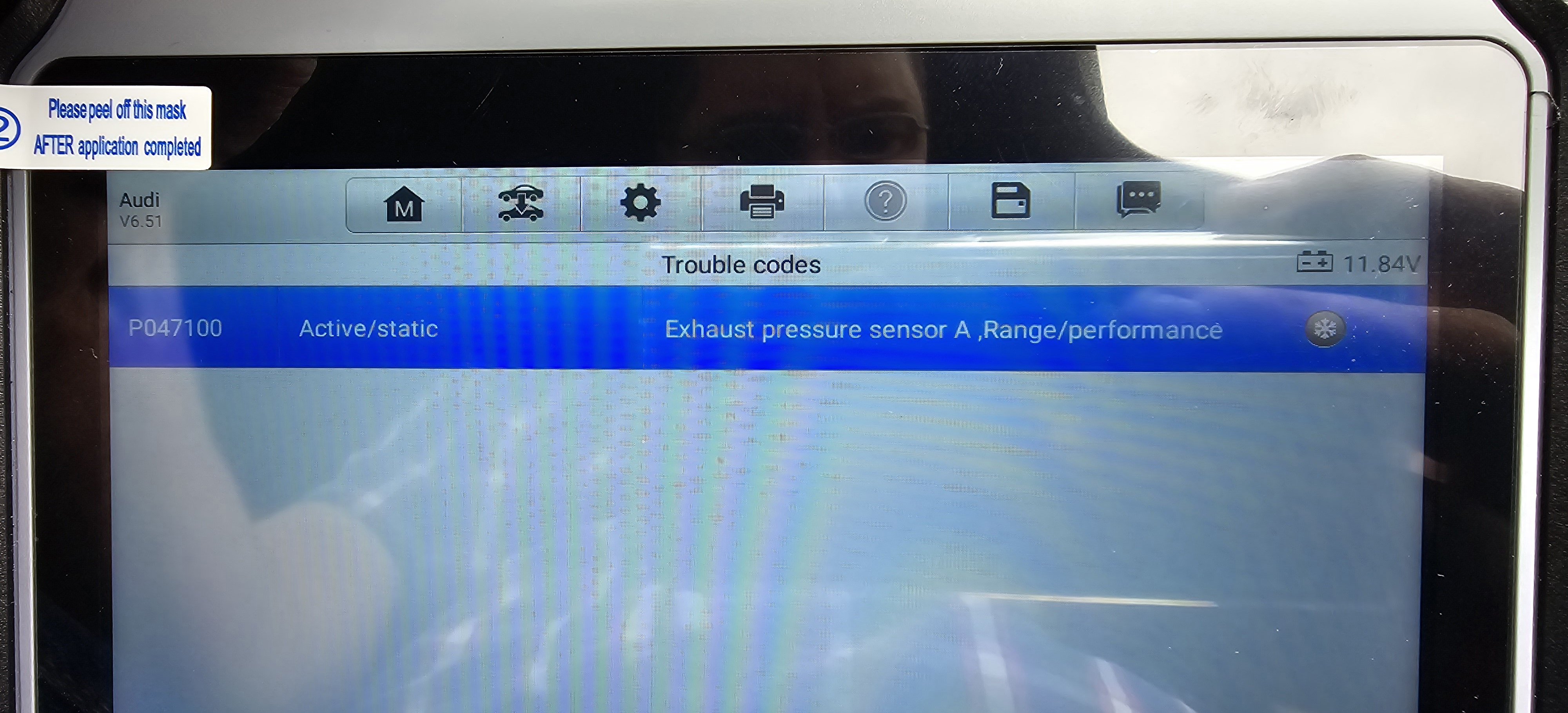

Did you ever manage to replace it? I've got a P0471 code on the same engine and suspect this sensor.
Try a long pick to pull up the security tab and then press the plug while pulling it. That code is exhaust pressure sensor not boost pressure sensor.

What's the exact code? Could be a leak somewhere that flags the code.
Could be the scanner your using, have you tried a different one to see what it comes back with? I've got similar engine, mines the dpca, is yours dada?
Edited by Blue8793841
Hi, My Autel maxicom generates this code and so does my Bluetooth obd dongle using the torque diagnostic app on my phone.
Both say P0471 exhaust pressure sensor.
Might have to book the car in with a dealer as i've ran out of ideas what to look into next.
I'm not familiar with the gpf tbh, maybe it has a nox sensor that's flagging the fault.

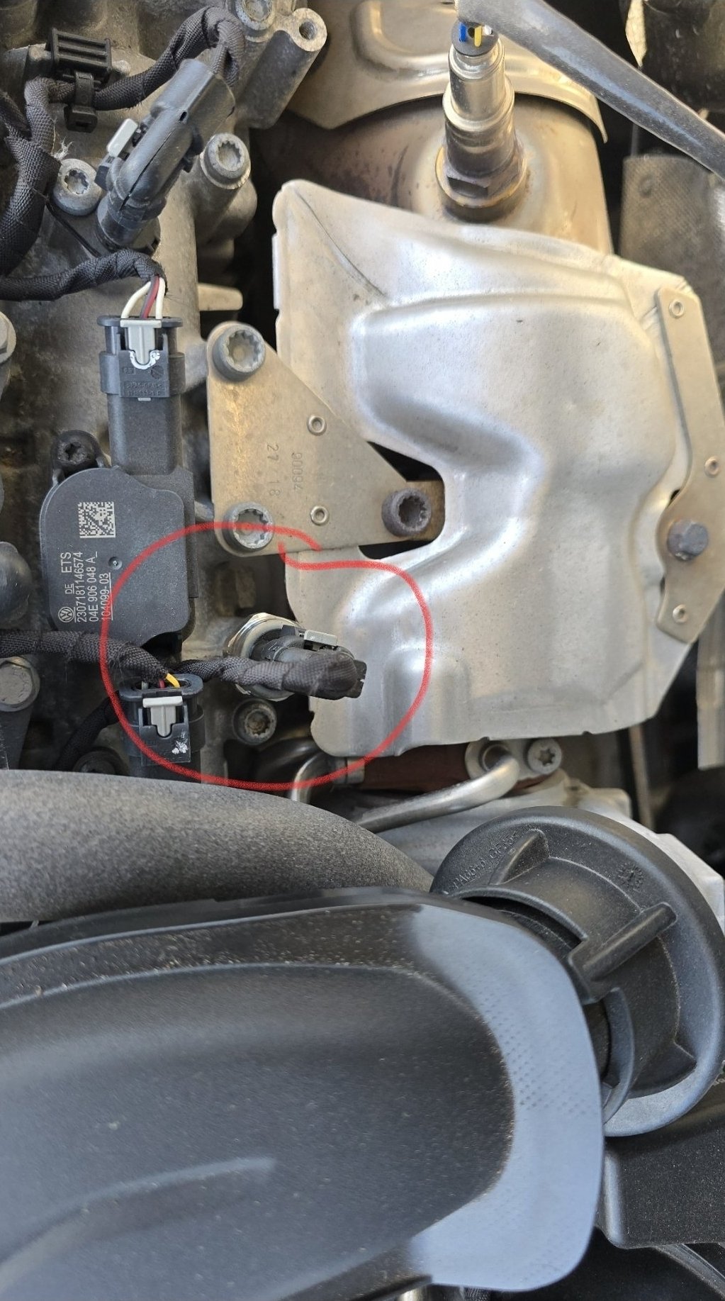

Hi, did you find out that was causing the P0471 exhaust pressure sensor on the 1.5tsi?
Yes, the exhaust pressure sensor was replaced as circled in the pic. Has been ok for over a year now.
