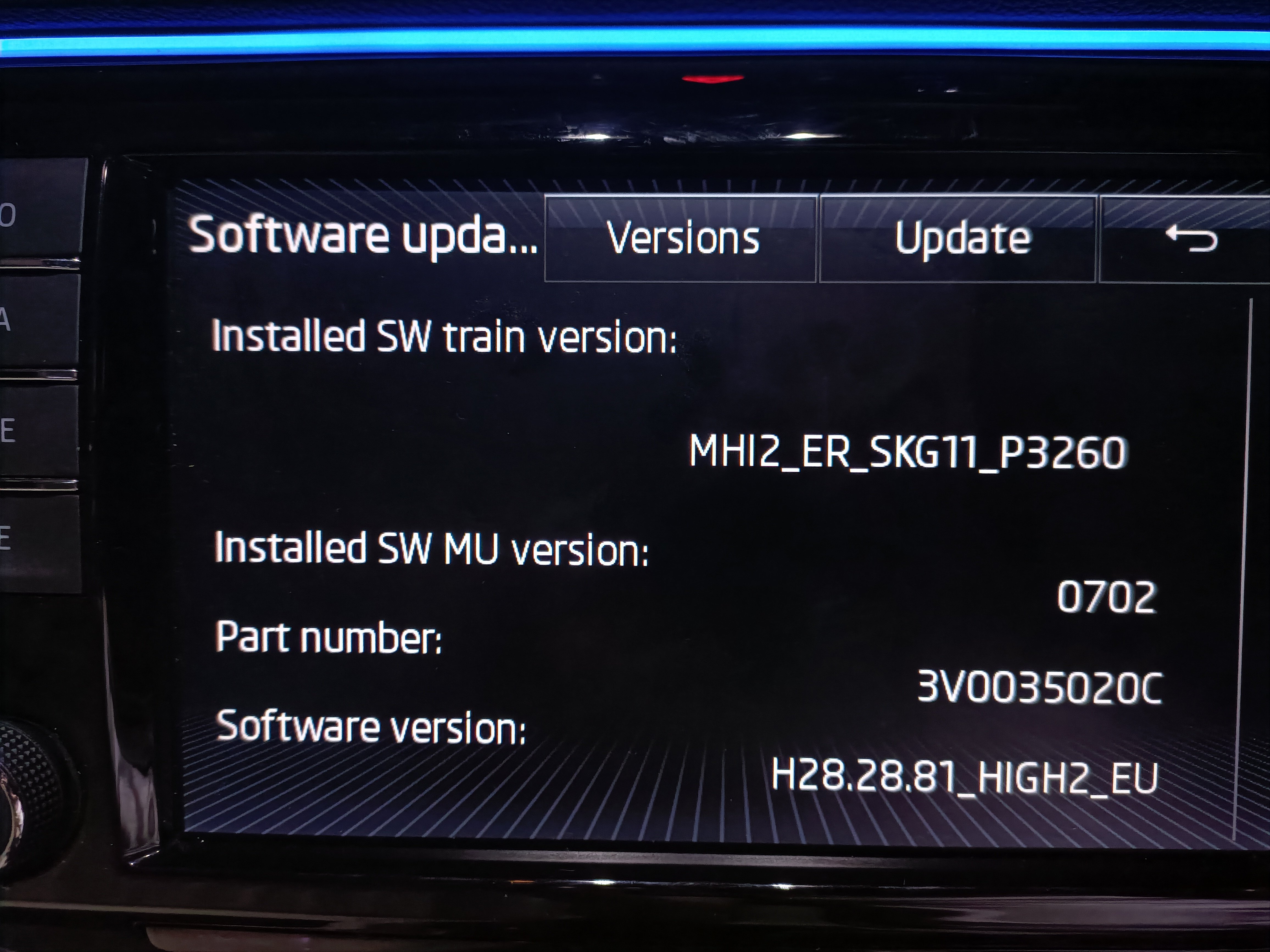

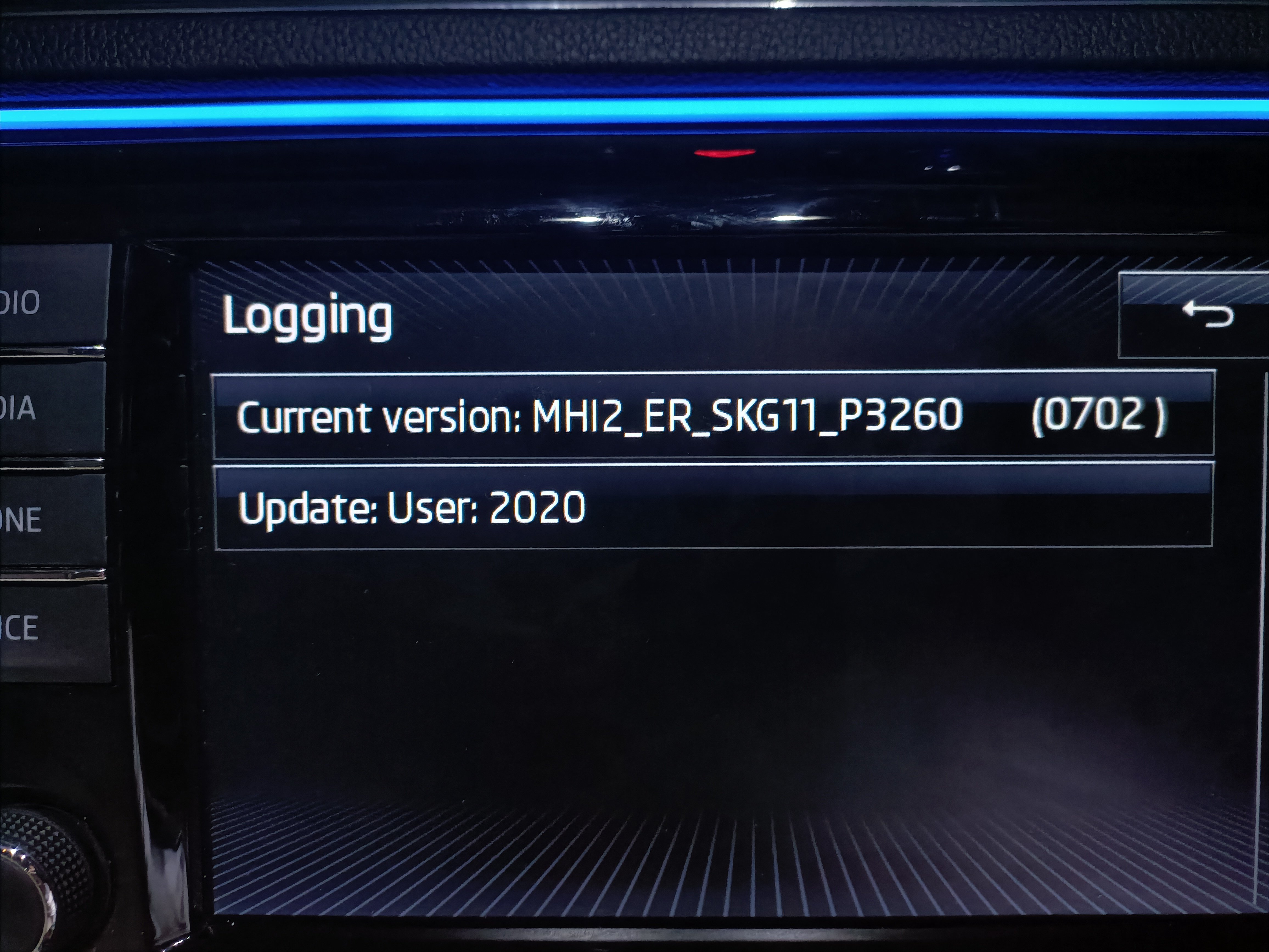

If you are thinking of new firmware, you need to hold down menu or setup button for a few seconds to enter the update menu.  You are looking for SW Train or Software Train depending on how they write it.
A picture says a 1,000 word's, so best take and upload information.
release = "MHI2_ER_SKG11_K3343"
MUVersion = "1433"
snip
SupportedTrains = "MHI2_ER_SKG11_P2104*,MHI2_ER_SKG11_S2104*,MHI2_ER_SKG11_K2129*,MHI2_ER_SKG11_S2129*,MHI2_ER_SKG11_P3260*,MHI2_ER_SKG11_P3304*,MHI2_ER_SKG11_P3325*,MHI2_ER_SKG11_K3330*,MHI2_ER_SKG11_K3333*,MHI2_ER_SKG11_K3343*"
Yes the update named at the top will update your SupportedTrains entry.
At your own risk, I can send you a link to download and apply.
