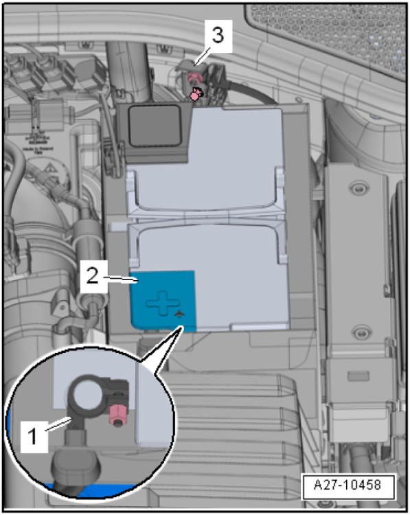

Yes it's behind battery (3) for negative

The other thing is I'm concerned whether I'm connecting the negative charging clamp to the right earthing point. I was hoping the photo would show where I've stuck it. It's an upright metal bit screwed to the bulkhead just behind the battery. Where it's screwed in, there's 2 screws with wires attached and they're brown. Does the sound right?
Ahh, thanks for that diagram. Looks like I've attached it to the right thing. 👍
I'll have to give it another go. Really worried that I had caused damage (after waiting 10 months for it. 😱)
Yes that’s the correct connection for -ve lead from charger. Photo shows you have a EFB battery not AGM.
