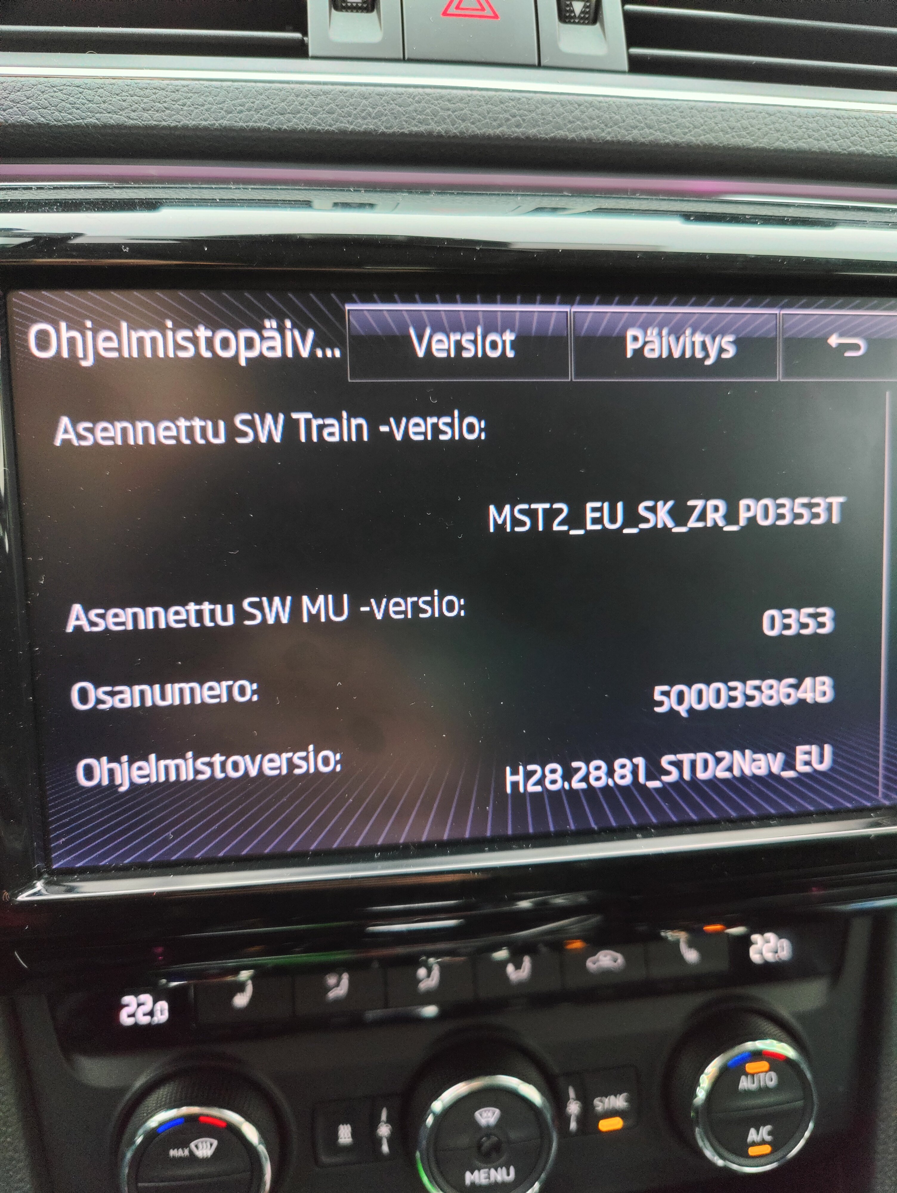

Anyone know, if there's newer version for this ? System has slower response to touch or wheel scrolling.
Yes there's an update to 0369
I will send you a link shortly when I can.

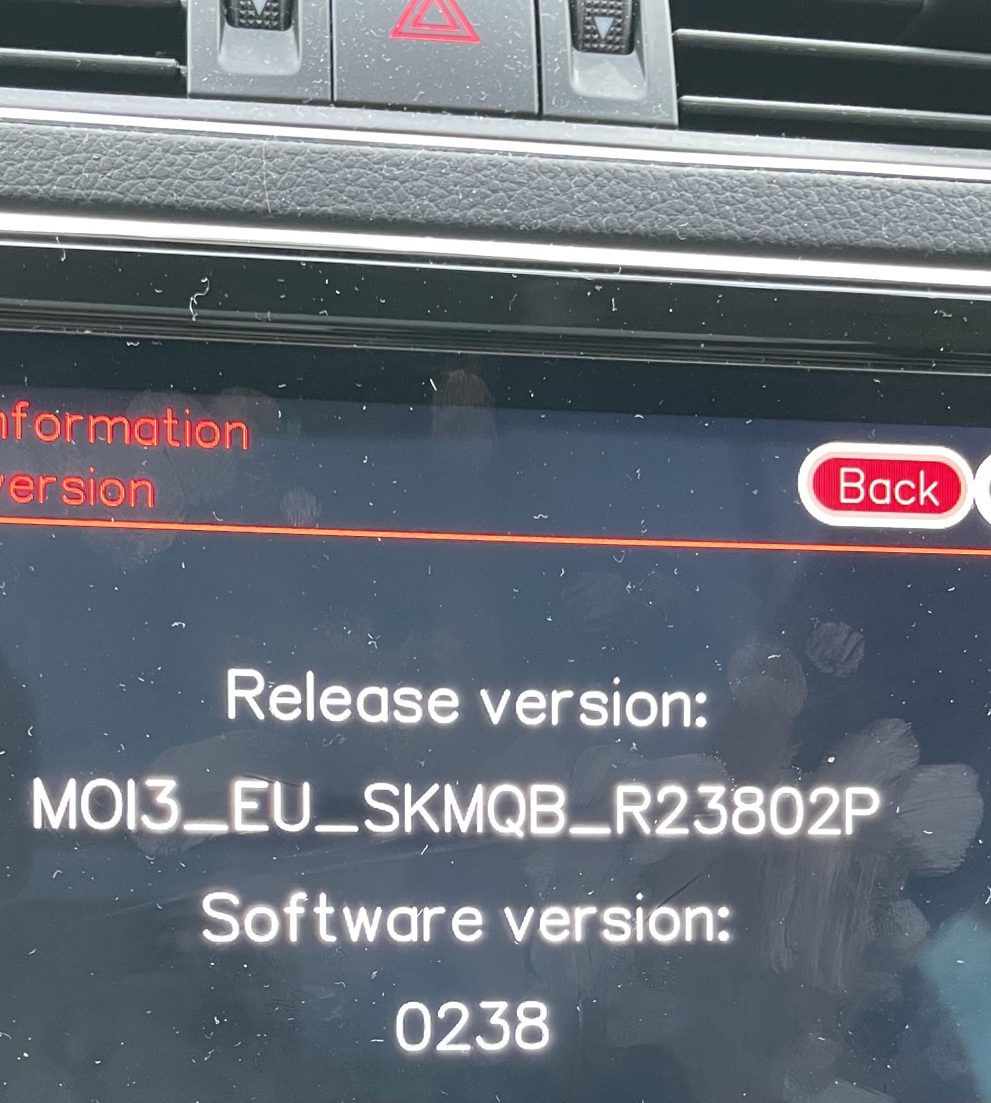

@varooom you wrote in an earlier post that 0238 could be updated to 0278. I have some problems with crashes and random reboots in 0238.
Is there any chance you can send me that update? It would be appreciated! 🙏
If you accept the risk yourself to load this, then sure.
I have only got MIB2 radio in my own car, but provide any files needed, provided you accept the risks.

I was just reading which package you need, it's a 10GB unpack/repack I need to perform.
It exist as a two-part update, as you cannot go directly to 0278
You will step from 0238 to 0268
Then it will allow you to update to 0278 as you cannot go directly.

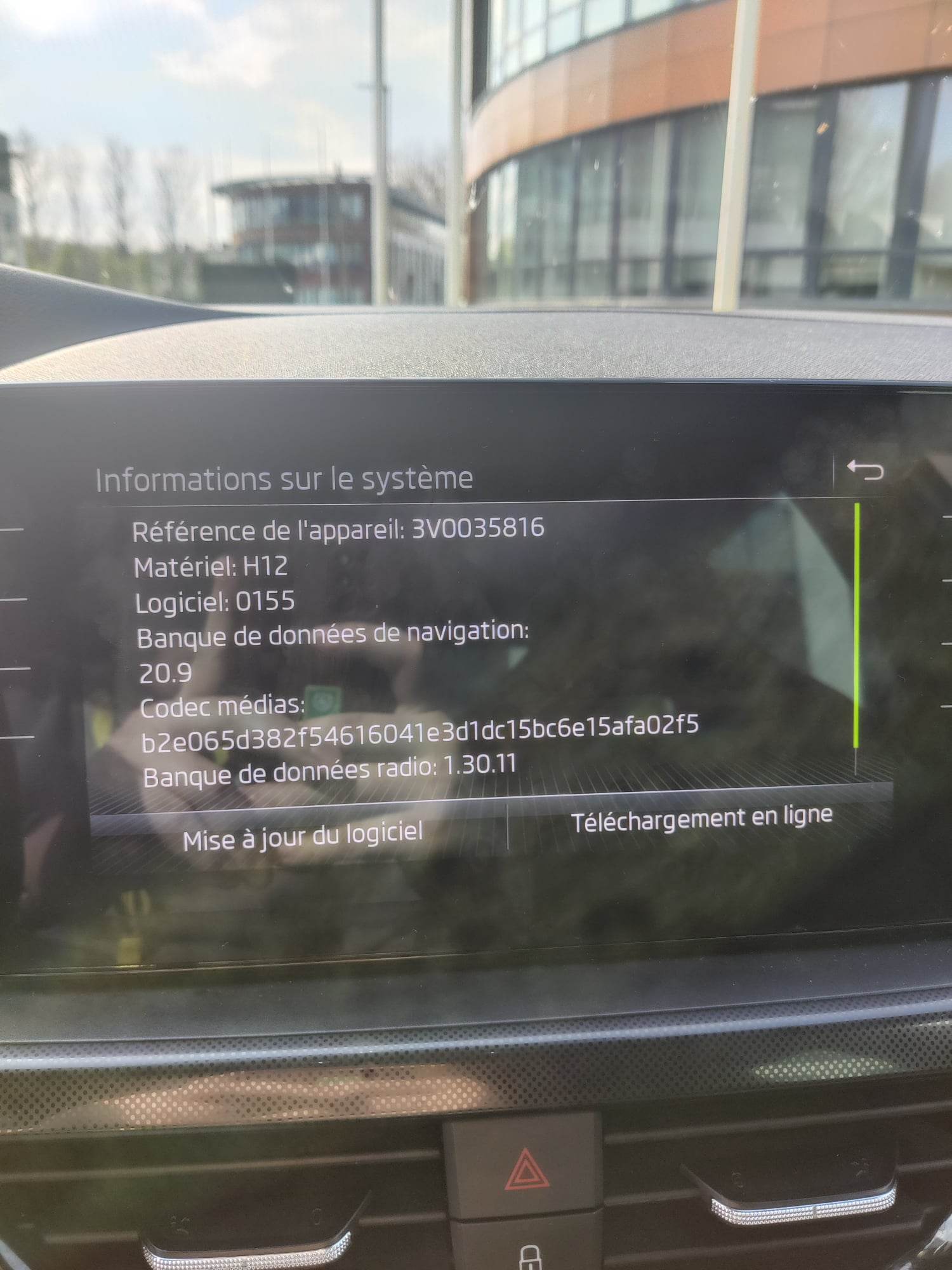

Hi !
I'm stuck on 0155 and can't update, did you know if i can get a newest update by any chance ?
thanks !

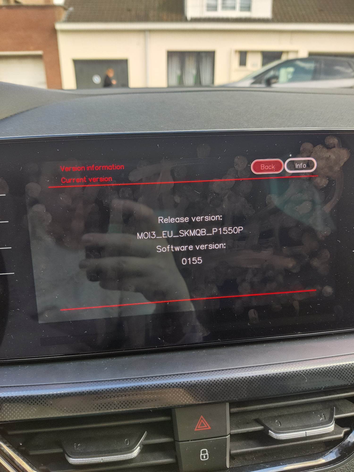

8 minutes ago, Inconnul said:
Hi !
thanks !
Take a read of this post, https://www.briskoda.net/forums/topic/512288-update-my-car-from-0156-to-0306/
I have the files, but if you update, you will loose activation codes for Sat Nav.
This update is dealer only, as you need to program in new codes for functions.
First of all, thanks for your answer !
So basically, can i do it by myself ? (i don't use Sat nav, so that's ok for this)
Could you please send me theses files ?  (if i can't do this by myself, i'll give them the my dealer)
Currently for user @Lennart his OCU module is not happy, as it seems to have a parasitic drain.  Hopefully he will post here or update his post with any possible new information.
I would recommend you wait until he has seen the posts above and, he will be able to advise you if you should attempt this at home.
yes you can do it yourself (the update part) but you need odis for configuration.
Search for TPI: 2060553.8 on this forum (or online) for detailed instructions but be aware of:
- After the sw update you need to activate a new SWAP function. The code is connected to your VIN and placed on a mentioned excel sheet which can’t be found online. You need to fix it via a dealer. If you don’t activate it, you will see the message “loading maps…” all the time. Activation is easy btw and after that, the maps are working immediately.
- You need odis for the new configuration for the OCU and the infotainment system. Otherwise connected features won’t work as expected. That’s where my frustrations were. It was working for 90%  but wanted the 100% 😉
With the current knowledge, it could be done within an hour (maximum). Indeed my OCU is fried 🙂 hope to get a new one next week (finally).

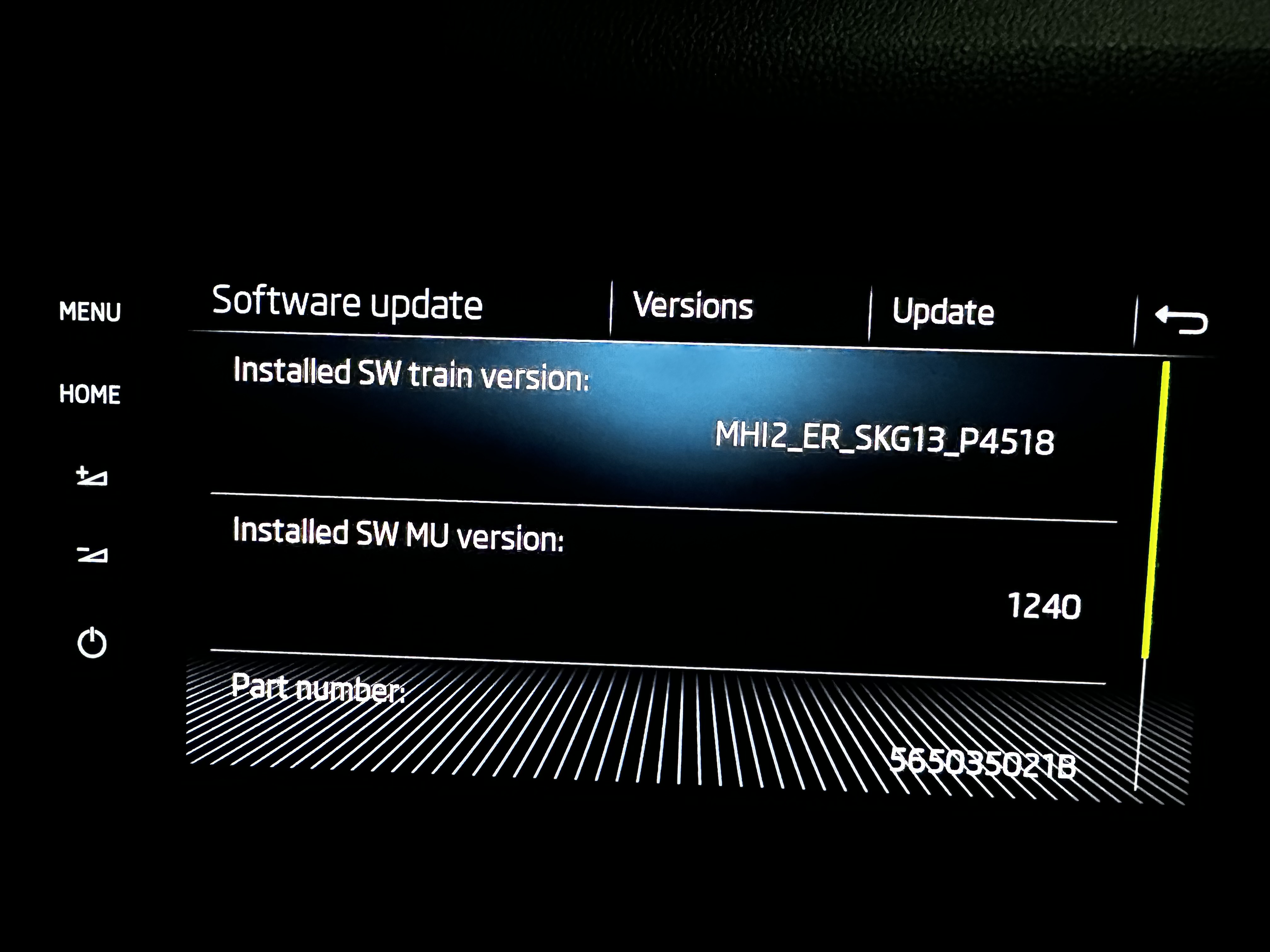

Hi @varooom ,
I have got the MHI2_ER_SKG13_P4518 software train. Is there any update please? Can you please check and send the update if any available please?
