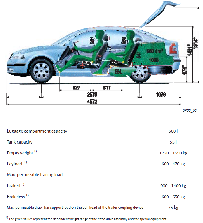

The empty weight range is quite large, and has the caveat 1) listed underneath the picture

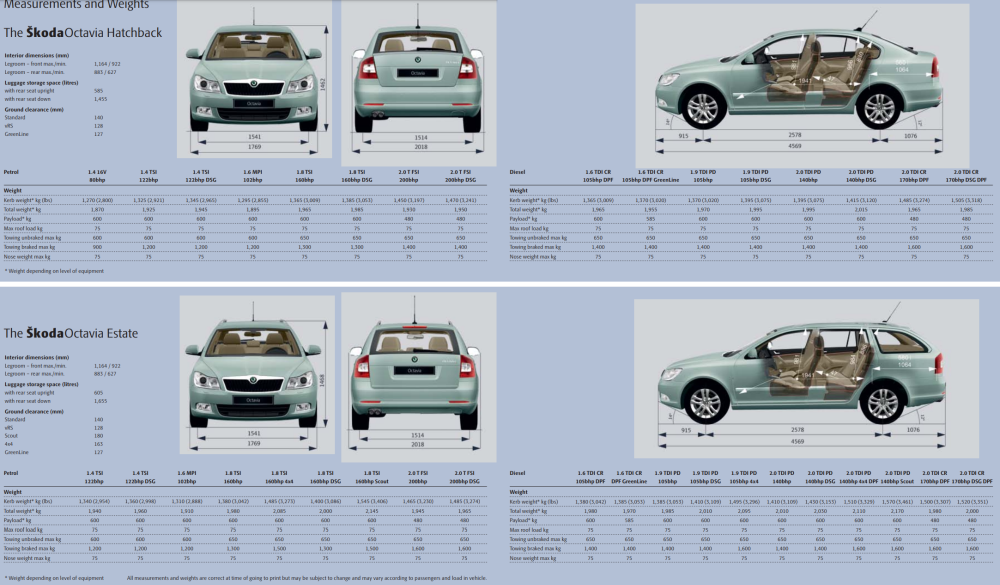

Both the 10/2009 and 01/2010 brochures show the following table which suggests the estate is ~15kg heavier in it's 2.0l TDi form:
Interesting.  Do you have similar details for the estate as well?

That is from the SSP document (training material) for Octavia II, and having skimmed the document there is no difference and they simply lump in all in that weight range.
The picture/data tables from old catalogs like @langers2k just posted will give you more better comparisons, but still the caveat applies of specification will change the values.

So looking at that chart you could use either for towing as their capacities are identical in hatch or estate , interesting that the only difference is boot space (seats up)
