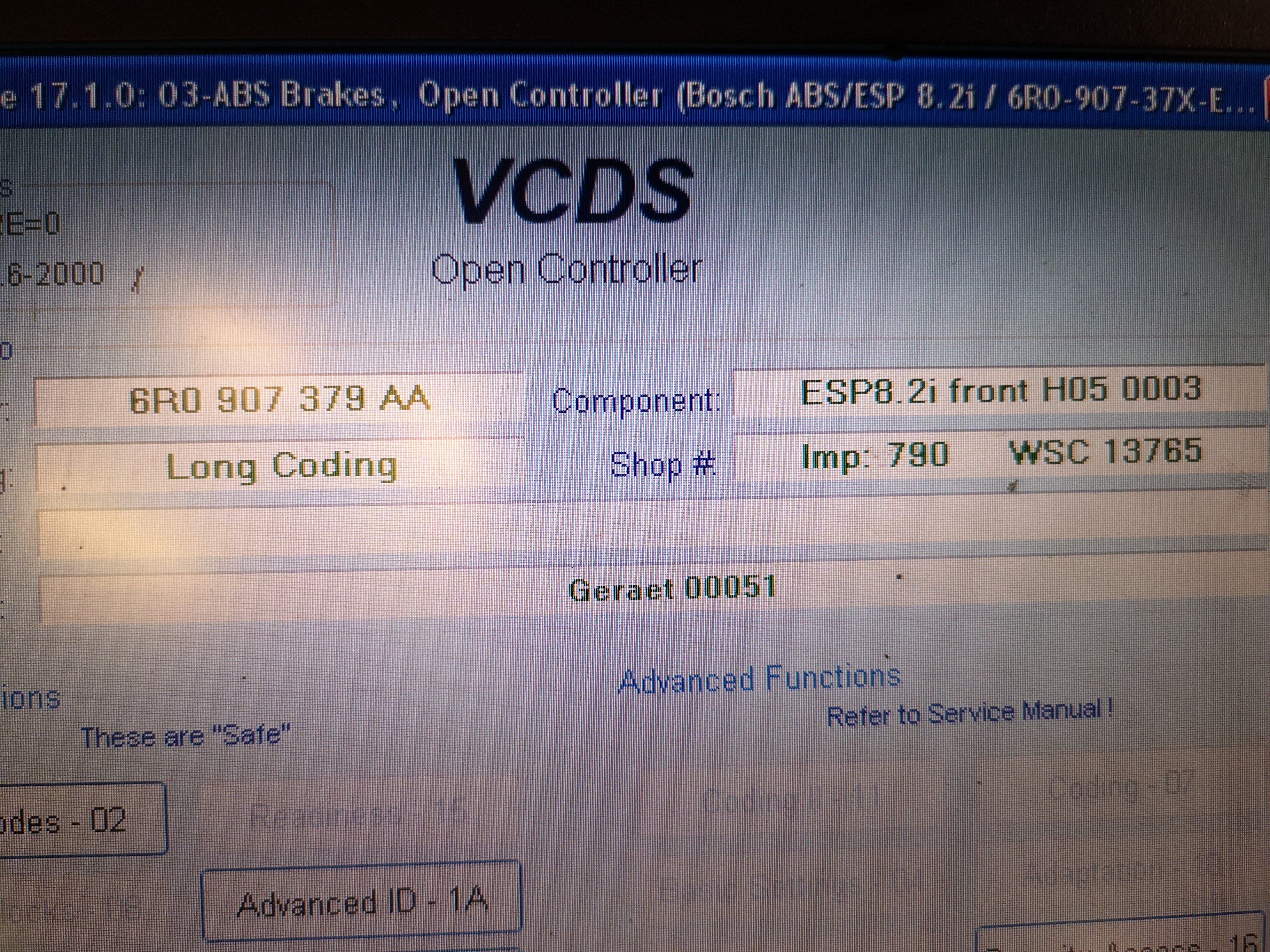

no not really, if you have your VCDS, above where it shows code as 00000000000000 it will say component 8.2 or etc ?? have a look....

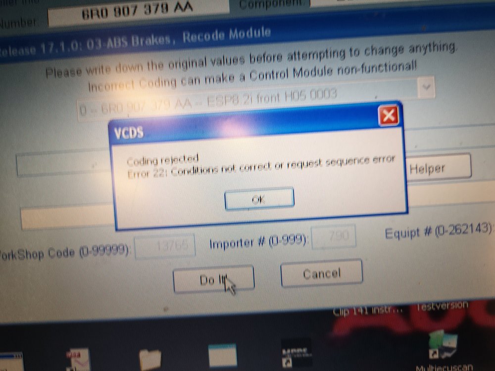

Hi on putting the code in i get error code see pic any ideas please would be welcome ? Thanks
mmmm......
Your VCDS is very out of date,.....current version is 22.9
Are you using a "dummy" / 3rd party interface ?
can you not update that first, then try again ?
