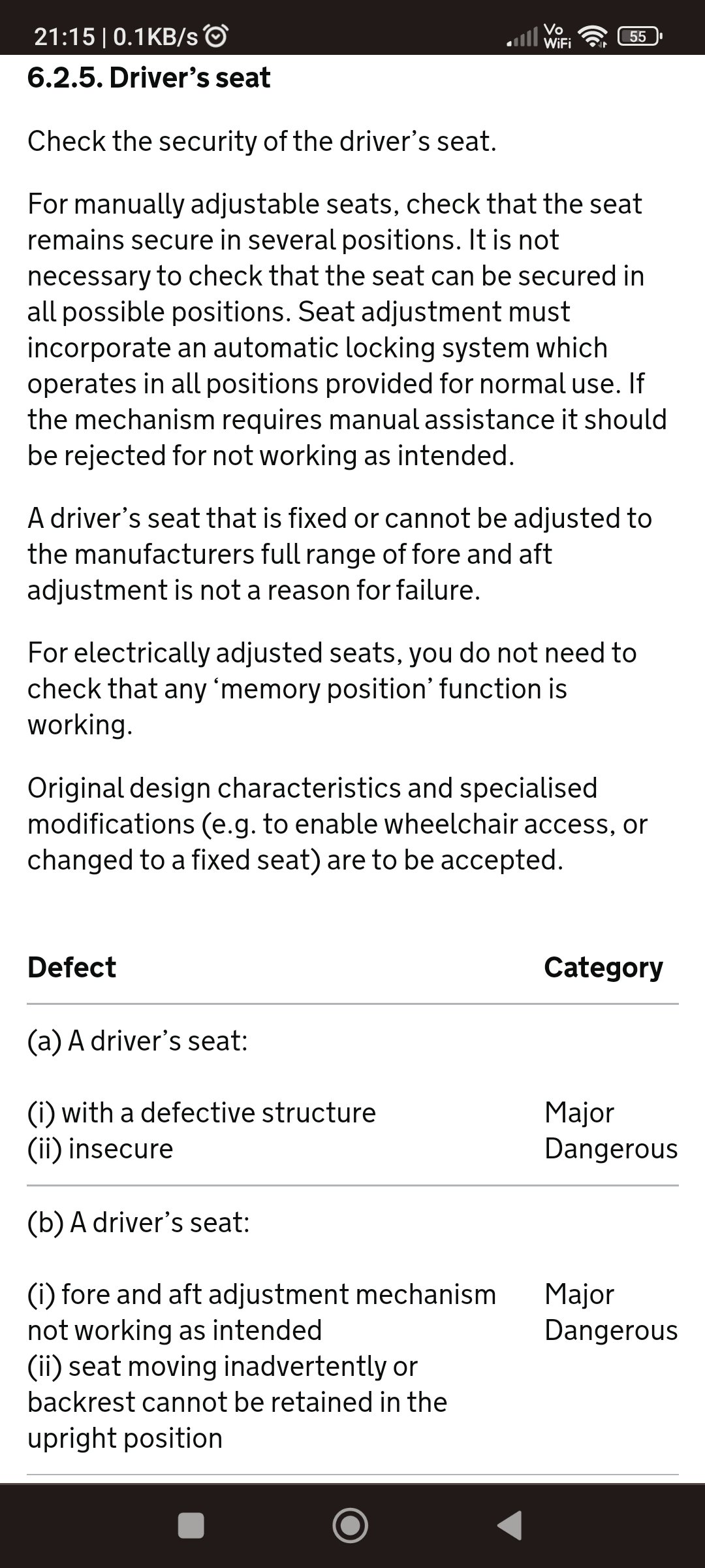

What? I've never heard of a car failing an MOT due to a seat not working. Loose, yes but not 'working'?
It's this rule (yup, had to look it up)
Amazing!  But I guess in an accident you could be trapped.
Screenshot_2022-09-16-21-15-35-770_com.android.chrome.thumb.jpg.0743e54e6789bf5beaa6132d70f7bdaa.jpg
Blimey, every day's a school day!
