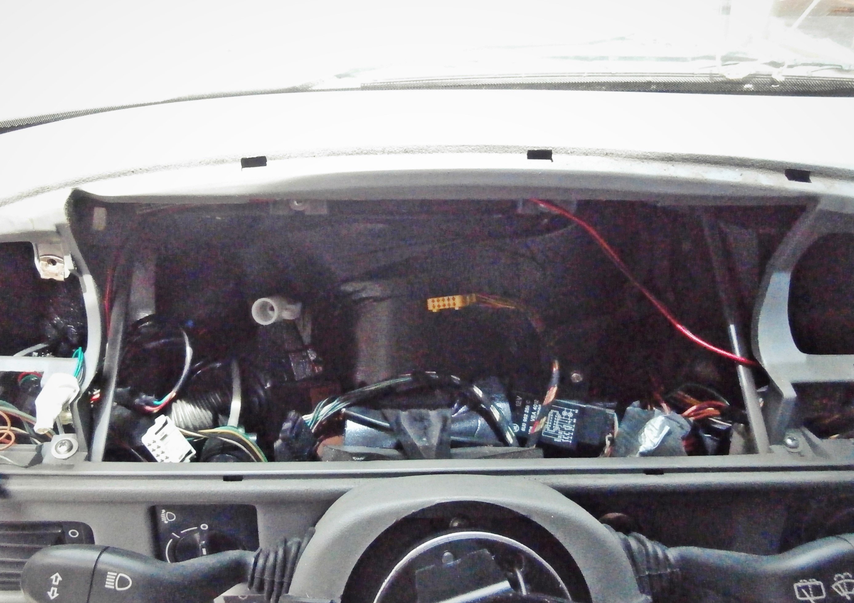

On an LHD car, it's on the firewall, behind the instrument cluster. (Photo from the Internet). I'm not sure how much different it is on an RHD car.

Time to take out the cluster then 😃
Here as is in my Felicia.
The background is different because i have added insulation.

Thank you!
Our car (we got it free) has no central locking.
There was a fuse in place, as well as a battery in the key fob - thats why I resarched further.
But no relay behind the meter house.
