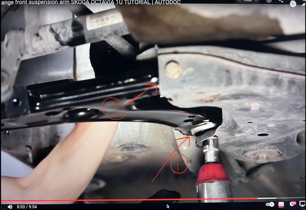

Folks I managed to resolve the issue. I guess I was spraying the WD40 silicon spray on the wrong bush earlier. Did it this weekend on a different spot and now I do not get a single sound from the suspension. Darn I have no idea why I didn’t do this before!!
I’ll try and click a picture of the exact bush if I can with my phone to post here.
Edited by Grc
I just sprayed all of them! Lol.
Been quite a few months and still ok.
Fyi folks, I initially used the WD40 Silicon spray on the bush marked 2 but it didn't stop the squeaking. When I sprayed on the Bush marked 1 on both sides the noise disappeared. It's couple of days now and I drove a lot over the weekend too and there's been absolutely no noise or sound again. Hopefully this lasts a couple of months.
