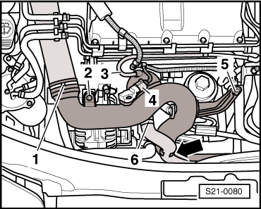

Doing a thermostat on an auq 1.8t is not too bad a job if you possess a 1/4 drive socket set and a good 1/4 drive wobble bar set. With those, you can get under the alternator in situ and remove the stat without too much grief, without them it is much more difficult.
Thanks fellas. I'm going to do it this weekend; looked at loads of info online and it's not too bad. Remove the coolant pipe and that should be a struggle, but the 2 bolts can be accessed. Oh yeah-remove the big bolt on the alternator which is in the way. Just hope I don't drop bits into some dark recess (highly likely). I thought the throttle body(?) would have to be shifted, but no. Many thanks all
Having done this job quite a few times, you shouldn't need to touch anything on the alternator as the wobble bar can get around the body of the unit. A quality hex head (6 sided) rather than star type (12 sided) 1/4 drive socket will see the job done, you just need to get the plastic shroud around the dipstick swung out of the way.
The hose is easiest if you crack it loose to move after loosening the clip, then leave it on until the bolts are free which will allow you more room to pull the housing free from the hose. If you intend to use 1/2 inch drive tools, it will be a struggle,

I think I understand - you mean loosening all the fixings for the hose which joins to the thermostat housing? Then leave it on cos  then you'll have something to pull on to get it out, The diagram I looked at suggests about 3 bolts which fix that fat hose to the other parts
i know, I shouldn't have used that image I'll be in the **** with someone
...but it's the way I intend to go for it
Although that's a MK2 engine

Only really posted this for pictures really, as the job can all be done from above, just spray the thermostat housing bolts with wd40 about an hour before you want to do the job, makes life easier in the long run.
Also, mk1 and mk2 engines are nothing like each other, so that is only going to confuse you looking at pictures of a mk2.

Thank you. Yeah-wrong diagram. Got it done over the weekend and cleaned the throttle valve thing too (which was clean so needn't have bothered). I got a mate to help. who knows cars inside out- and he managed the break the alternator tensioner as he was moving it. I kept cool, and managed to pick one up on a sunday for £55 which meant no money for him! Anyway, all good now, it was good to get a good look underneath, etc... no leaks or obviously worn parts. So I'm more likely to get a remap done now I know it's not in a shoddy state... cos a remap is pointless if there are leaks and clogged-up parts everywhere
