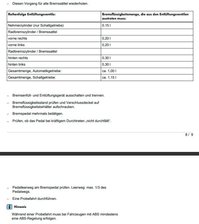

Hello Everyone,
I am about to change a brake liquid on my Octavia and I have a Maintenance manual from 12.2014, which describes the process in details. But before going forward i decided to invest €7 and get up-to-date workshop procedures from Skoda.
The reason for doubts was a video on Youtube, where the official workshop by the dealer said that the sequence is changed, This video is in Russian and therefore I give no link.
I have chosen German language for documents as I wanted to avoid wrong translations.
I was surprised to see a big difference to 12.2014 in a bleeding sequence.
2014:
1. Slave cylinder (clutch)
2. Rear right
3. Rear left
4. Front right
5. Front left
Actual:
2. Front right
3. Front left
4. Rear right
5. Rear left
As for the test drive, the actual German version says "Während einer Probefahrt muss bei Fahrzeugen mit ABS mindestens eine ABS-Regelung erfolgen", which means exactly what is in English version. No adjustment, Just extreme braking on gravy or slippery surface.
I have attached screenshots of both sequences for reference.
