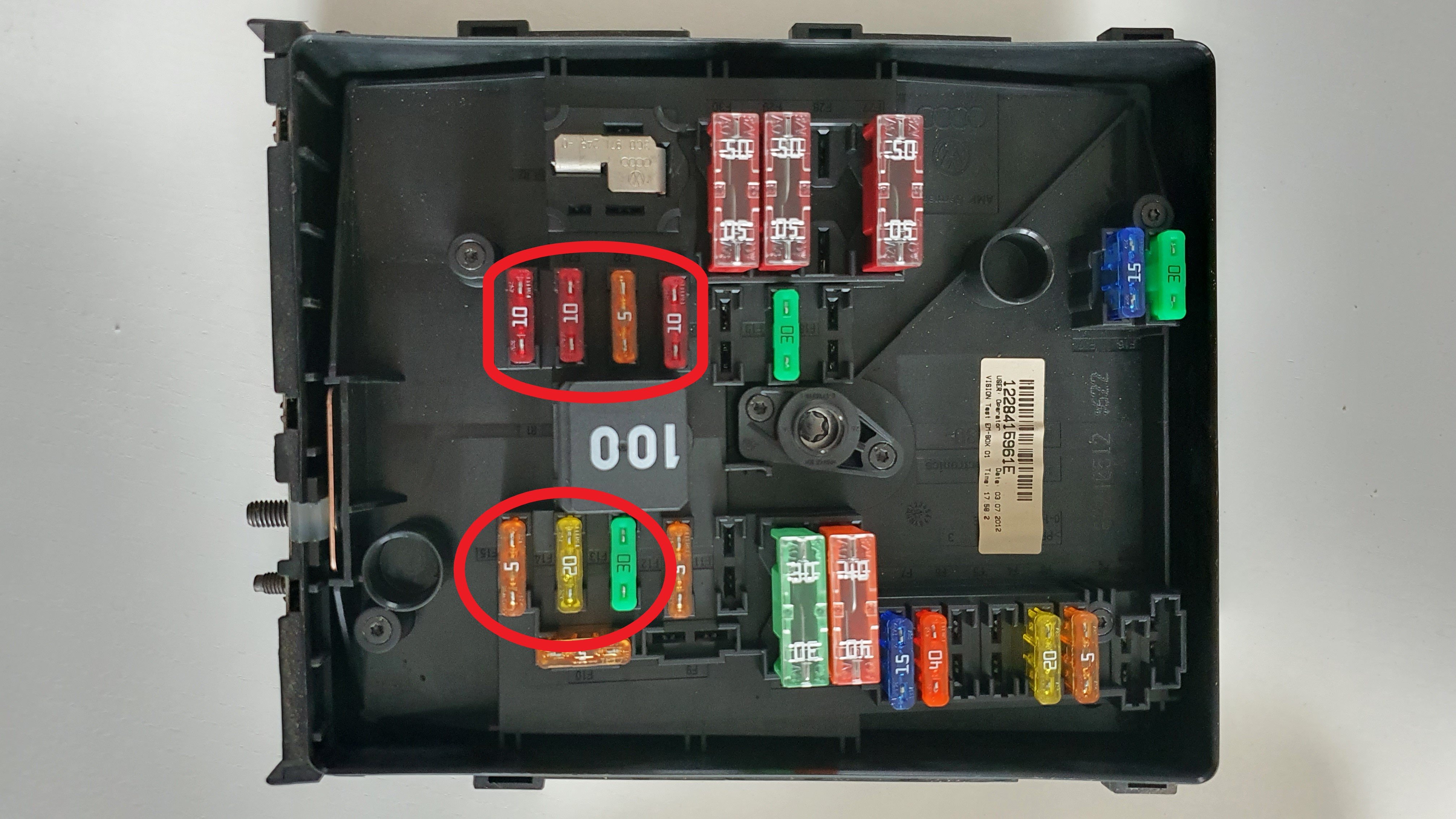

I have also noticed that that some of the fuses in E-box in engine bay have no power while ignition is on.

After couple of weeks trying to figure out what is happening I have decided to get in touch with local car electrician. On his arrival he found broken wire from engine bay fuse box that leads to ECU.
Broken wire was caused by battery tray chafing on the wire loom.
