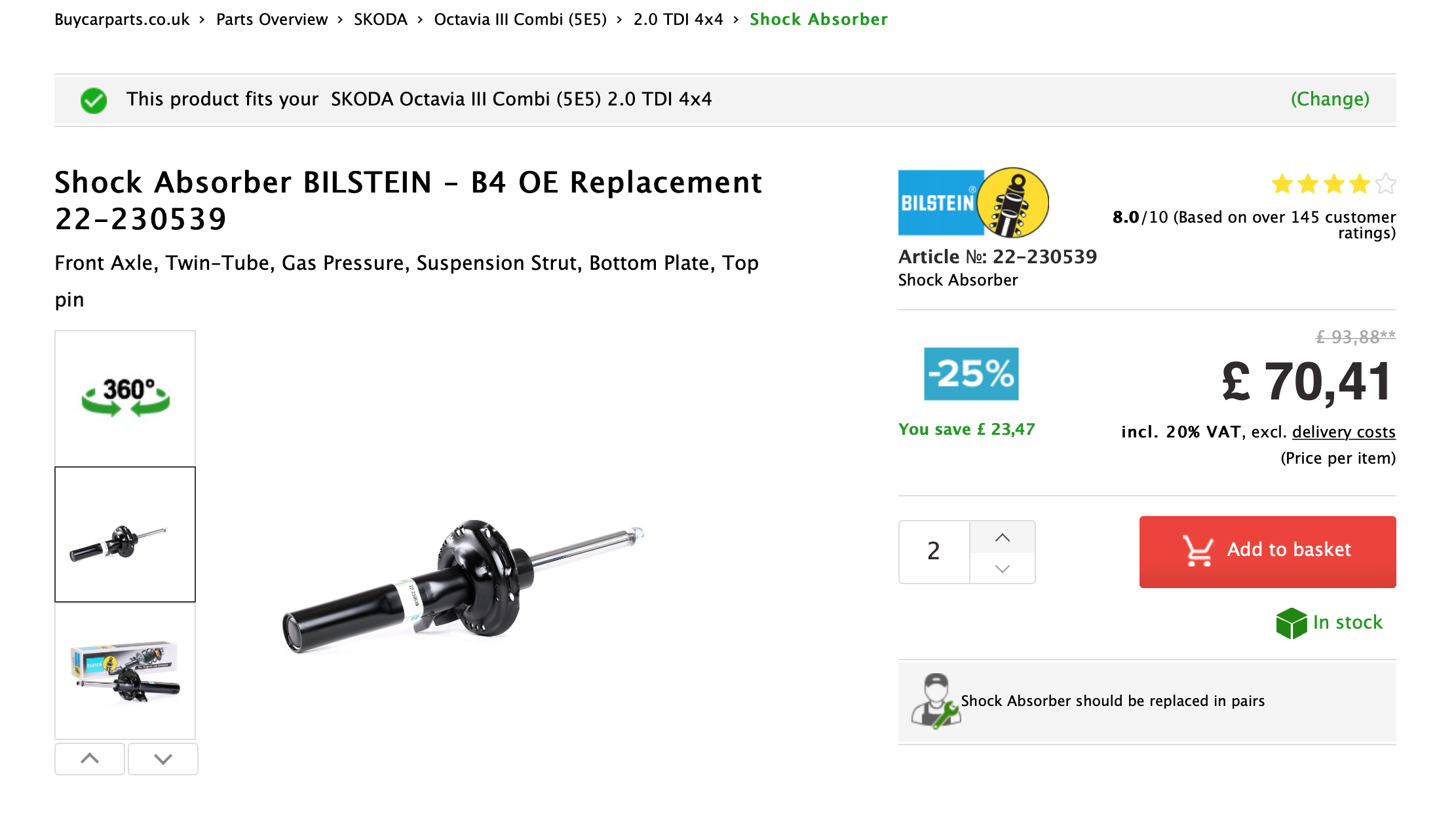

amazing thank you - that's really helpful.  Is this part correct (see link or attached frame grab) https://www.buycarparts.co.uk/bilstein/7620083
1435547466_Screenshot2022-10-18at08_07_57.thumb.png.67ef4898ea5ae174c397b00f130cf795.png
They are the same ones I fitted to my VRS with the 55mm strut diameter. I believe the scout uses the same strut diametet so will fit fine.
great - thanks again for help
