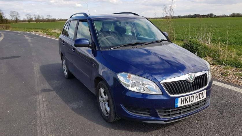

About a year ago, I was looking for my first car and I found this:
A Skoda Fabia estate, 1.4L TDI, not too bad for a first car. So I called up the dealer to get a reservation after months of searching for a car and finally have my first car. Anyways, the dealer later rang up and said his wife already sold it.
So I got this instead: Another Skoda Fabia estate, same colour even, but with an extra cylinder, 1.6L and 105 horses. But I did loose my climate control and fog lamps :(

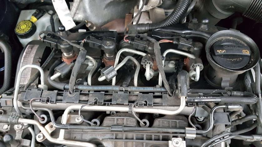

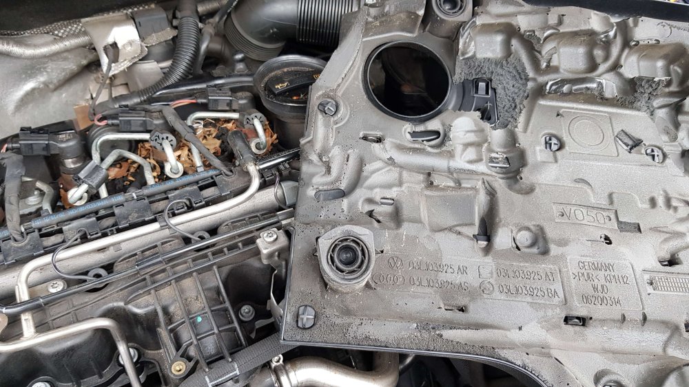

Vacuum up the birds nest that was hiding in my engine

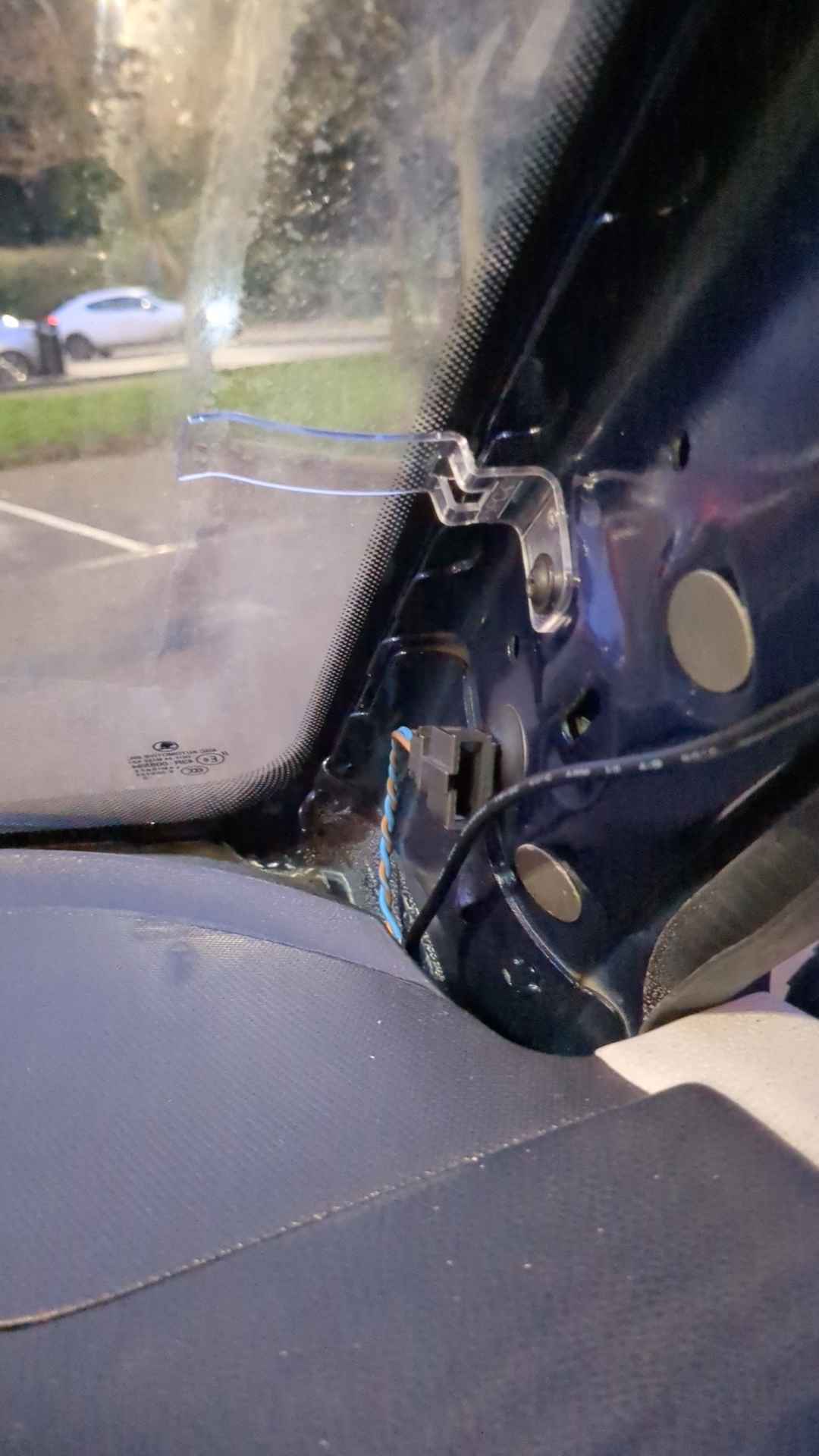

Hardwire install of my dashcam, I wont admit how many times that flatten my battery.

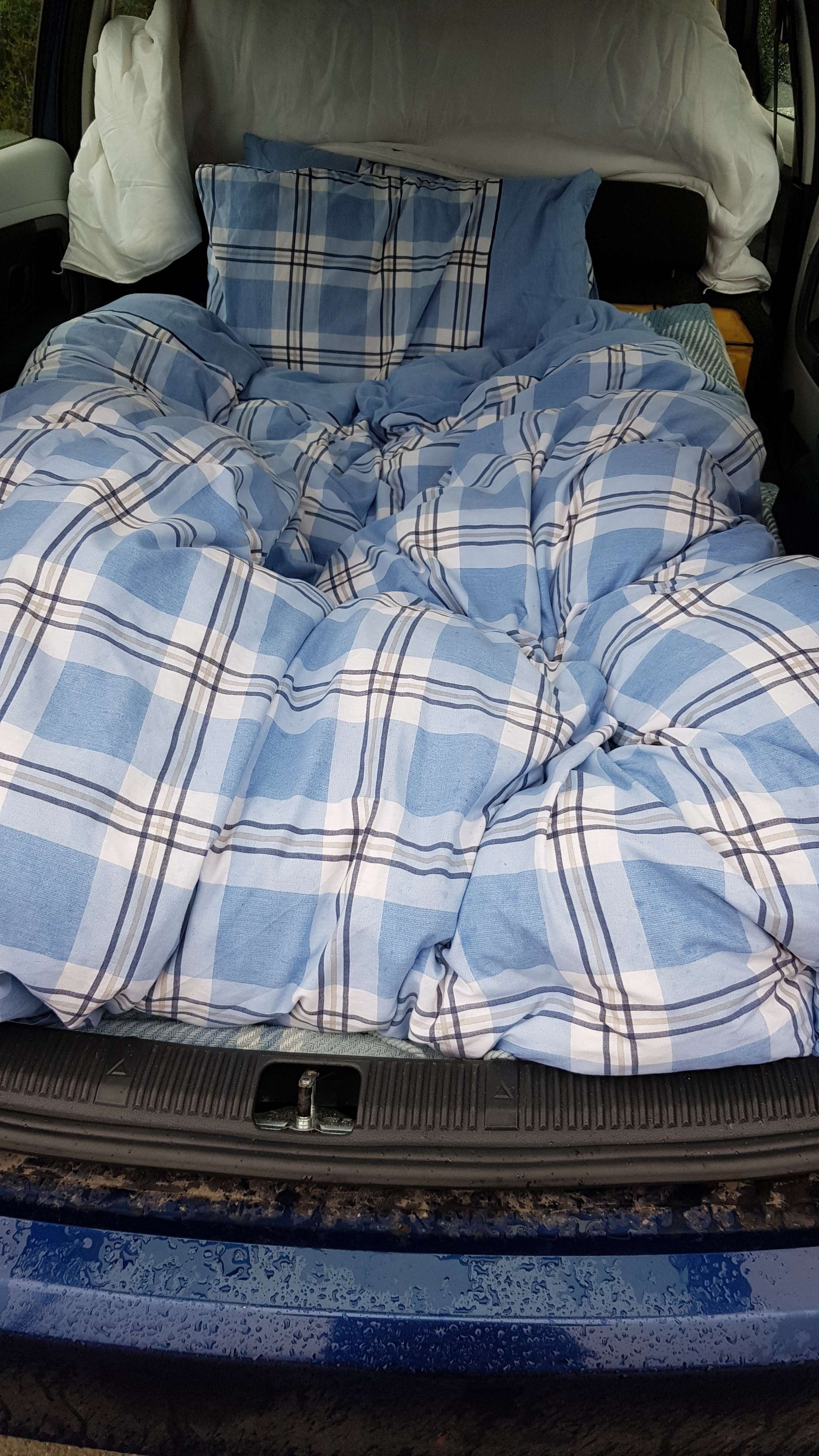

And turn it into a camper to prove that estates are the superior automotive.

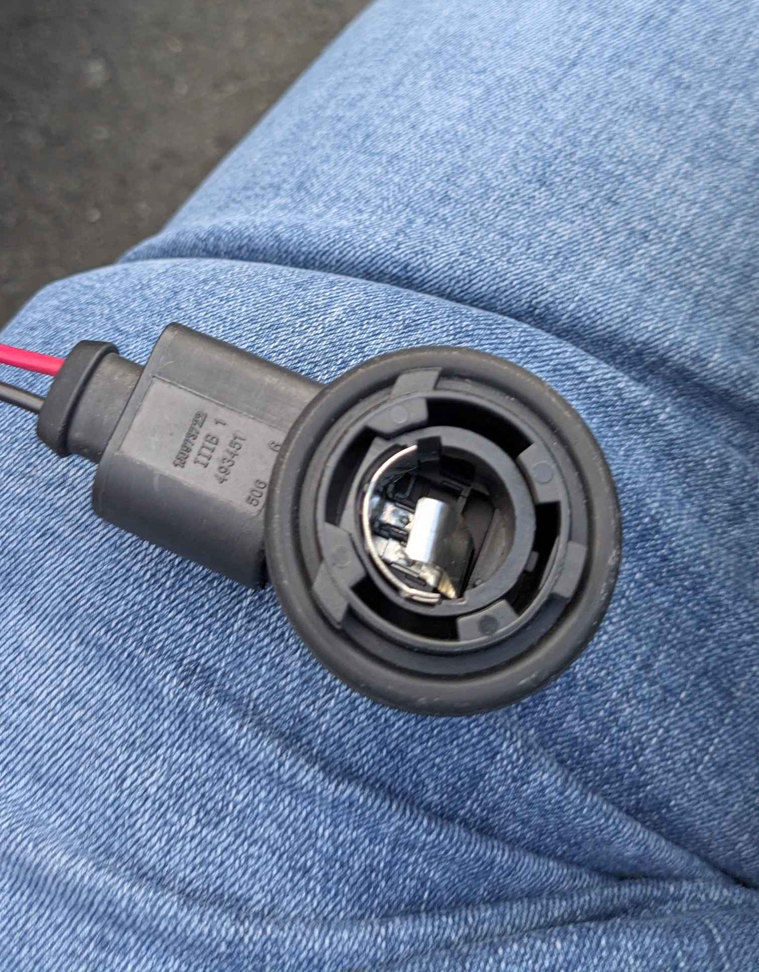

Now the most dramatic thing to occur: A bulb had blown.
Having a close look, it was the sidelight that blew, so just a simple pull in and out

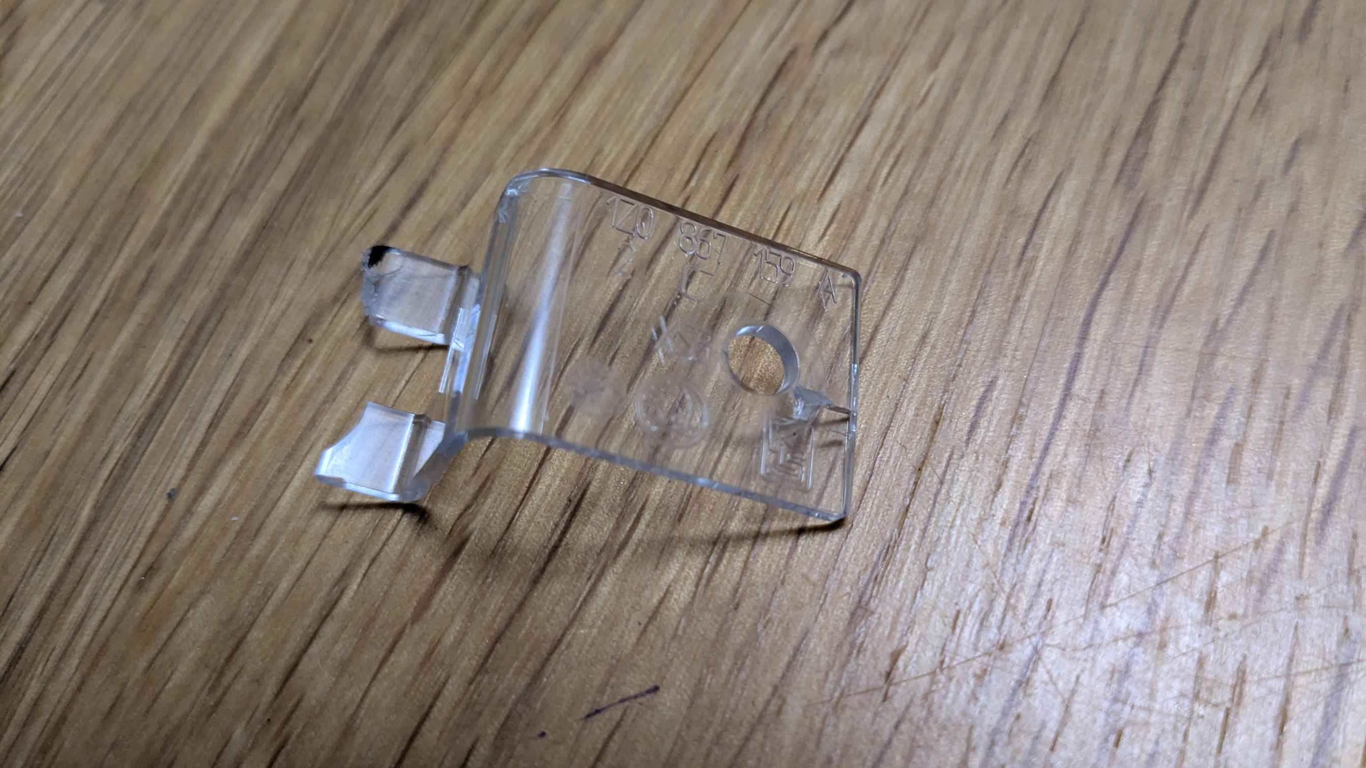

BUT THEN, IT GOT WORSE! A weather cap fell off. So I bought a new one, just a fiver for one off a ford.

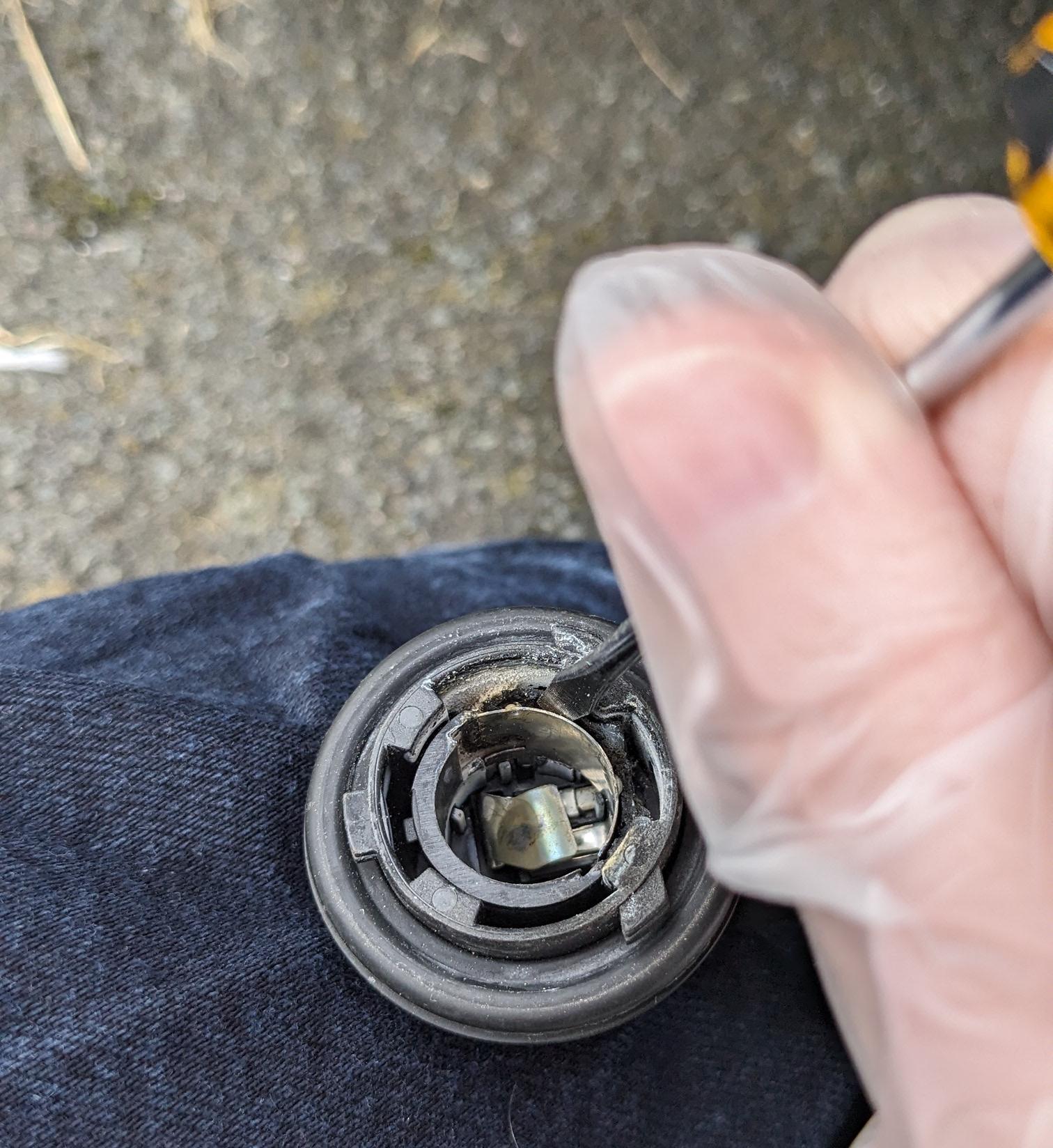

But this one has a bulb trapped inside, I think I'll just have to cut it out somehow (Anyways, how the hell did someone get that in there in the first place?)

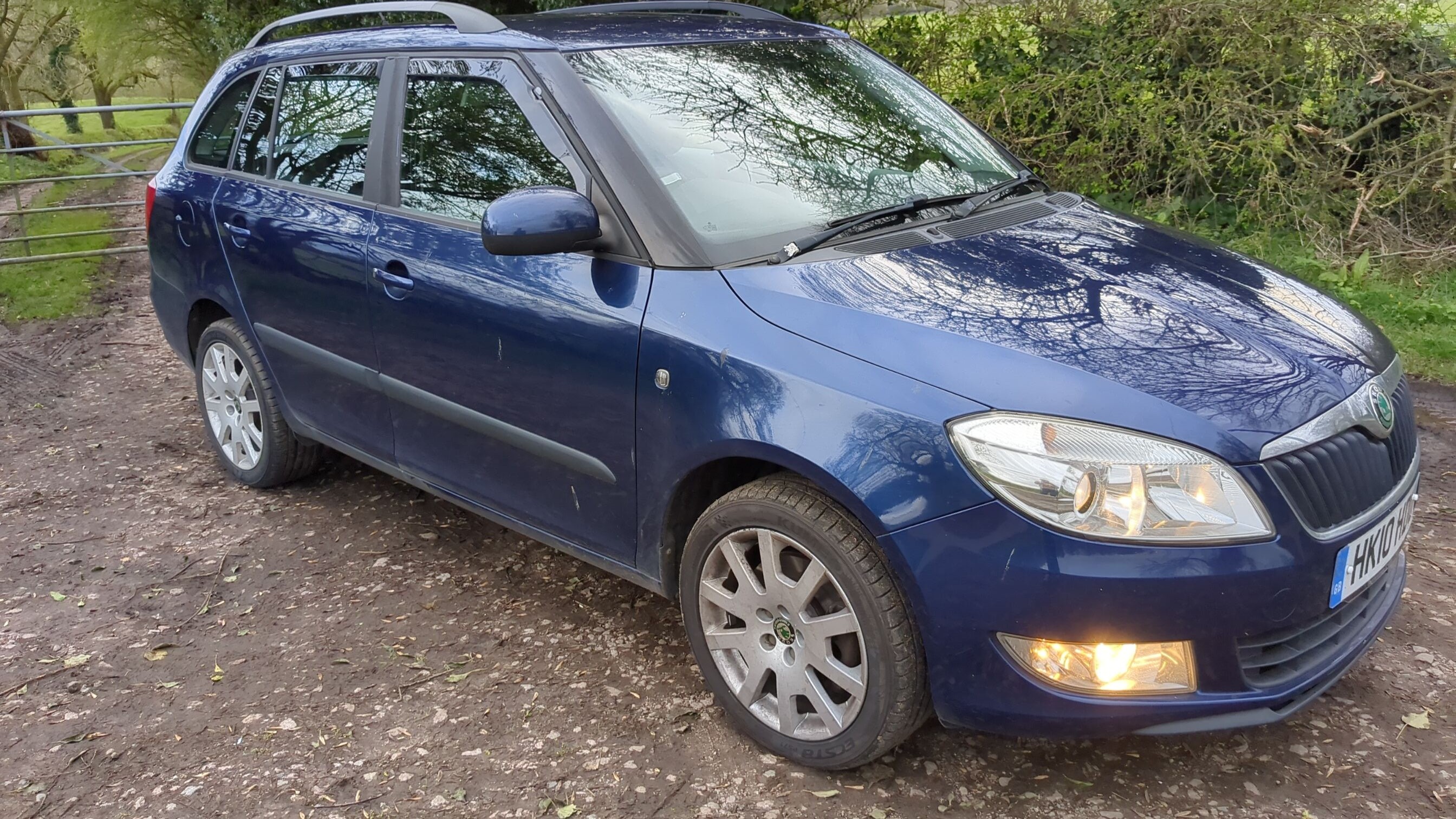

I have finally gotten around to installing my fog lamps
20230220_205126.jpg?width=721&height=406
Bulbs are just for show for now, hopefully I can get them fully working soon!

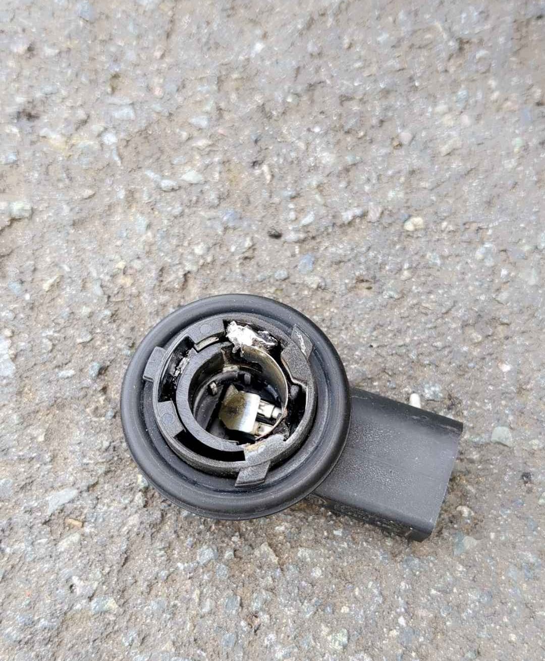

On the other hand, in trying to free the trapped bulb, now a piece of the cluster has snapped off, and I’ve lost it so I cant glue it back on. I have given a test drive and ragged around a little and the bulb hasn’t fallen out so I’ll just pretend everything’s fine. Perhaps put some blutack in if it somehow slips out.

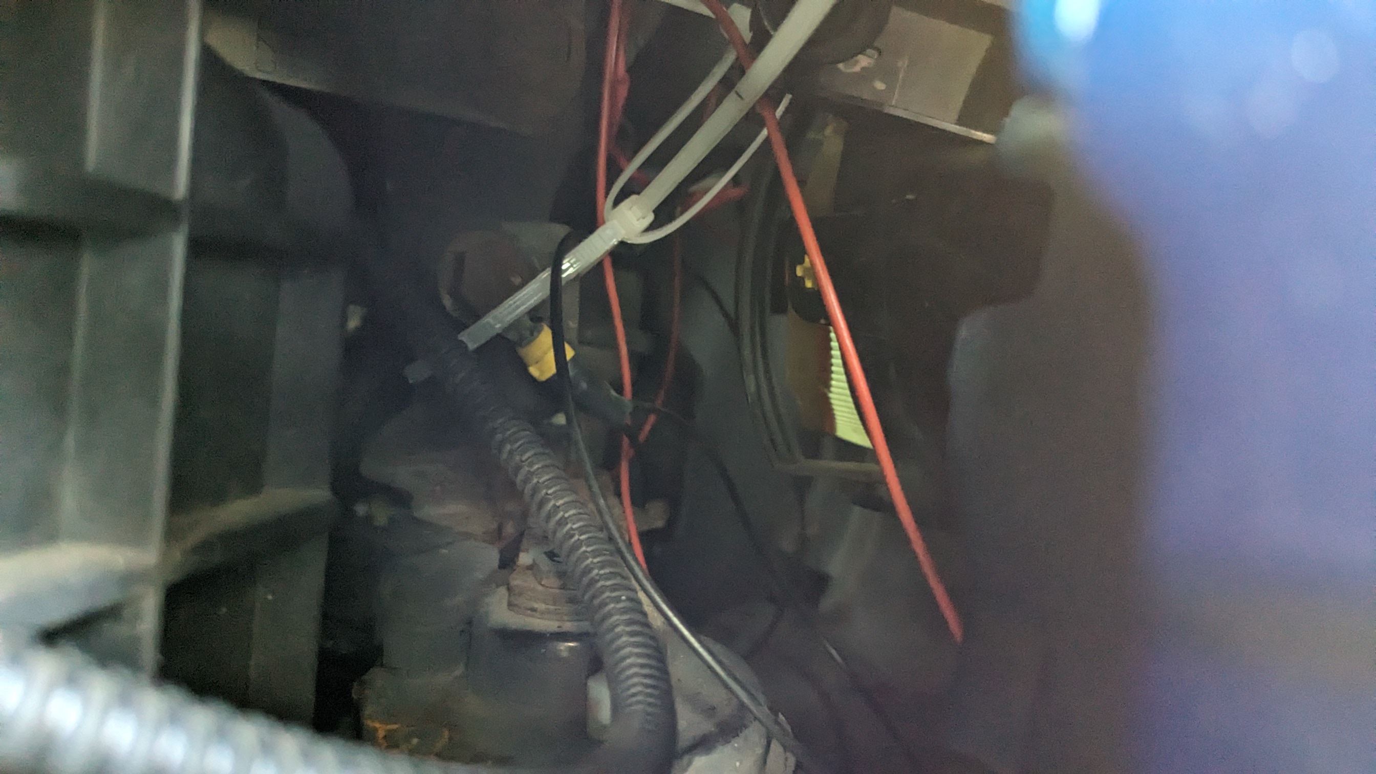

While I didn’t bother pre-emptively marking what was fogs or daytime, I decided to tap the cable off the battery and saw what light came on. Don't worry about the sparking, the sparks fear you more than you fear them.
Next challenge up was to feed the wires into the interior, first thing is to get under the scuttle. Which means getting off the wipers, which they really, really didn’t want to. As a rough estimation of the force required, this is what I had to do.
If you are particularly precious about your bonnet, I recommend to have someone else holding your wipers before they blast off with a bang. Also spare pair of underwear for the faint of heart
image.png?width=538&height=452
Once the scuttle panel is removed, I threaded the cables through the bonnet release grommet using a copper wire (same one I used to remove the blanks in fact)
Now that the tip of the wire got through, then it was just simply pull the rest of the 8 meter long wire through. Arm length at time.
Once again through the bonnet cable grommet into the interior, but since this time the copper wire was going in the same way I was moving the wires in, I made a double hook, one end to punch through the grommet, one to pull the wires through. Once it got through, I put a camera up the passenger foot well and looked out for the copper wire, then pulled it the rest of the way. And then repeat pulling the entirety of the 8 meter cable through, but now worrying if I caught it on anything that I can’t see, as if it wasn't enthralling enough.
Now two points: This does technically leave a (tiny) air gap between the two grommets from the engine to the cabin, however its miniscule considering there is a massive hole for the heater running right next this, and I have not noticed anything when driving around. Also there was another unused grommet not far from the wires, however I couldn’t find where it lead to so I just used the bonnet latch grommet again (Pic below without the grommet)
image.png?width=863&height=452
Once the wire is through, I just stuck it to the bottom of the glove box, fed it through the center by pulling out the radio out, put the cable underneath and fed it to the fuse box

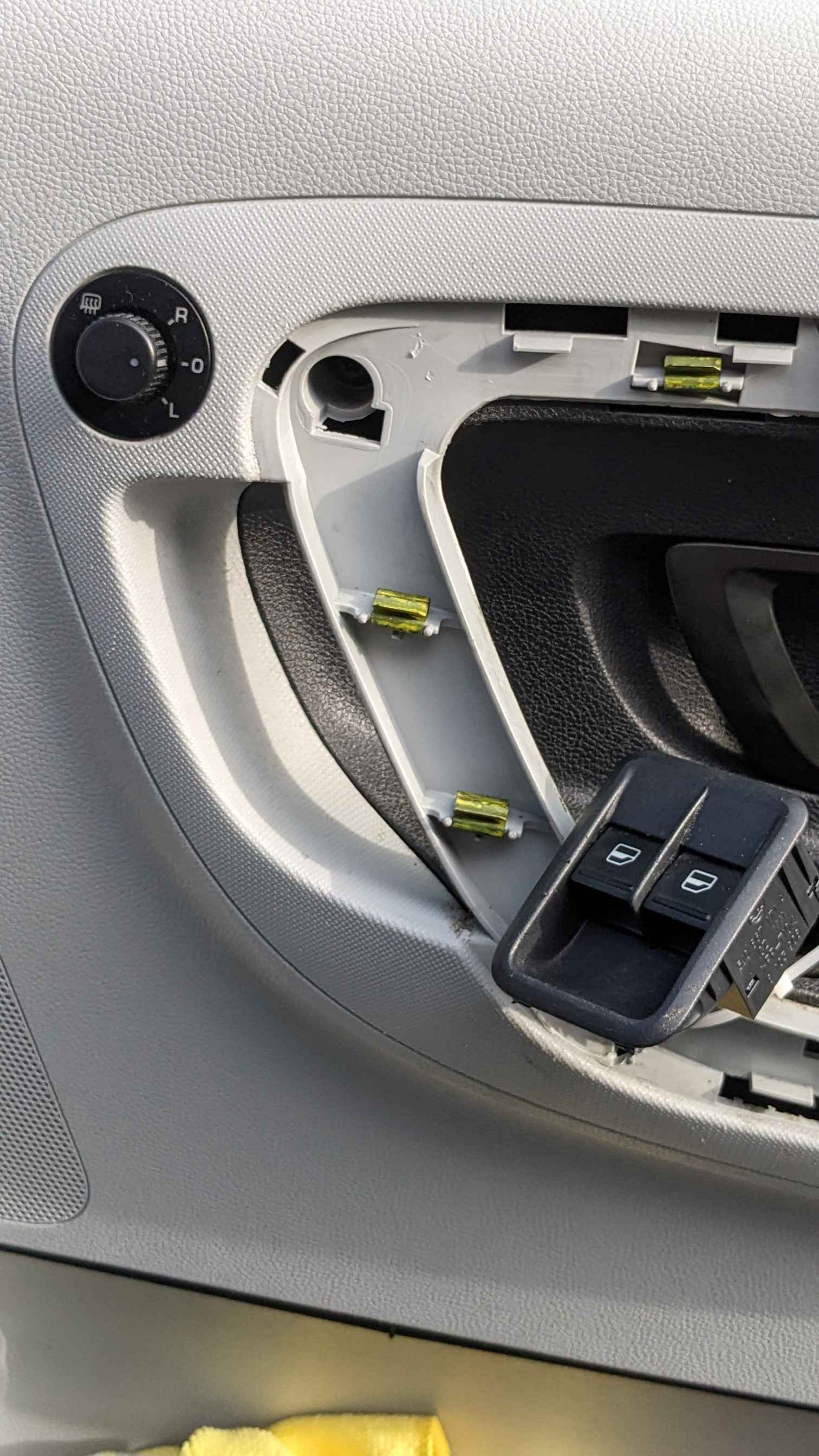

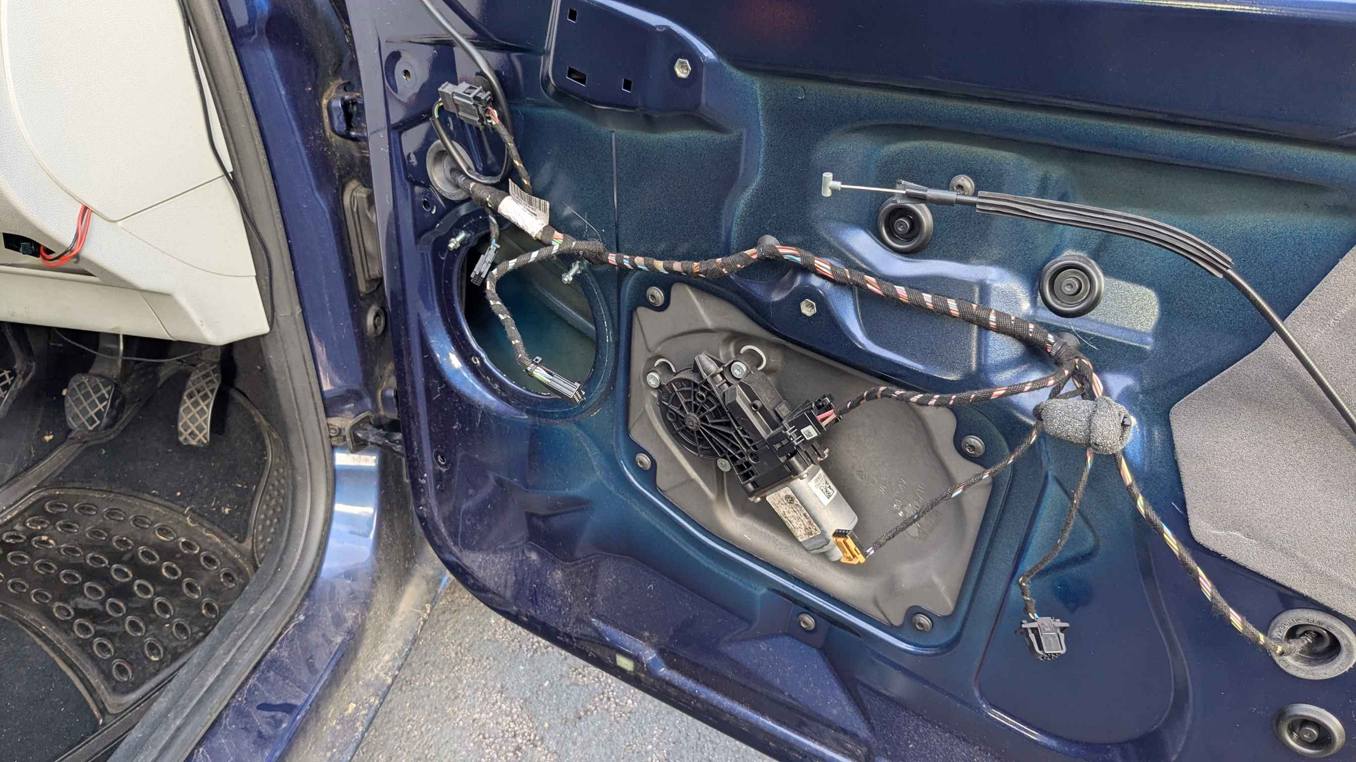

First thing to go after: the hole in my door
Since I first bought this car, it always had a hole where the mirror control blank belonged, and for the longest time I struggled trying to find a replacement part, all scrappers sold the entire door frame along with and the only spare parts store selling was selling it for 0.77c. With an import from Czech Republic for €15. This admittedly was a little bit off putting for a small hole in the door; however someone mentioned that it could just simply of fell into the door, so decided to take a bet and have a look.
Apologies for lack of photos, pretty difficult to do while holding a door card.
https://media.discordapp.net/attachments/823564638935056387/1109880628285022238/20230507_140547.jpg?width=625&height=469
It turned out that blank was just lying within the door all along, and luckily no tabs cracked in the process. The tab itself was somehow undamaged too, just needed a little scrub and slotted back in.
I will mention I didn't hear a rattle or anything else that indicated that the blank was in there.
https://media.discordapp.net/attachments/823564638935056387/1109880628587020428/20230507_143928.jpg?width=625&height=469
Quite nice to have the interior complete for once.

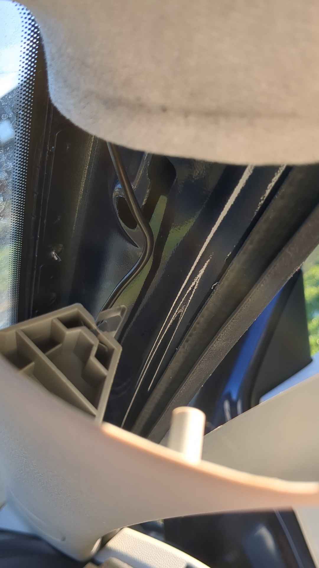

While I still have mcguffin removers, decided to take a go at the sunglasses retrofit
https://media.discordapp.net/attachments/823564638935056387/1109880562015015052/20230511_193512.jpg?width=625&height=469
Small piece of advice for anyone wanting to do the same, rather than just poking for the tabs from outside and pulling down, I found it much more easier to remove the inside lights, reach in and push on a tab, while simultaneously pulling down.

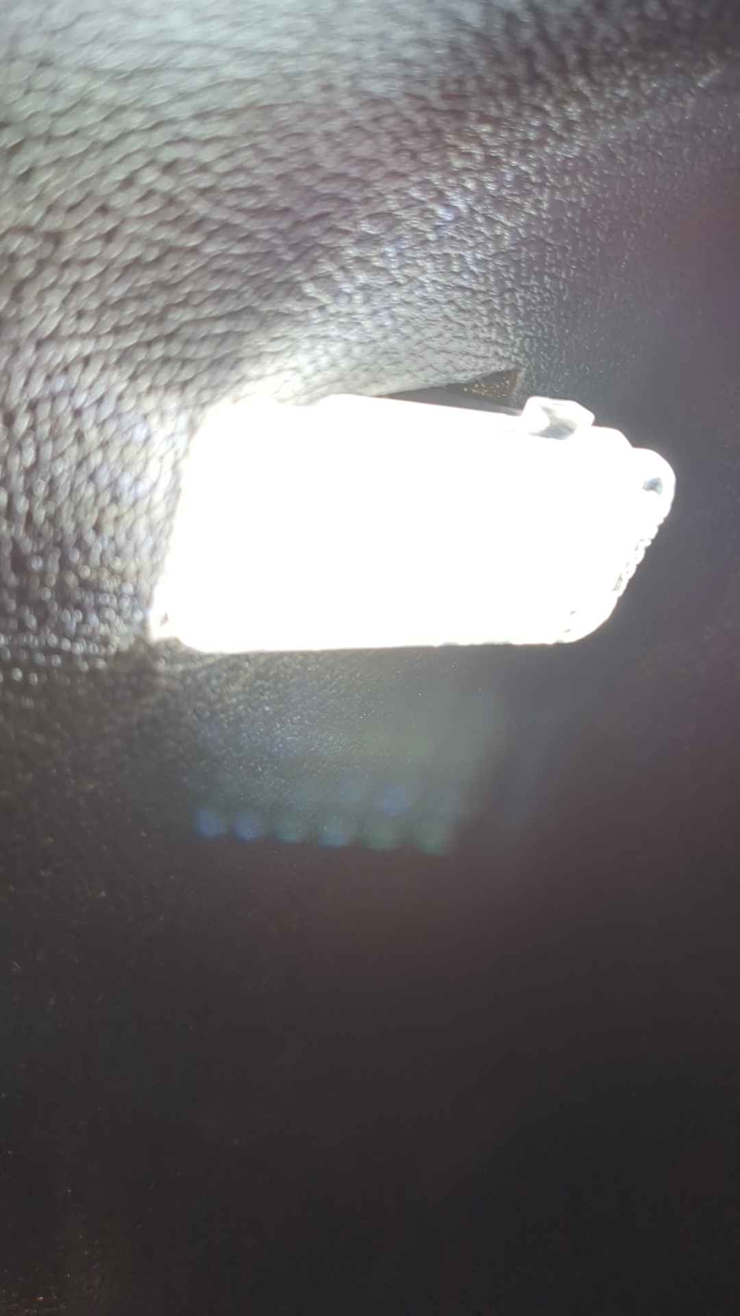

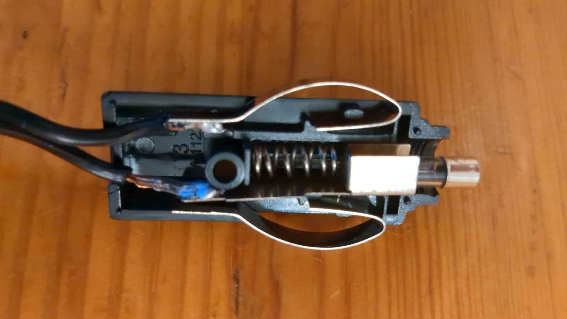

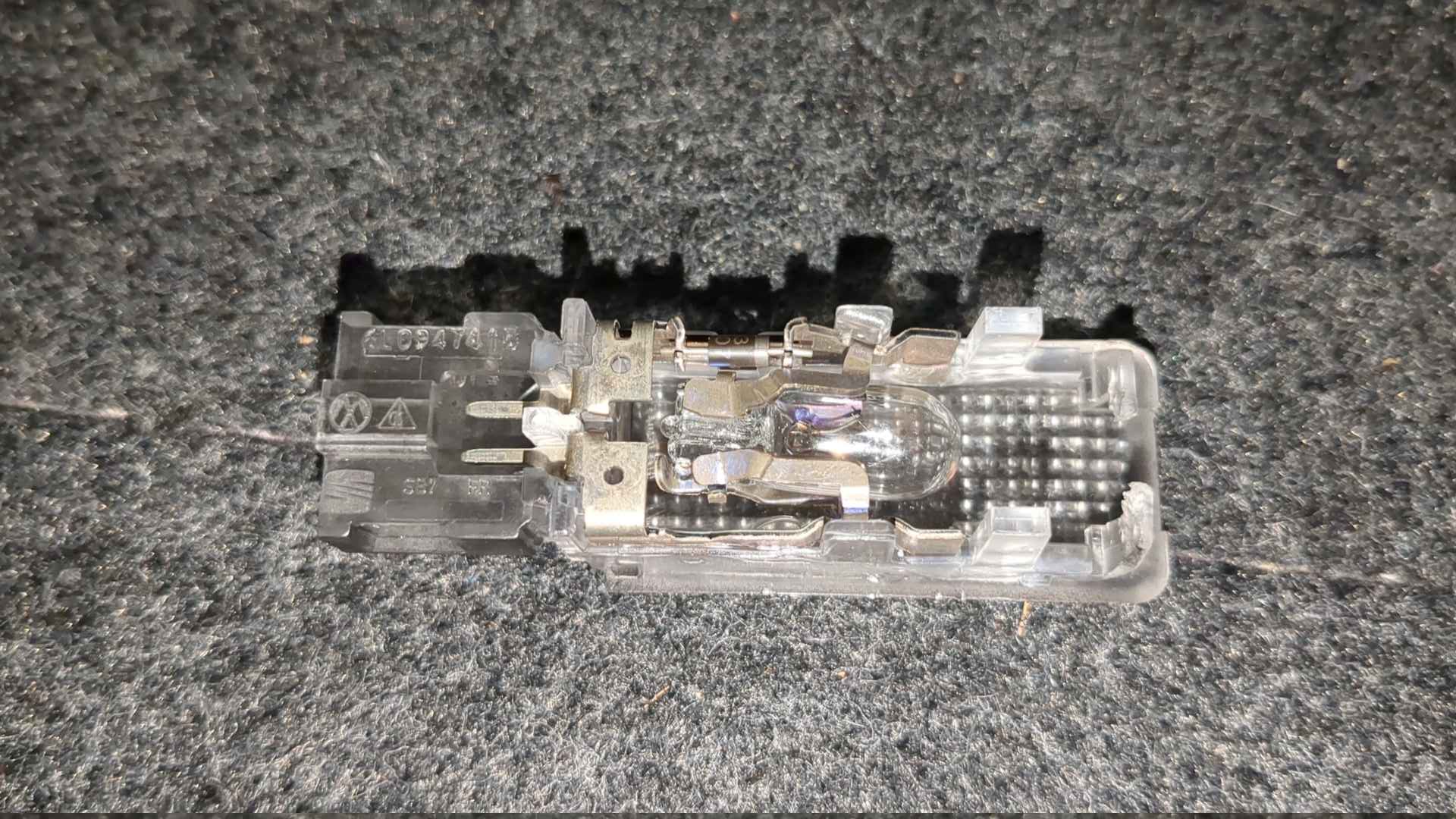

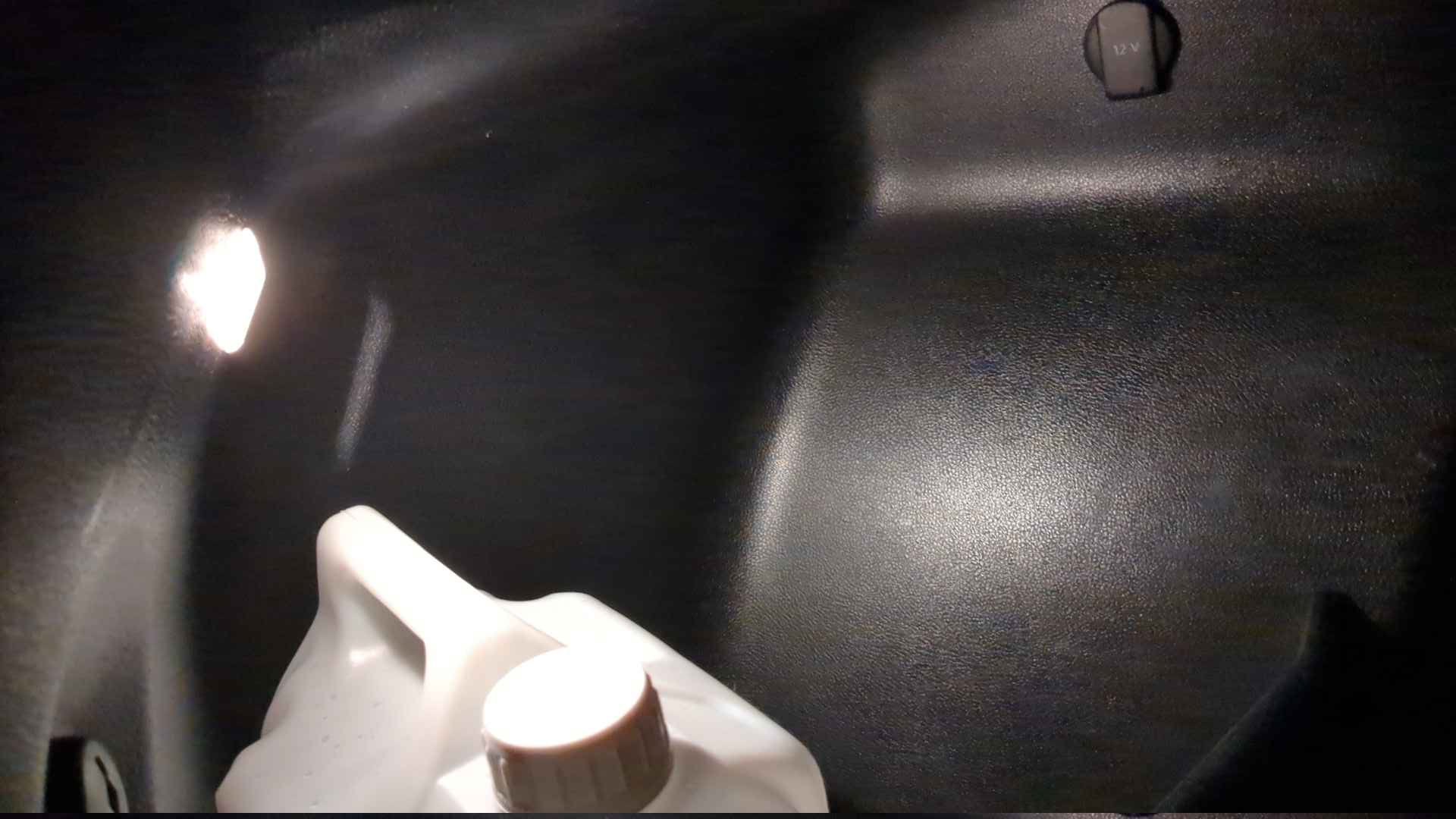

Also gave a shot at trying to solve my boot open light problem too by fiddling around with the boot latch
https://media.discordapp.net/attachments/823564638935056387/1109880478183477299/20230516_174550.jpg?width=625&height=469
I took it out, couldn’t replicate the issue, shoved it full of WD40 and contact cleaner for good measure, saw the light work fine so I have no clue what happened, but now it works so I wont question it.

I got a VCDS cable
Spoiler
image.png?ex=660ee991&is=65fc7491&hm=8ab
First thing I did was check if I could add needle sweep, unfortunately my cluster lacks that. Perhaps I should hunt for a maxidot some day.
But I did manage to figure out which injector was making my engine run funny

Finally I’ve been facing DRL issues for a bit where one bulb randomly went out time to time. It turned out the bulb was held in loose and the potholes I’ve driven over managed to wriggle it off the contacts.
Screwdriver to tension the contacts solved the issue. More importantly it meant I did not have to admit to a fault of my own wiring and my pride remains intact.
Also the fog light cluster retention clip snapped somehow. So the cluster held in with zip ties for the time being.
