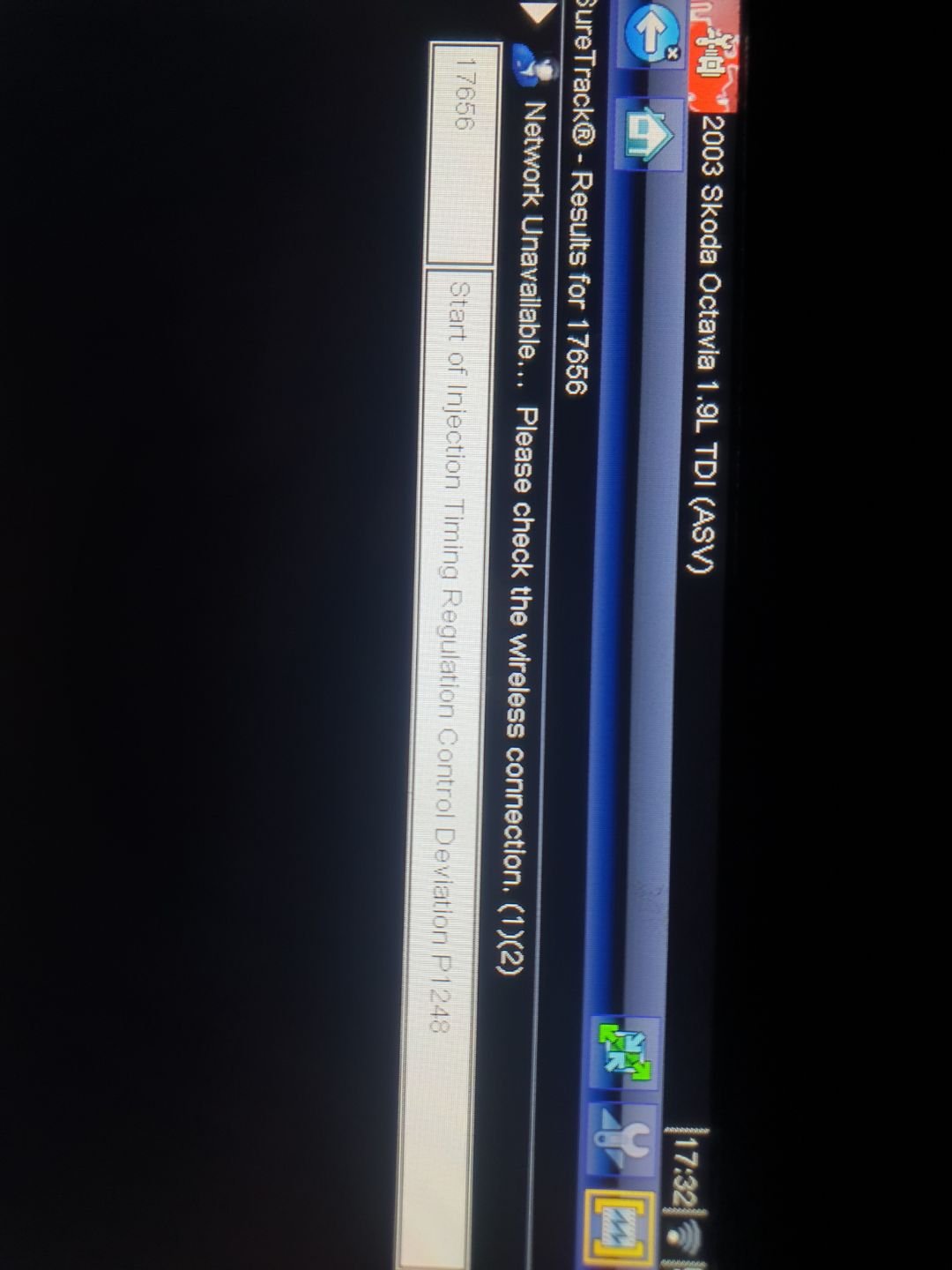

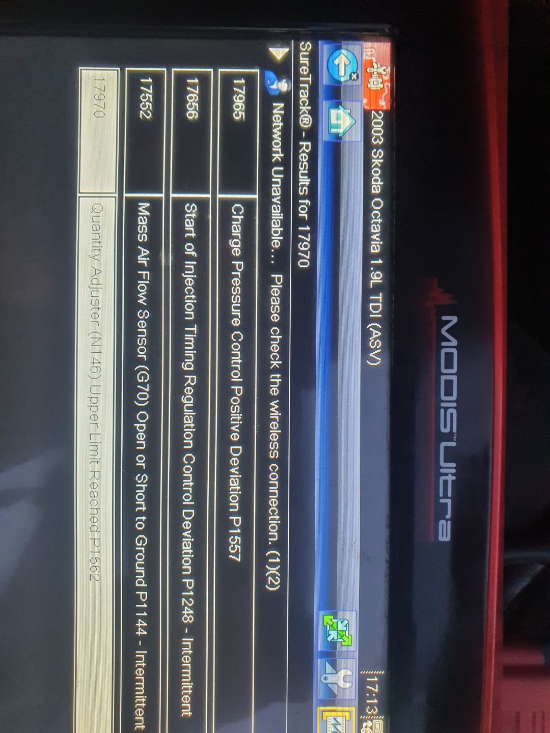

When driving the car goes into some sort of limp mode where it doesn't go over 2k and is down on power and stalls when it's pushed over 2k for a longer period of time, the traction light goes on when ever limp mode activates. I've taken it to my mates garage and had it scanned it came up with several codes but after clearing it, this error came up again after 2 minutes of driving "Start of Injection Timing Regulation Control Deviation P1248" my mate and his colleagues reckon it's just a case of me putting a bad batch of wvo or making it too thick and it has clogged the injection pump. I've ordered a new pump but I have a slight feeling it won't help. Any ideas? Because I've been sitting on it for a week.
I have put the images of the scan (I've replaced the MAF) Snapchat-664035785.thumb.jpg.0670df42d6a3db997814368d5da10e04.jpgSnapchat-1217795192.thumb.jpg.6af171ef6a97fecaef40b1573d74a85f.jpg

This might give you some things to check - http://wiki.ross-tech.com/wiki/index.php/17656/P1248/004680
What software did you mate use to scan the system, was it VCDS?.
Edit, ignore the last comment, could not see your pictures at first, but can now.

From a while ago - variable vane issue? however make sure all pipes (turbo/ vacuum etc) are ok first.
