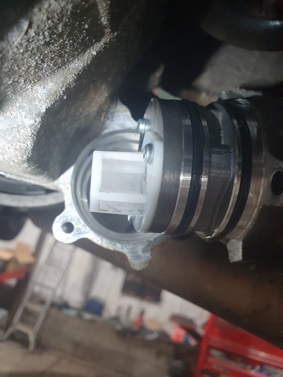

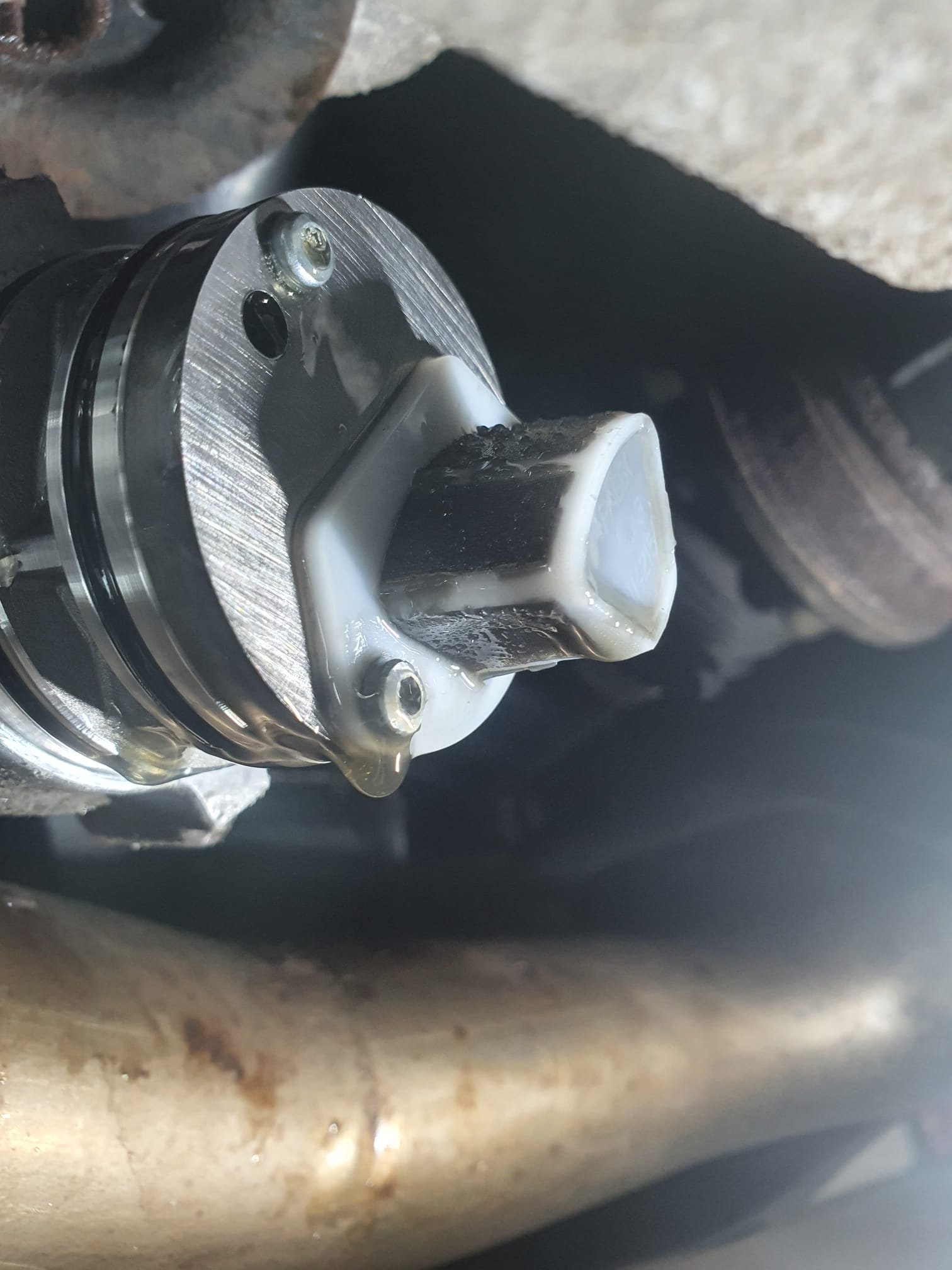

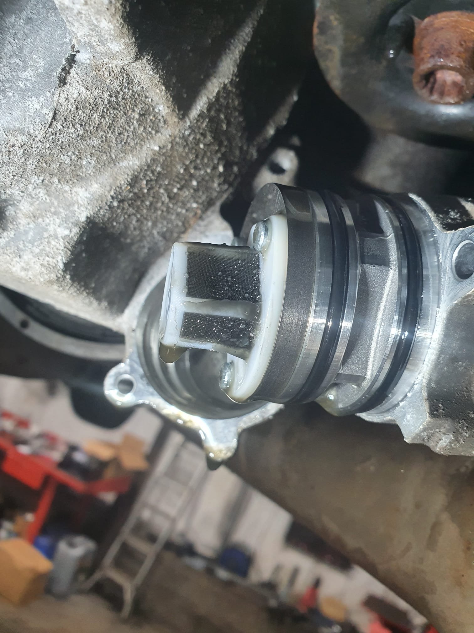

I saw some pics recently of the Haldex mesh strainer from a Karoq that was badly clogged at 20k miles.  On the basis of that, I had Haldex oil changed and the strainer cleaned in our Karoq at 20k miles by our local independent VAG specialist.
Two before and one after pic attached.  The guy who did the job said he'd seen worse.
Whatever you do, make sure that the Haldex pump is removed and the strainer is cleaned.   That service procedure is not included on any VAG dealership service schedule.

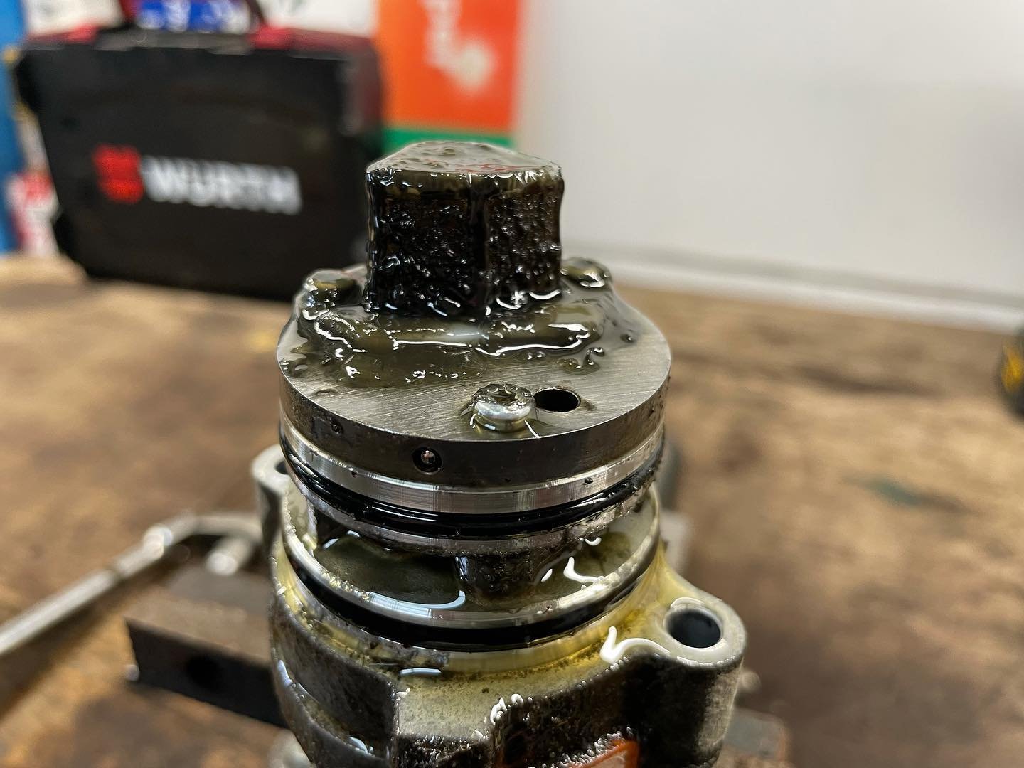

This is the pic that prompted me to have ours done at 20k.  It was posted on the Skoda Karoq Owners UK page on Facebook by a garage in Galashiels.
