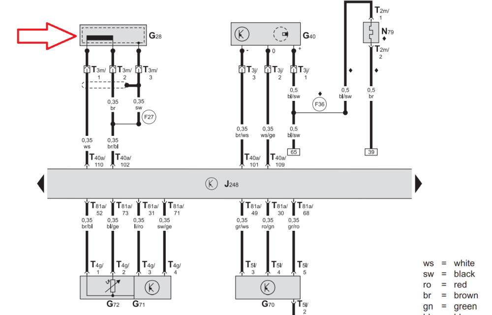

I did suggest you inspect the wiring when this first came up about 3 threads of yours ago, but I didn't give you the full info then, so here you go now. G28 is the crank sensor, J248 is the engine ECU, F27 is a joint within the loom where the cable screen joins onto the earthy side of the wiring (pin 2 at sensor connector, pin 102 at ECU).
Thanks pete I appreciate the info, I'll be having a look hopefully as soon as possible. Without the wiring documents I wouldn't know were to start, so thank you for that

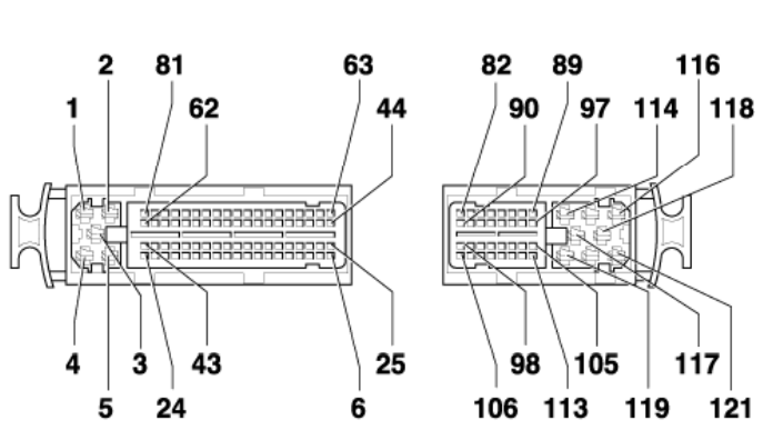

pin 102 at ECU
Just a quick question on this, does the ECU have markings to indicate pin numbers, even if it's a starting row number or something. If not, do you have a pinout diagram that has the pins and their respective numbers? Cheers :)
  • Sponsor
Row ends are generally marked on loom connectors I think; this may help, probably mating face view of loom connectors.
You will almost certainly find you need a fine piece of wire to poke into the relevant receptacles, as the pins tend to be mostly tiny, much smaller than meter probes.
Yeah I did notice I would need some form of adapting device lol. So, I resistance checked the wires to the ecu including the screen between 2 & 3 and all return around 1.2 ohms and no OL. So that would indicate they are okay by testing if I'm correct? But I may try have a visual inspection if I can just to double check.
  • Sponsor
Sounds OK, yeah, as long as 1 isn't shorting to 2.
I'll have to check between 1&2 however I managed to get the ecu scanned on Delphi and it's displaying crankshaft sensor no signal permanent fault. I did probe the sensor while it was connected to see what voltage was present on the wires and I was getting approximately 2.7v on all 3 wires. Am I correct in thinking that the black wire is an earth so shouldn't be receiving voltage? Or at least one is an earth?
Took a quick look today and it appears that they aren't shorting. I'm not sure if perhaps I got unlucky with the sensor and got a faulty one?
