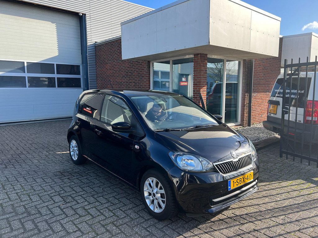

Two weeks ago my girlfriend purchased another car. It wasn’t economically responsible to drive a Golf TDI anymore, so she wanted a smaller car to save on everything.
Do we bought this little guy:
it is a 2013 Skoda Citigo 1.0 MPI 60bhp.
Weird spec with no front fogs, electric mirrors. But with seat heating, airconditioning and cruise control. But the lady is happy!

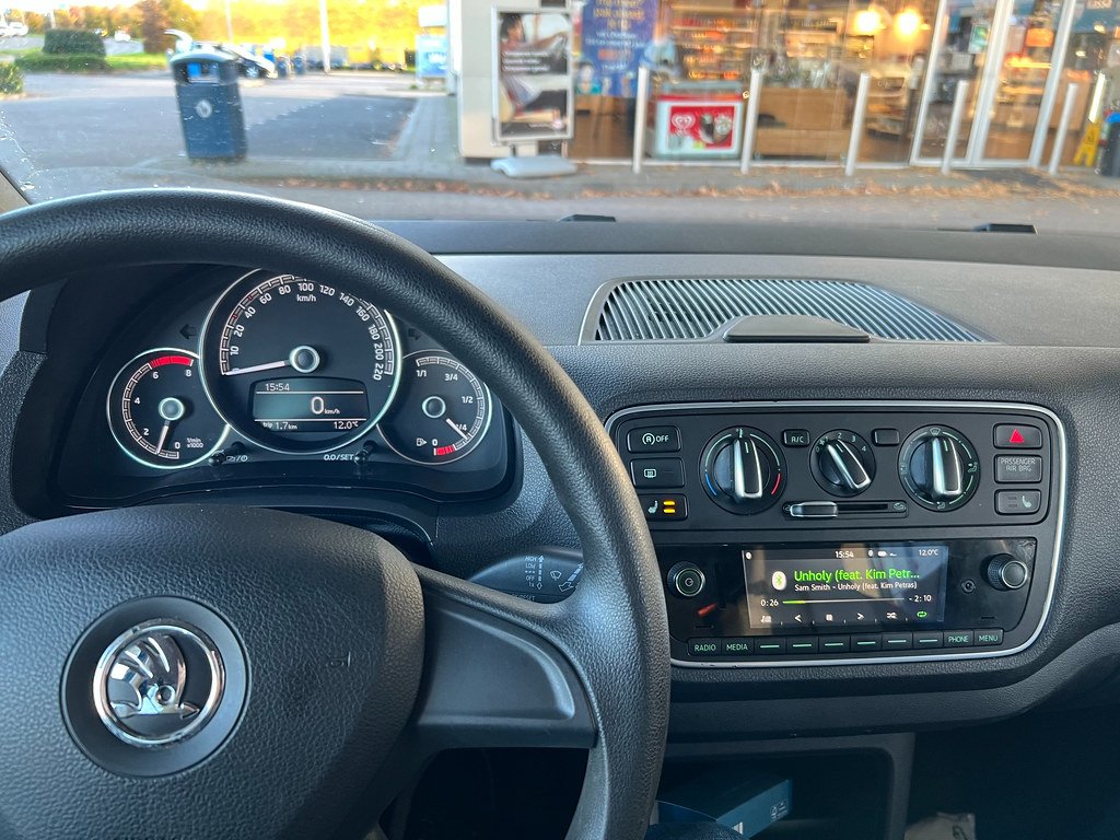

The first mods were installed yesterday:
- Facelift BCM (2017 - 1S0937090F)
- Facelift cluster/speedometer
- Facelift radio
This is the actual interior now:
All works! Component Protection is paired with the cluster, just like the original facelift Citigo’s got.

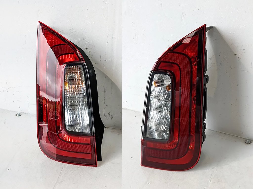

Next parts are on their way too, facelift taillights:

Facelift lights are installed, bought them from a UK based EV breaker.
