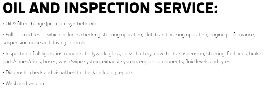

'Bodywork Inspection' part and parcel of 'Main Dealership Servicing',  That is VW Group Authorised / Franchised establishments,  Supposedly.
368071363_Screenshot2022-03-2511_55_58.jpg.edf9de7f74f6008ca469ca99fb9091d8.jpg.59c8e70155a4cf78e8950a1f2f6ef6be.jpg
