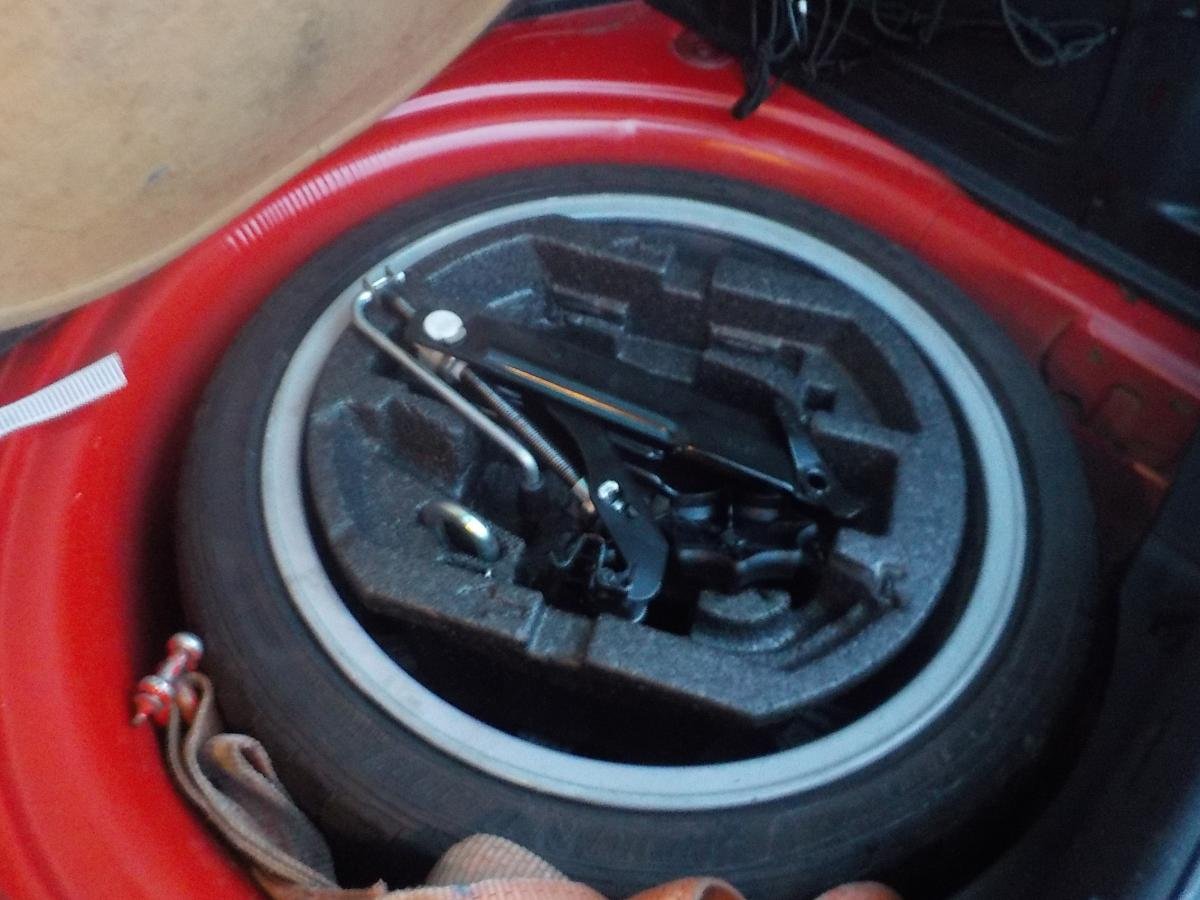

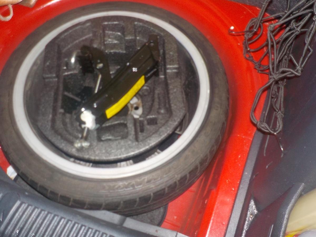

With Mk2 Fabia i would put in a matching 17" Wheel and tyre to those on the car and not care about the alloy's as i had so many that were replaced under warranties.
If i was going places during festive break periods there would be a pair in the boot of 'All Weather / winter tyres' not Summer / All Season summer bias.
Simply because you never know when the weather can change in a few miles from one region to the next let alone a week or so.
(Trolley jack as well, wheel brace etc. Also Snow Socks, that can help others maybe get moving and not blocking the road.)
Wheels and tyres secured in an not just chucked in obviously....post-86161-0-58645700-1451813005.jpg.3af130193383a637fd771f413e9558f8.jpg.c1458ac1b7b44617edda85e703c987f7.thumb.jpg.4cc58bee01fa2e1a8de20ee0a4b1b100.jpg
