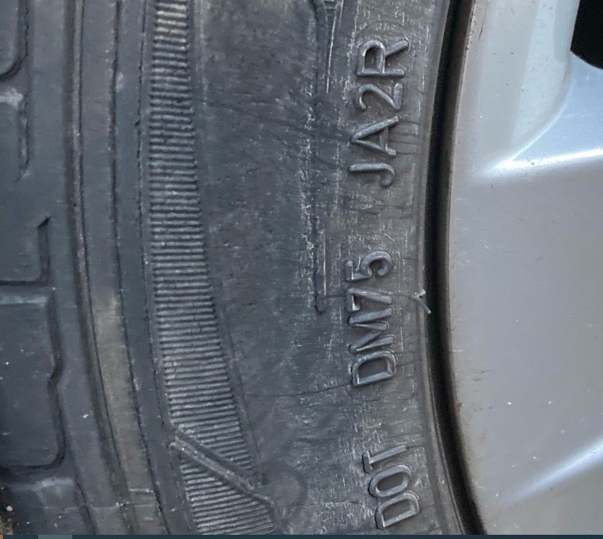

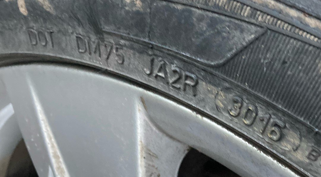

What is the DOT code of the rear ( Bridgestone? ) tyres?
Thanks. AG Falco

Weirdly the left hand side doesn't have a month/year indicator but the right hand side indicates week 30 of 2016 which is the same age as the car.
Both are Dunlops and have directional arrows which looks like I won't be able to rotate diagonally.
Will keep on top of the pressures.  Cheers :)

I also just had a look at the inner treads in daylight and can visibly see the weird pattern on it now.
Looks like someone has taken an ice cream scoop to the tyre and scraped off small sections all the way around.
Do not move these ones fitted to the front, get them disposed of by your usual tyre fitter once you ask their opinion on your rather well lasted tyres that now need replaced.
The date might be on the other side of the tyre.
The full DOT code is only on one side of the tyre, so it will be on the inside of the other one.
