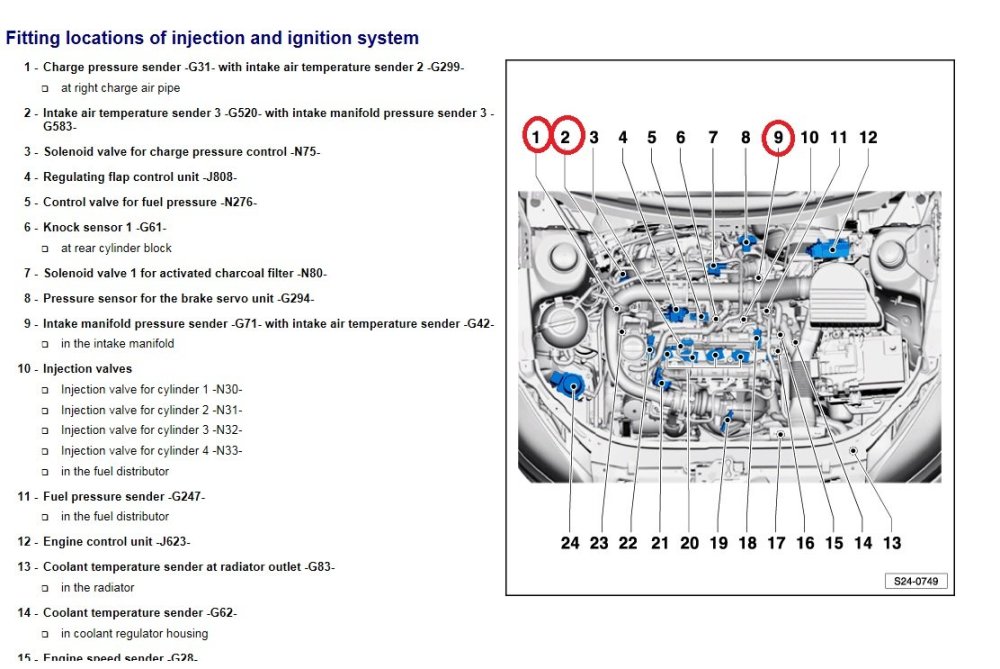

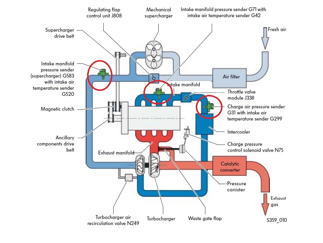

Help please, where can I locate the IAT sensor? Anyone got any pics to share please?
There is actually 3 of them, so ideally you need to know which one your looking for........if you have done any work "near" any of them, then thats the first port of call to see if they are plugged in etc.

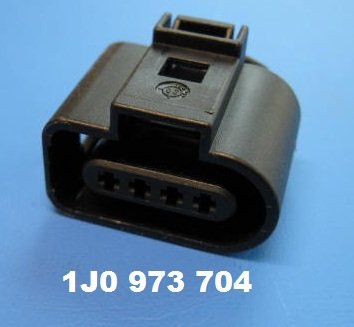

Its a 4 pin P/N
Ebay item with tails to easily splice in.
https://www.ebay.co.uk/itm/323530677224?hash=item4b53ee5be8:g:N40AAOSwTGZhH~bC&amdata=enc%3AAQAHAAAAoPWsplCudygv5Qw4YSoU9QPQmihPfxGvXutk2DtpssNIIuqRrqrPl3x9PrX5sLTiSX%2FwIdl7cCKlptwUwrV2shxU0kHkKGktTuurbkUUr6j8lGjx5CEK1a07FnOP6KYlfQ5vUXLM8J%2B9wWMW%2FQ1bgJ9JOM%2Bi%2FIE9bIhkBU6jHmEcRjlWKiw2mR%2Ba%2FCNCbUh2m2nw3Q8OJHsdDxgiN7YSIkI%3D|tkp%3ABk9SR4y8-6egYQ

you need to replace the plug, if your asking how to best do this then I would suggest the best way is to buy the link below and then cut and splice back into the vehicle loom taking note of wires to which pin numbers, (colours will vary on replacements ), but as long as the PINS match how it is now it will be fine.
If you don't know how to splice back into the loom, then I would suggest buy the plug and tails and call an auto electrician or take it to the garage you mentioned above.
