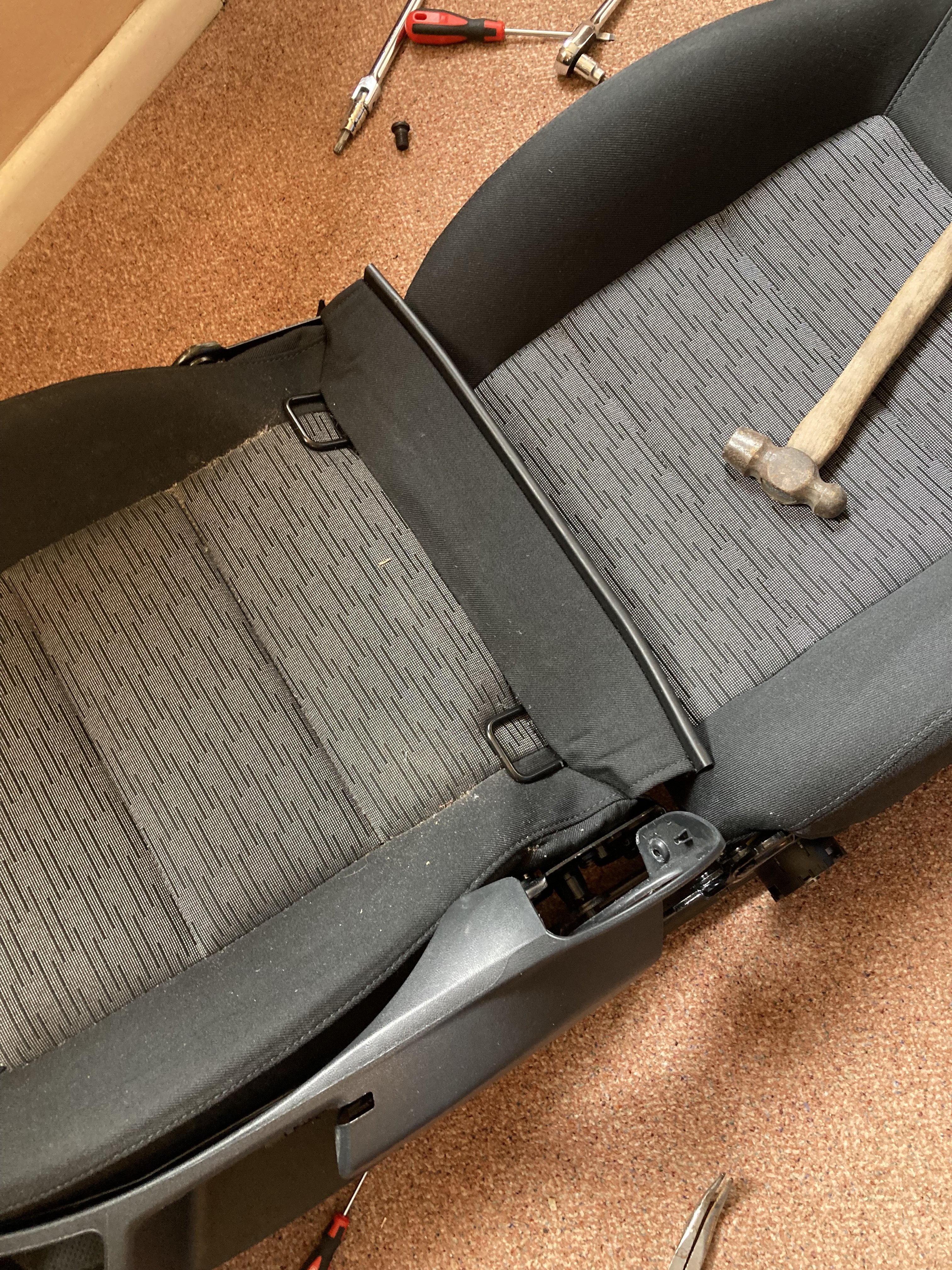

Once the seat was off you have to take the back off the seat. This is simply done by taking two bolts (screws?) off each side. But to get access to those you need to remove the plastic trim on each side of the seat base. Just take your time and don’t use excessive force and it all comes apart.
There is a cable linking the back of the seat and the base so be careful with that. It might be possible to unthread it so you can work on the seat frame unencumbered but I didn’t bother.
Finally you need to unclip the back of the seat cover and put the bracket in. It is held by two screws and it’s really obvious how it goes together.

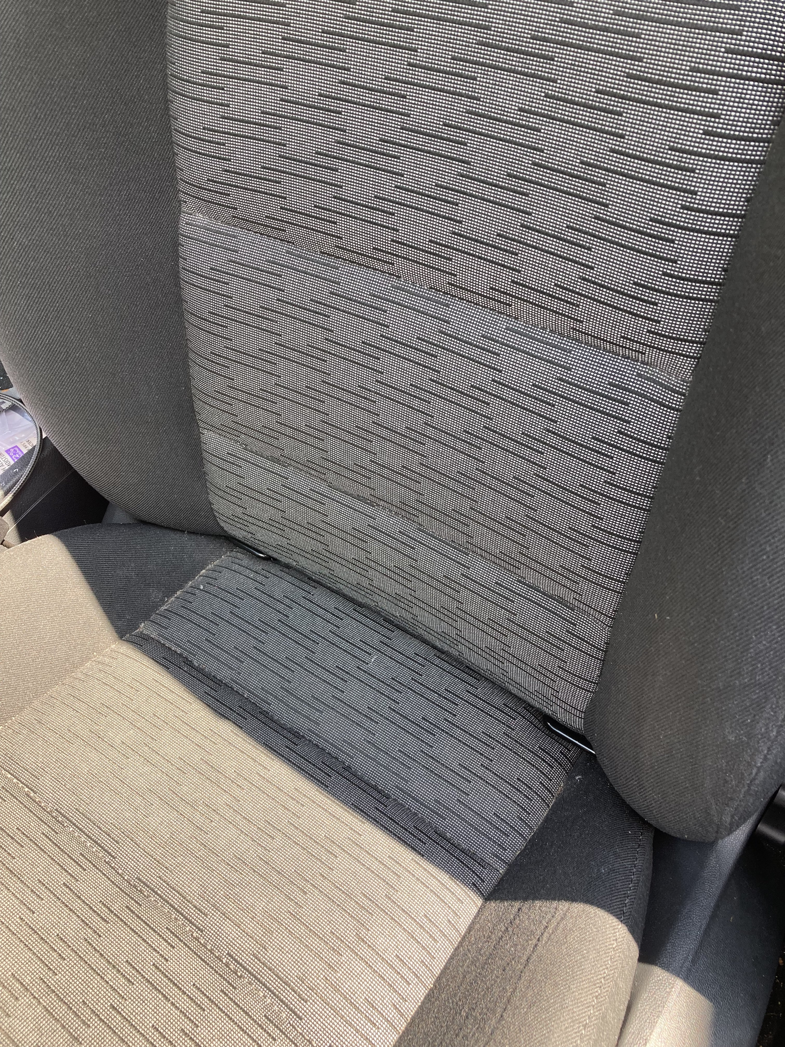

You need to create two holes in the seam of the seat cover to fit the isofix loops through. I just used a Stanley knife to pick away the stitching and stitched at each end of the holes to stop them unravelling.
