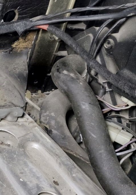

I have found an old photo from the hoses to the Heater Core.
The only way to work properly on them is to remove the battery but since it's extremely difficult (probably impossible) to found 2 original hoses i don't even want to think for a HVAC repair.

The @R_Blue has worked on this, you can see the mess, the new clamps etc.
I grab the chance to show to any New member that will search that matter how difficult is to reach that item (the Heater Core) plus how difficult is to find original hoses.
