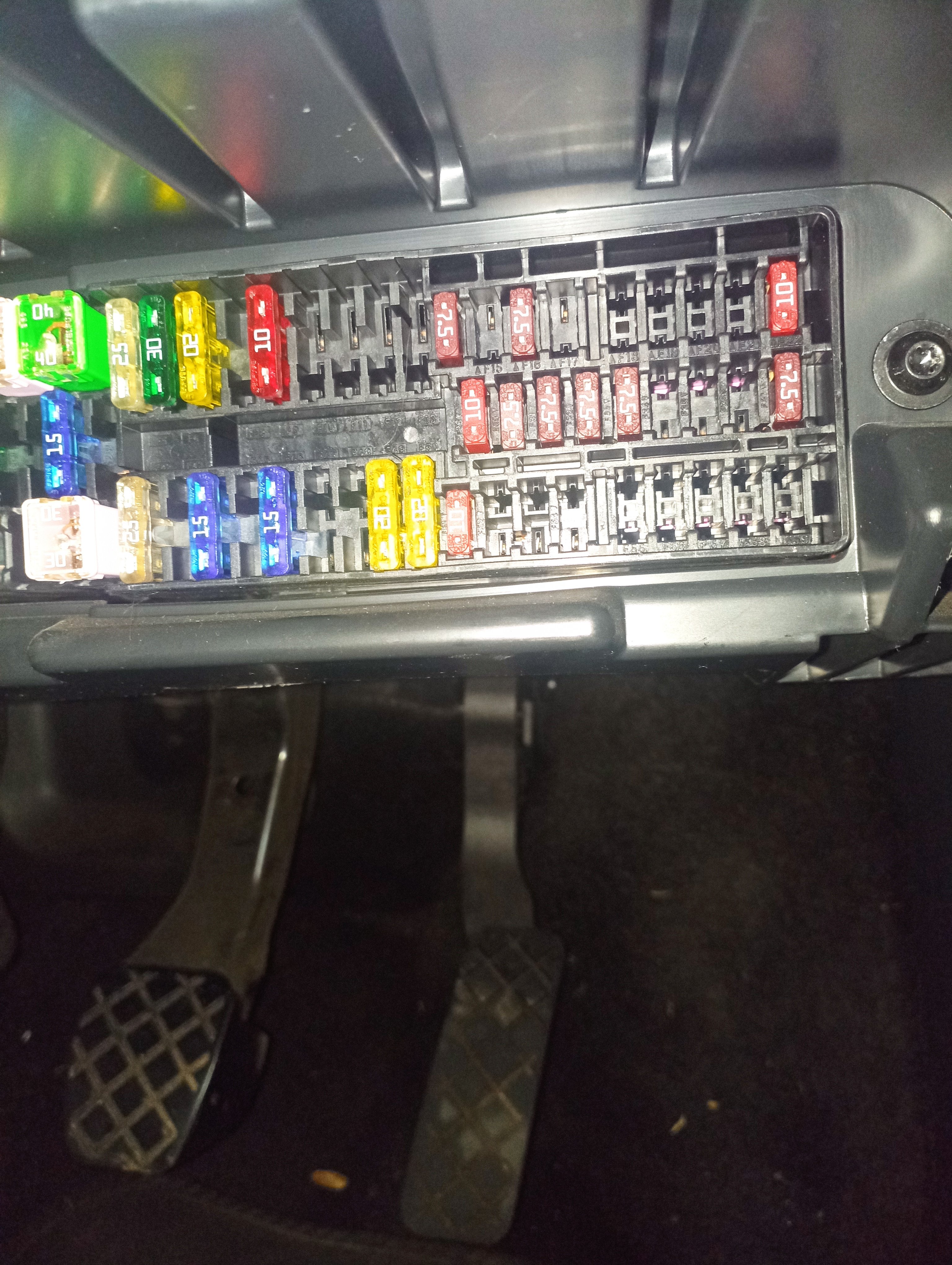

Despite the manual stating window washer system under fuse 44 I think it was it actual fuse in to top right row a micro fuse of 7.5 amp, I had the same issue and changed the top right one and everything worked again.
Great thank you, I'll go give that a go just now!
Top right seems to be a 10amp for me?
You can at a pinch use a 10amp in there but I've ha dmy car from new and never changed that fuse before and mine was 7.5.
Have you taken it out  to check if its burnt out?
It doesn't look burnt out 👎 and neither does socket 46 unfortunately. Tried different fuses in both of them and still nothing. Do you know if it's the same pump that does both front and back? Really hoping it's easier to fix than a new pump.
Thank you for your help!
I had identical symptoms to you, wipers working fine but no pump noise from either window and thankfully changing that fuse sorted it for me. I believe its the dual pump system so only the one pump, but I'm not an expert at all on this just going by what I was reading on here from other people having a similar problem
Thanks
Thank you - will buy a new 7.5A fuse tomorrow for the slot you mentioned and here's hoping I get some movement. Thanks for your help!

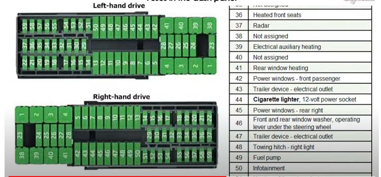

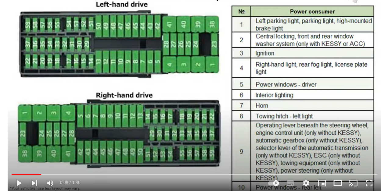

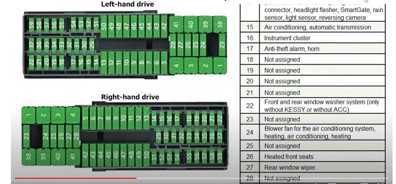

I found the Owner's Manual drawing for the fusebox in the engine bay didn't match what was in my wife's car when sorting the wiper arm stalk.
According to to our 2015 Owner's Manual the fusebox in the cabin for a RHD car has top row far right fuse as fuse "22 Front- and rear windscreen wiper system" and bottom row about middle of row fuse "46 Front and rear window washer, operating lever under the steering wheel" - very unhelpfully they don't give amp rating or colour.

just fixed mine ,  looks like the fuze went when  I hit the control when car was frozen.   top right fuze 22 value  7.5

I understand the difference between fuse 2 and fuse 22 but what is fuse 46 for?
