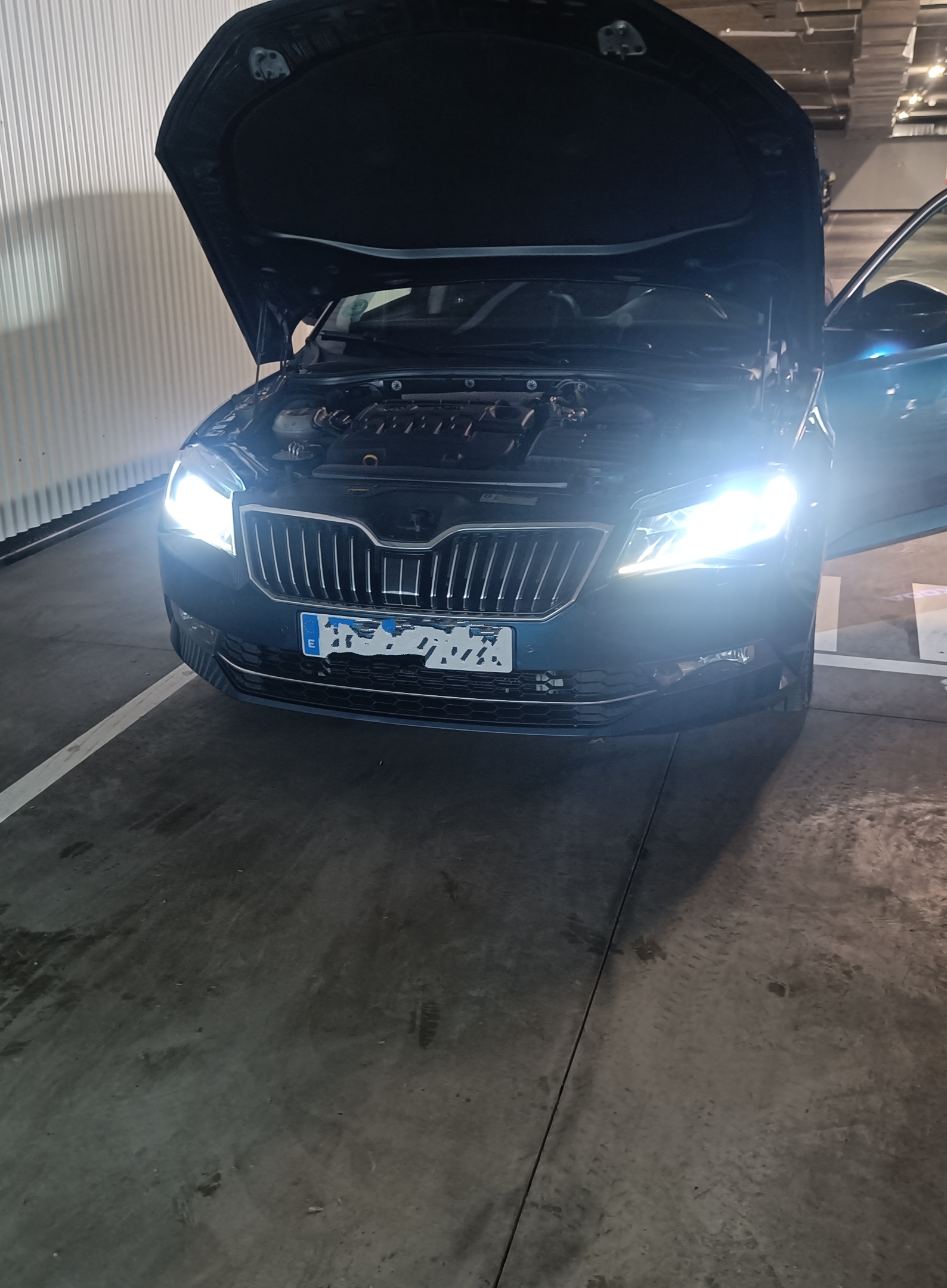

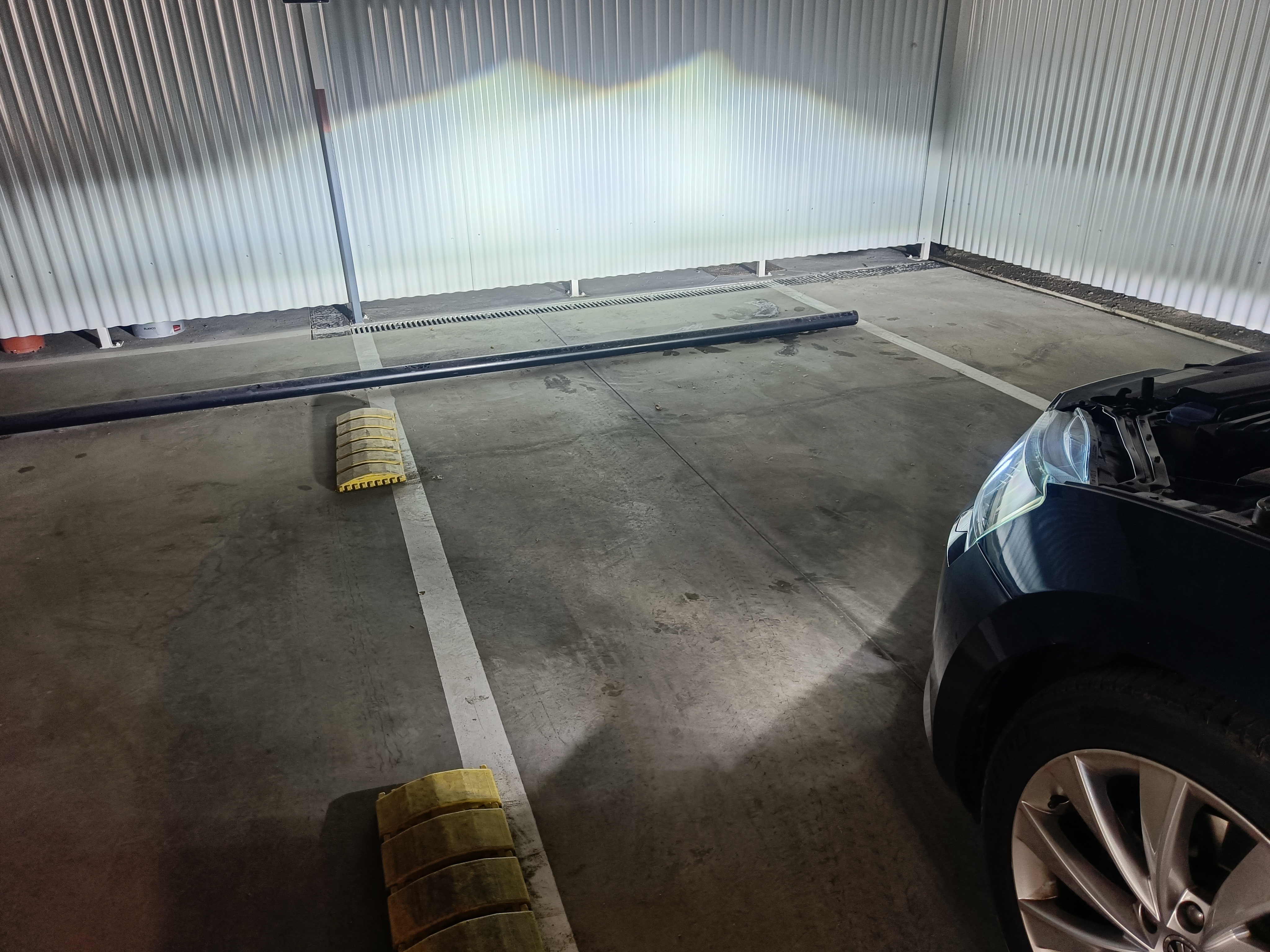

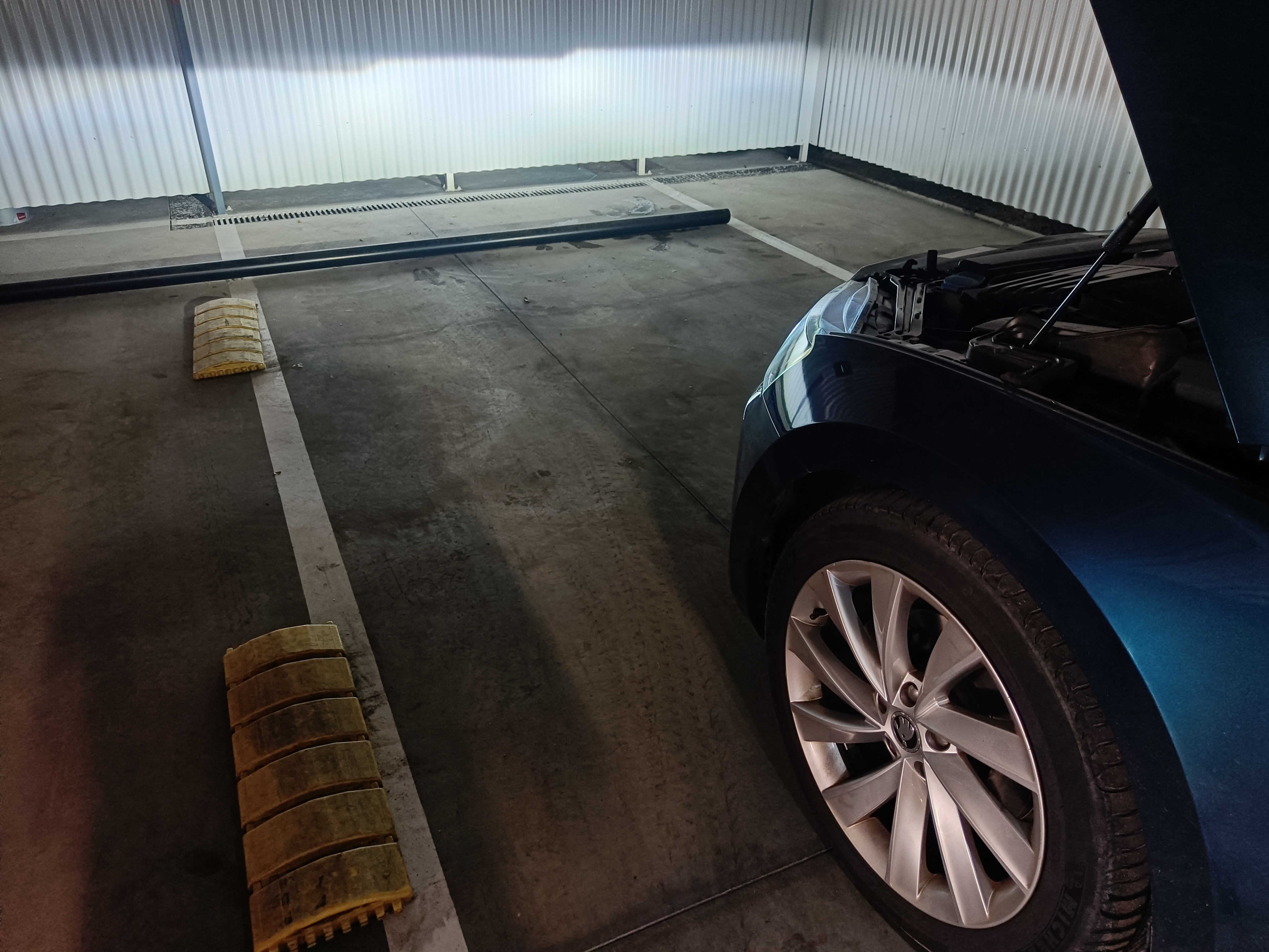

I decided to replace the stock OSRAM cbi xenon bulbs with D+380 LED bulbs.
The change has cost me more than it should have to take the old anchor with "clips" and it is necessary to remove the wheel and the wheel arch.

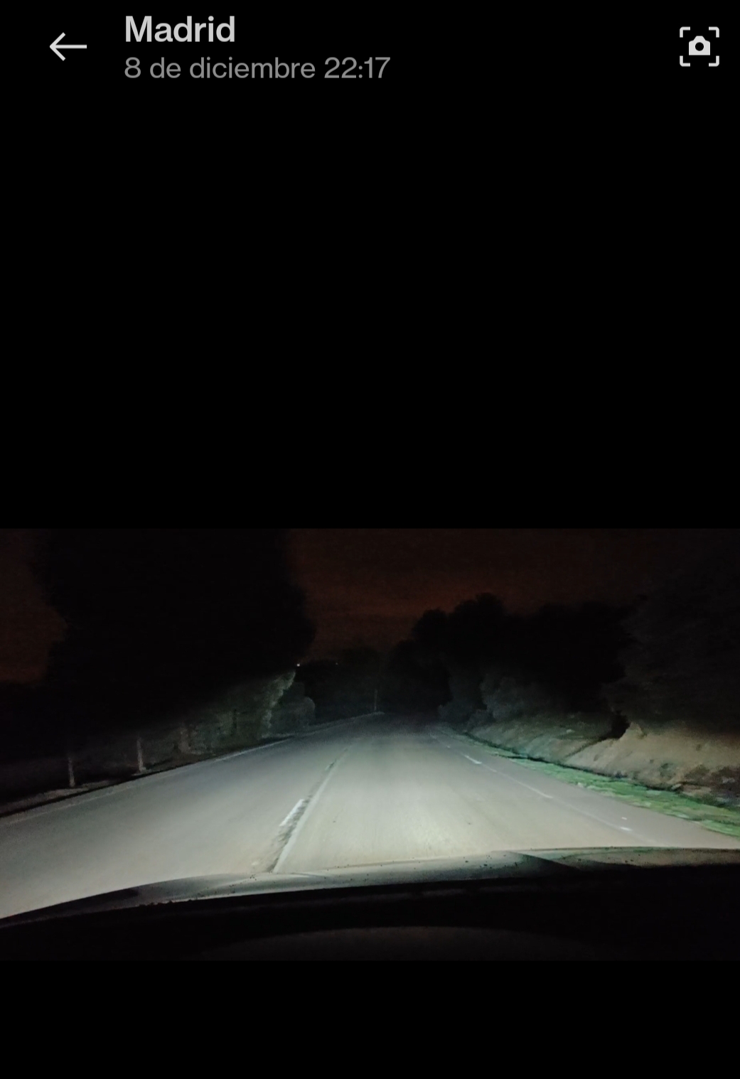

The change has disappointed me a bit, because there is an improvement in intensity and color in the low beams but in the long ones there is no improvement.
For use in the city or in urban areas, it is an improvement, but for motorway trips, for me, I do not see them as appropriate since in my case it causes me fatigue when I cannot see far.  The bulbs reach far but without power, so you have to strain your eyes, since the light does not end like a xenon, but it reaches but without seeing anything.
Summarizing my experience, D+380 bulbs tested in different countries, 35w using the same standard ballasts. Better light and color, more intensity on short beams but ineffective on long beams.
Long lights with led fog lights activated and short without them.

True, but on the road LED bulbs fall short at speeds over 140 km/h.  Using dipped beam, in the city or residential areas or between small population centers they are very good, better than xenon, but for all uses I think xenon is better.  I don't know how the stock LED lights work or the Matrix LED, which I think is spectacular.
