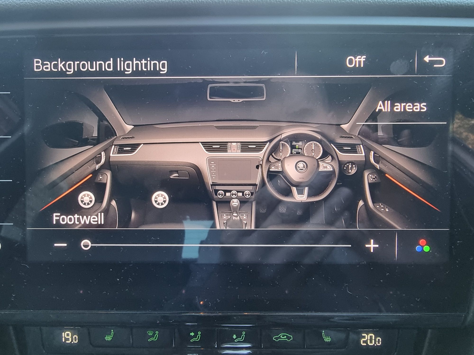

I have the option to change the colour of the footwell lights in my settings, but they are white only, not sure why I have the option, if I cannot. All the other lights around the door etc.. change.
Can these be changed to something that will change colour?

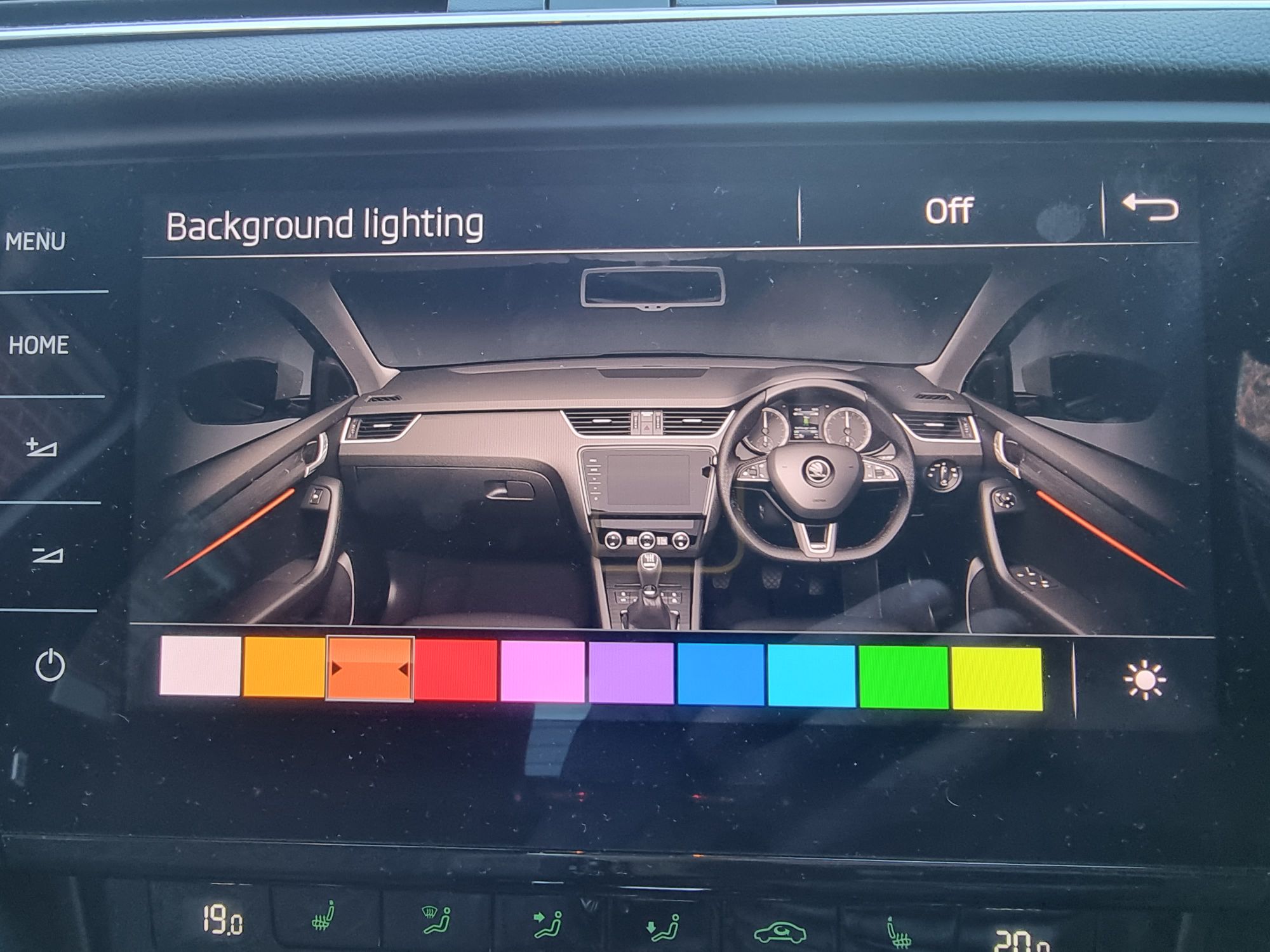

I'll take one tomorrow! I'm doubting myself now......lol
I can select footwell separately, as well as doors and all area, then the colours are on the right, in every instance.
That looks normal to me for a car with standard white footwall lights.
The two 'suns' are to control the brightness of the footwell and ambient light strips separately. The colour selection will effect the ambient light strips and the headunit/instrument colour accents.
If you had RGB footwell lighting, you should get some coloured tints in the footwells, even then there is only one colour selection which effects everything.
