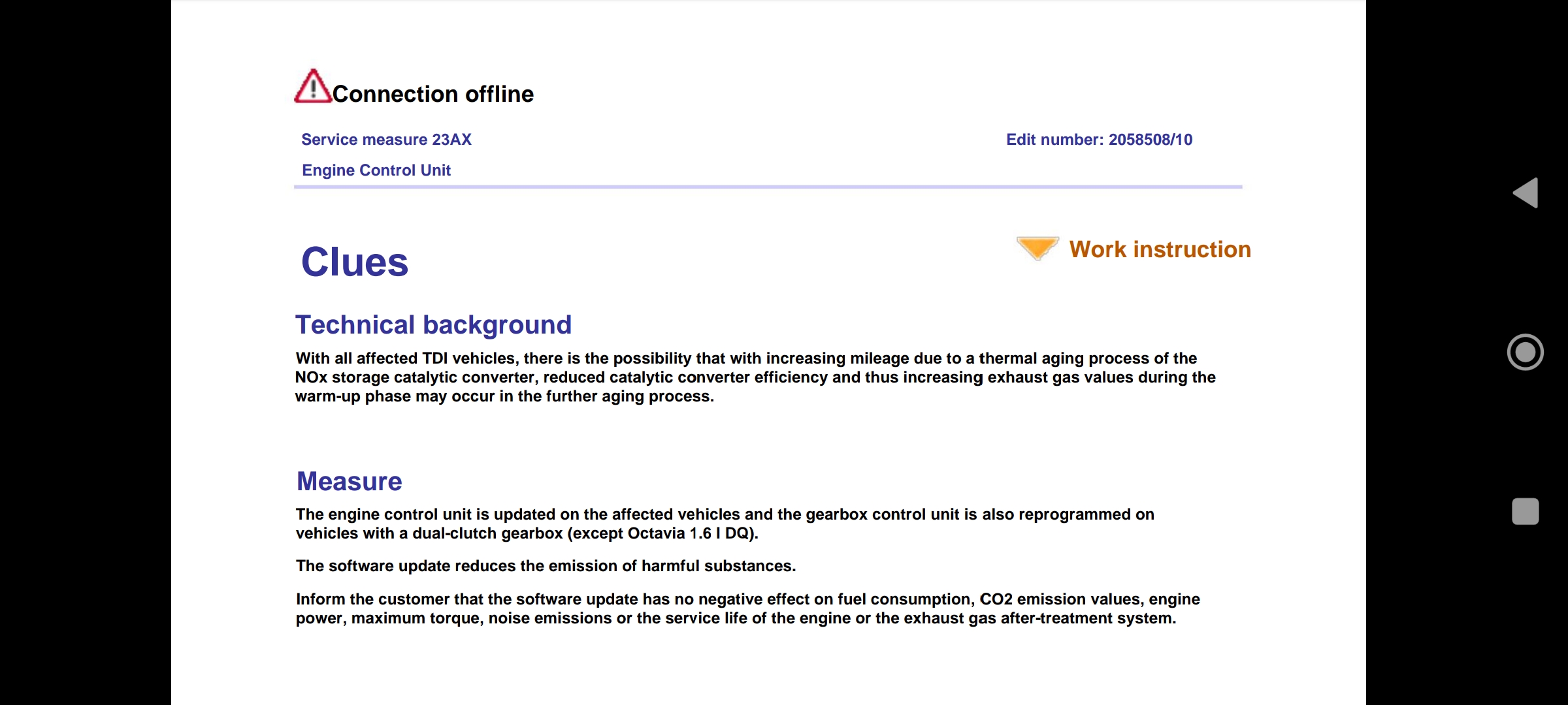

Did you gain a sticker in the boot, with one of the 4 digit campaign stickers?
Like the other thread you/me just posted in?
Not that I was told about. Under the boot floor I assume?
On inspection, paperwork/receipt does list:
23AX 2020-02-05 S Engine Control Unit
I did query the ECU update but was told that it wouldn't have any adverse effects...
Yeah it's engine ECU and gearbox control unit as seen. (Unless 1.6l)
Edit, forgot to say, you might not get a sticker in the boot, where the wheel normally lives, but should be entered on the digital service record.

I think I shall be popping in to discuss with the service manager.
It's unacceptable to fundamentally change the car's behavior without the informed consent of the customer.
Thanks for your help @varooom, this is exactly the kind of helpful info and advice I was after.
