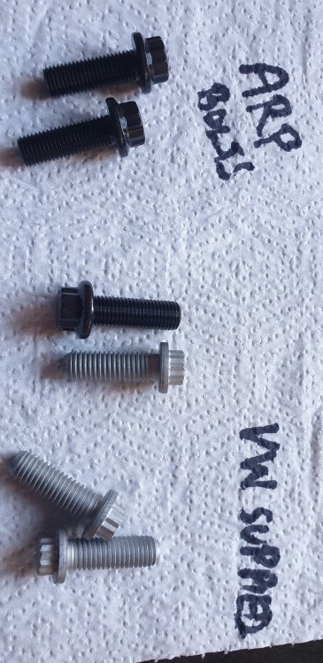

The ARP bolts arrived and we're a different thread pitch so not suitable anyway.
I bit the bullet and picked up the proper VW bolts from a main dealer.
They are however also set screws so I am going to fit these and use a medium thread lock on the threads.
I will keep an eye on them for the next few journeys to see that the bolts remain tight.
With regard to the use of set screws instead of shouldered bolts I am thinking that the torque action on the joint is taken up by the interlocking pegs as per my rough hand drawn diagram above and these bolts maybe don't take the shear action as this is taken by the interlocking faces and maybe that is why VW use these bolts ?
I don't profess to have the engineering knowledge so have to have faith in the fact that VW will have that covered in their design.
Will find out over next few trips  : )
Official VAG part number for bolts is
N90846102 (that fit my skoda yeti 2012 )16742115030226410060411569640615.thumb.jpg.3fd1f91a3e55acebf76341bfad1dd540.jpg

I owe you an apology, had I recalled that you said you used standard M10 bolts to pull the flange together I would have warned you that the ARP bolts were not the ISO standard thead pitch of M10 x 1.5.
It is common practice to use a non standard thread (usually finer pitch) in high load applications where the correct fastener must be used specifically engine bearing caps, driveshaft flanges so I was not alarmed to see the M10 x 1.25 thread.
Now I know that VAG have used an ISO standard thread then I no longer have any concerns about the fastener grade or being a setscrew, as you have deduced the load is taken from the fasteners to the counterbores.
Given that it seemed to reassemble without a struggle I would say that the bolts were never fitted and are amongst the every growing box of bits left over at the end of jobs.
