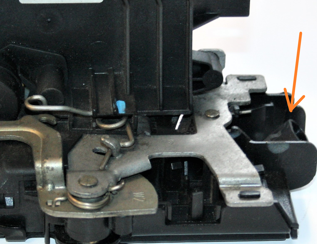

I have the vaguest of memories that the door open switch might be of the more traditional plunger-switch in hinge area on the non-C/L cars.
The locks certainly look different, I think this is the latest revision for rhd drivers door: https://www.stevensvwspares.com/vw-lupo-door-lock-mechanism/drivers-side-front-door-lock-catch-manual
Struggling to find 360-degree views of one, on phone.
@varooom, can you perhaps do better?
I seem to think this came up before and the conclusion was either that there are no electrical connections to these manual locks, or just a two-way. Can't remember which, but can't see one in that StevensVW pic.

No worries pal. The C/L versions have an 8-pin conn seen near the 2 in your second pic.

Basically what I wanted to know before I took the door apart was is there a micro switch in the door lock ( I gather it's a common fault on the central locking door fabia's ) and I didn't know if it's the Same on non central cars like mine and I couldn't see a plunger style switch anywhere on the door when I took a quick look
Pretty sure the non central locking versions still have a microswitch inside the lock unit for the interior light/buzzer.

I can see the plug socket....

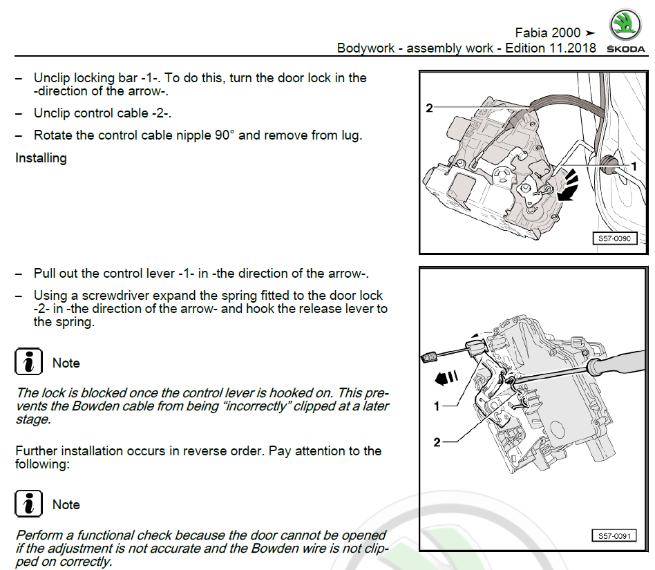

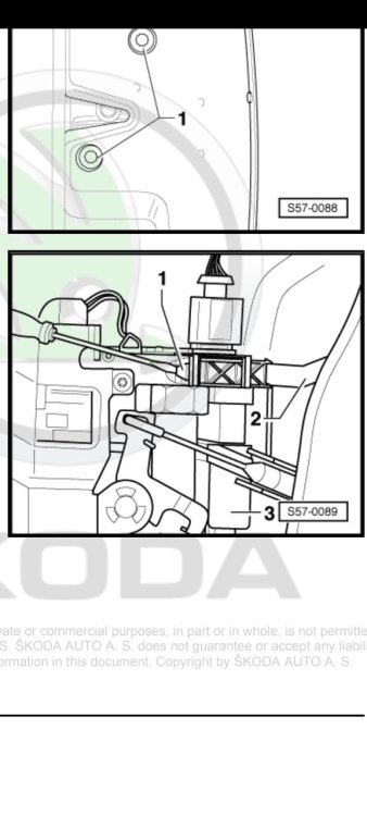

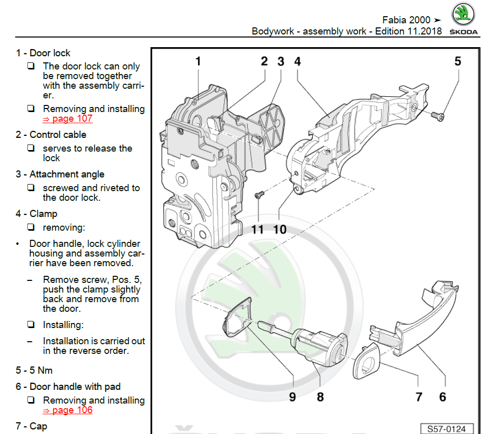

I did finally get a chance to see again the diagram's.
You can clearly see the connector, odd as VAG usually tell you every step to remove and they didn't mention the plug connector 🙄
Looks like it plugs into a non replaceable part shame

The locks can be taken apart and new microswitches fitted if you have the skills. Done mine.

 No, I think the switch might be inside the lock on non CL cars, not clipped to the outside of the lock body like the CL ones. Probably be just as easy to get a new lock.

TMB I think you are very likely correct from what I have seen on here and the web I will look into getting one
