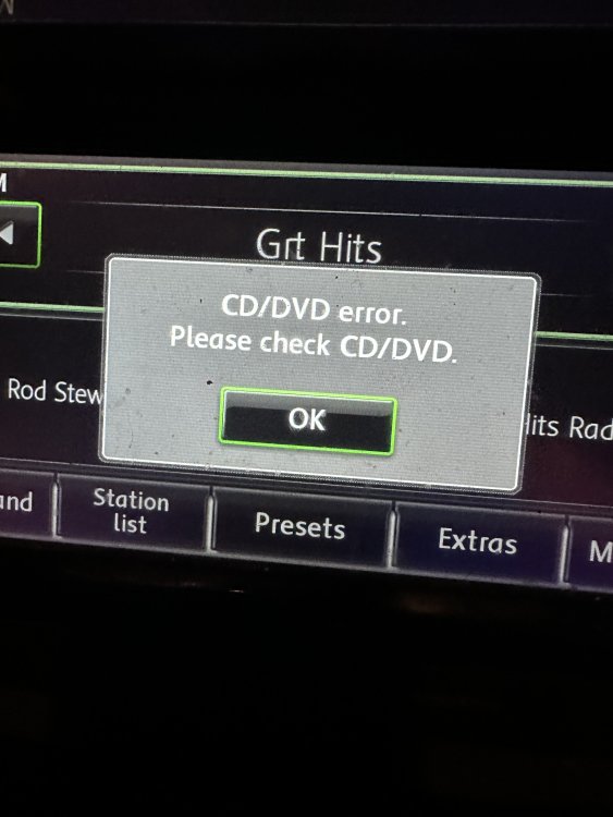

Got that error on the car radio. I can only watch a dvd for bout 40 minutes then it freezes.
Any one got any ideas why it does it ?
