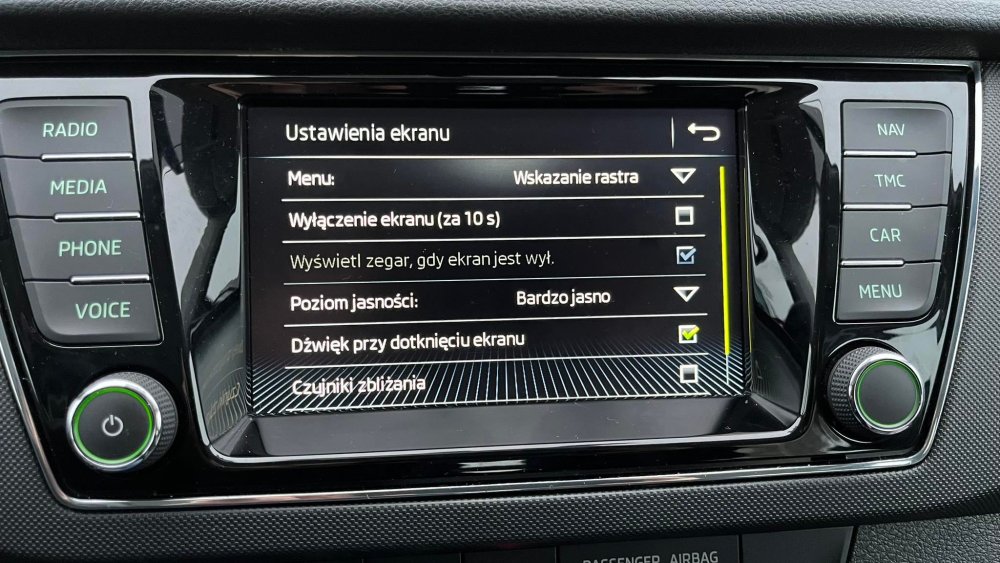

Hi.
I have a hacked MiB2 unit in Skoda Fabia 3 which was factory in Skoda Superb 3.
I have already dealt with most of the problems with the help of VCDS.
There were no proximity sensors in the touch screens installed in the Skoda Fabia 3, and there were such sensors in the Skoda Superb.
How to completely remove this item in the radio menu?
1 minute ago, Zlosnik said:
Hi.
I have already replied to you in another forum - by loading container file dedicated for Fabia.
