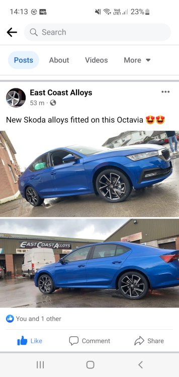

So to update this thread I got a full set of oem skoda vega style alloys of super skoda or kopacek as it's called now with 225/45/r18 tyres
