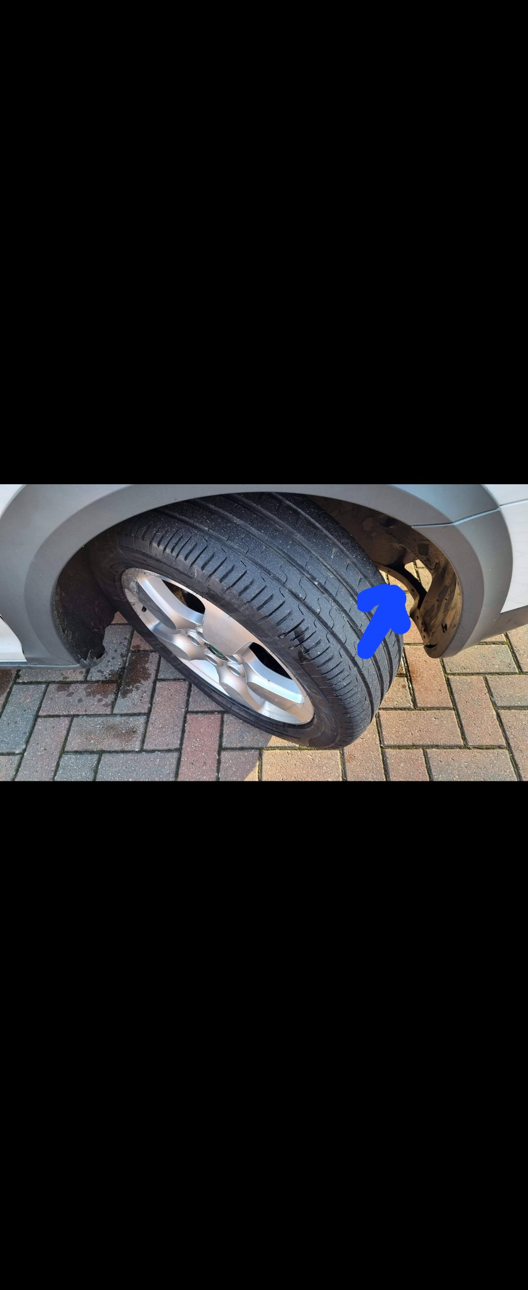

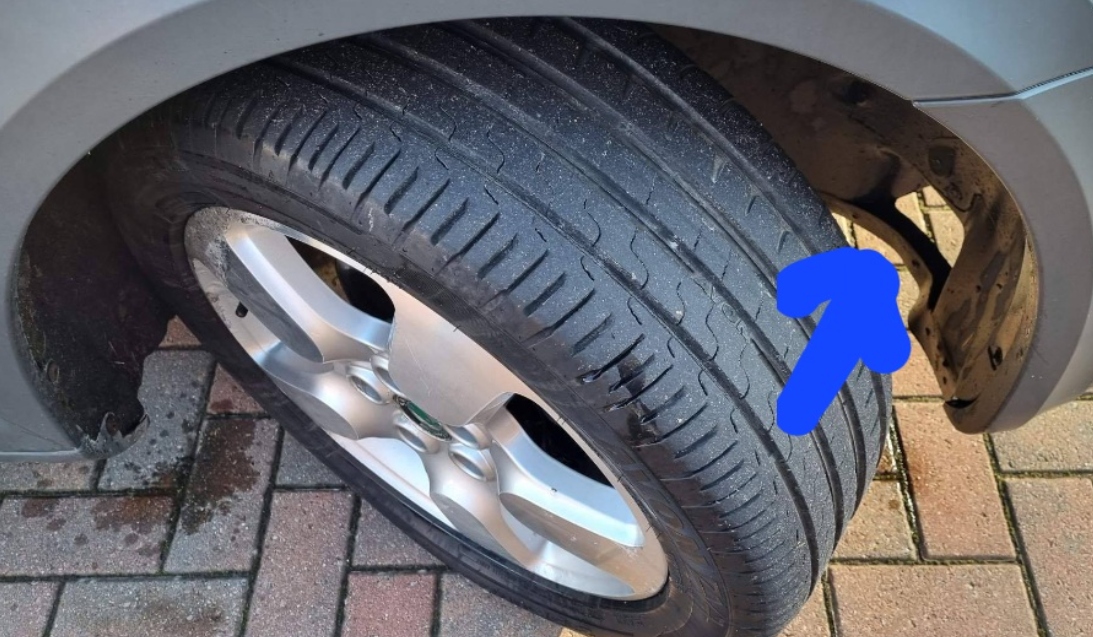

So since I bought my scout, the passenger side of the front bumper has a slight droop. When wahing the car at the weekend I realised on the passenger side, the bit the arrow points at is straight and not curved luke the driverside. I'm not mechanically minded, so any help on what it's called and if it can be replaced to stop the droop would be amazing 😀

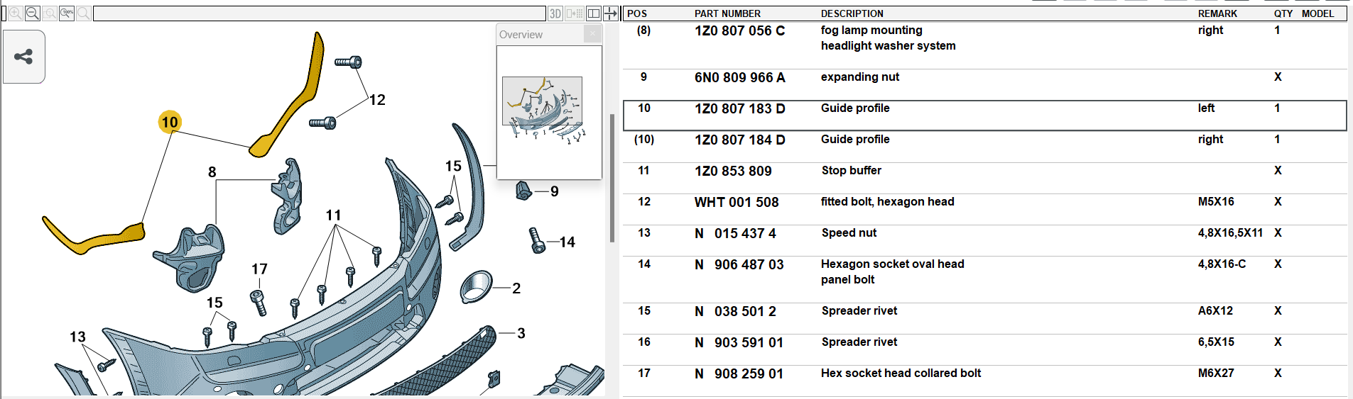

My best stab in the dark guess is a guide profile, but it's not easy to see myself from the images.
Note they are not the same shape Left/Right.
As mentioned, I could be barking up the wrong tree

Thanks. It could be, looks that kind of area. I will try get a better picture tomorrow. Its been dark past few days before after work

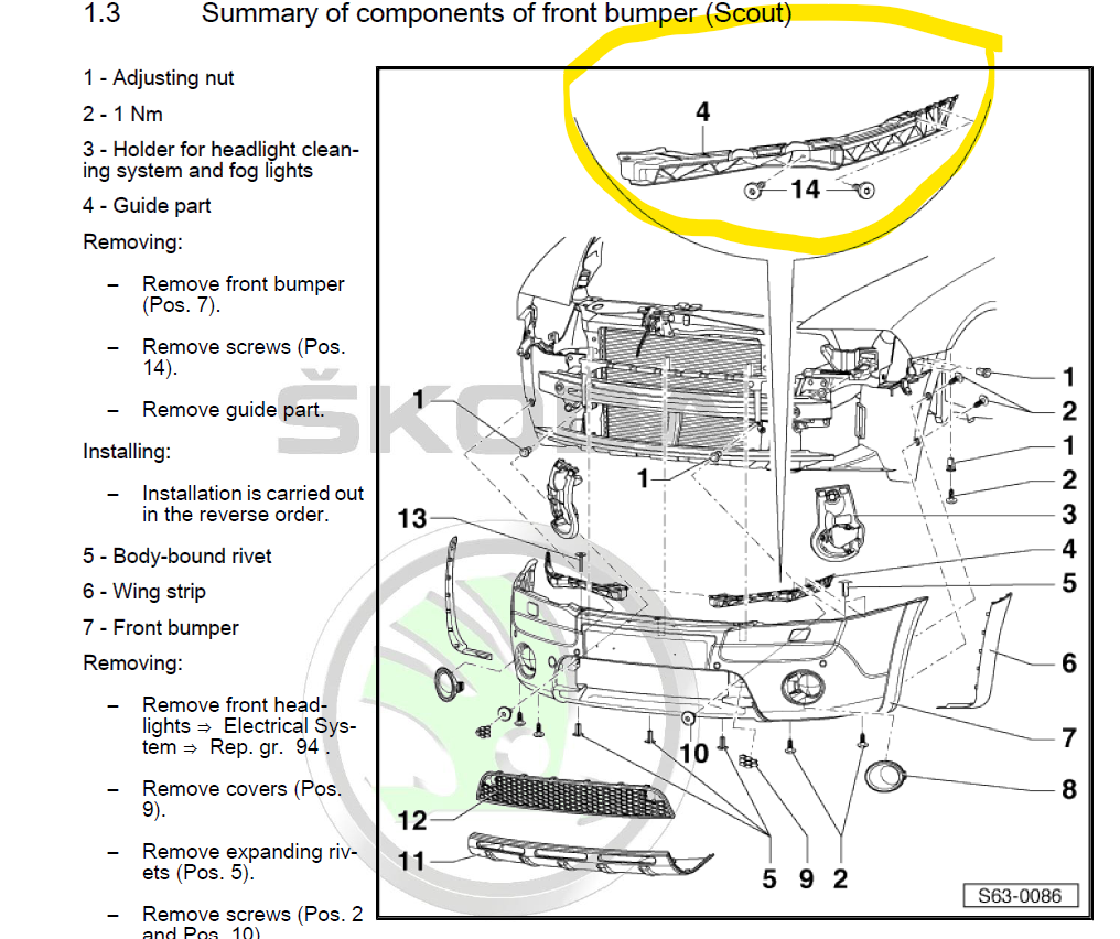

This the the part that @varooomhas identified. Different for left a d right side.
