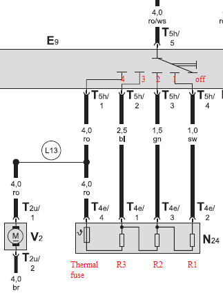

Red/white feed to the cabin fan switch at the back of the heater/aircon controls may be your best bet.
Right at the top of this diagram.
/cdn-cgi/mirage/190e0babfd6bd9663f569518f878643094c11ca8ce9e61d9b9bba60525b67069/1280/https://www.briskoda.net/forums/uploads/monthly_2023_02/103090211_Cabinfanspeed.png.094f688f63f707fd255966183a8af8d7.png
Ok that is great thank you I’ll give that a try!
