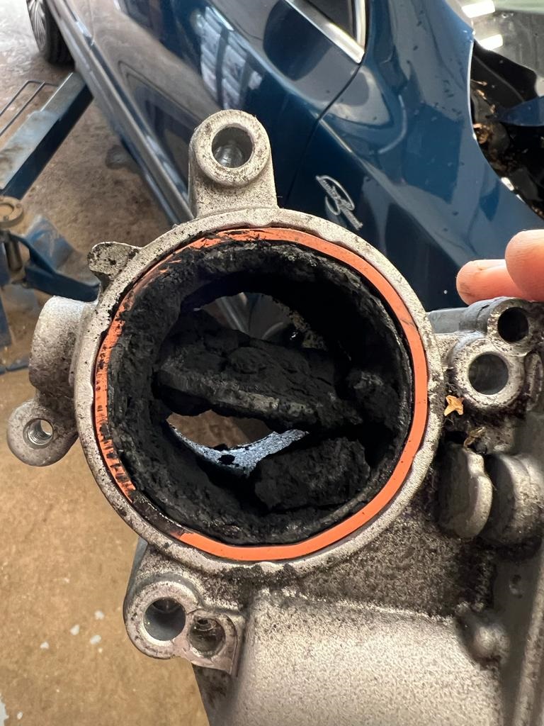

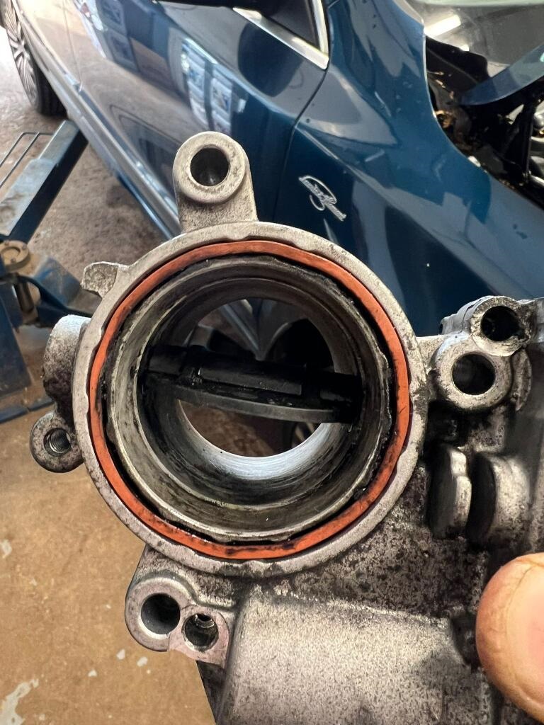

I have had my throttle body cleaned by a local garage (Trinity, in Springfield Road, Chelmsford) and I have to say that they have done a good job, originally estimated an hour's work but due to a stubborn bolt it took almost 2 hours. The car is actually smoother on take off now as before sometimes it would snatch a bit and also the engine is idling around 800rpm, before it would fluctuate between 800 to 1000rpm. I'm also noticing that it gets into 4th gear a lot more now during town driving at speeds of 25mph, before it was nearer to 30mph, so fuel economy should be better as well. Time will tell on that front.
When I went to pick up my this afternoon, I was pleasantly surprised when I was informed that had a couple of photos for me to show what they found on removal and another showing how clean it was when they refitted it, I attach these below, and I'm amazed at the state it was in and can see why the OBD2 error report said that the body was giving an implausible reading, the gunk was preventing the flap from sitting correctly and thus giving the ECU an input that might suggest the engine might run at too high rpm if the start/stop system were to start the engine and the car shoot of at unexpected speed? Does that make sense?
An update on the topic for you, it has been a whole week since the body was cleaned, and I've done a fair bit of driving in that week, in traffic with the stop/start performing absolutely brilliantly, not missing a beat, stops instantly with no rough shudder and starts the same way. Power delivery is also perfectly smooth when pulling away from stationary, and the idle is once again nice at 800rpm.
So the video I found on YT was correct and also a big thank you to DEL80Y, it really was just the throttle body that needed cleaning.
