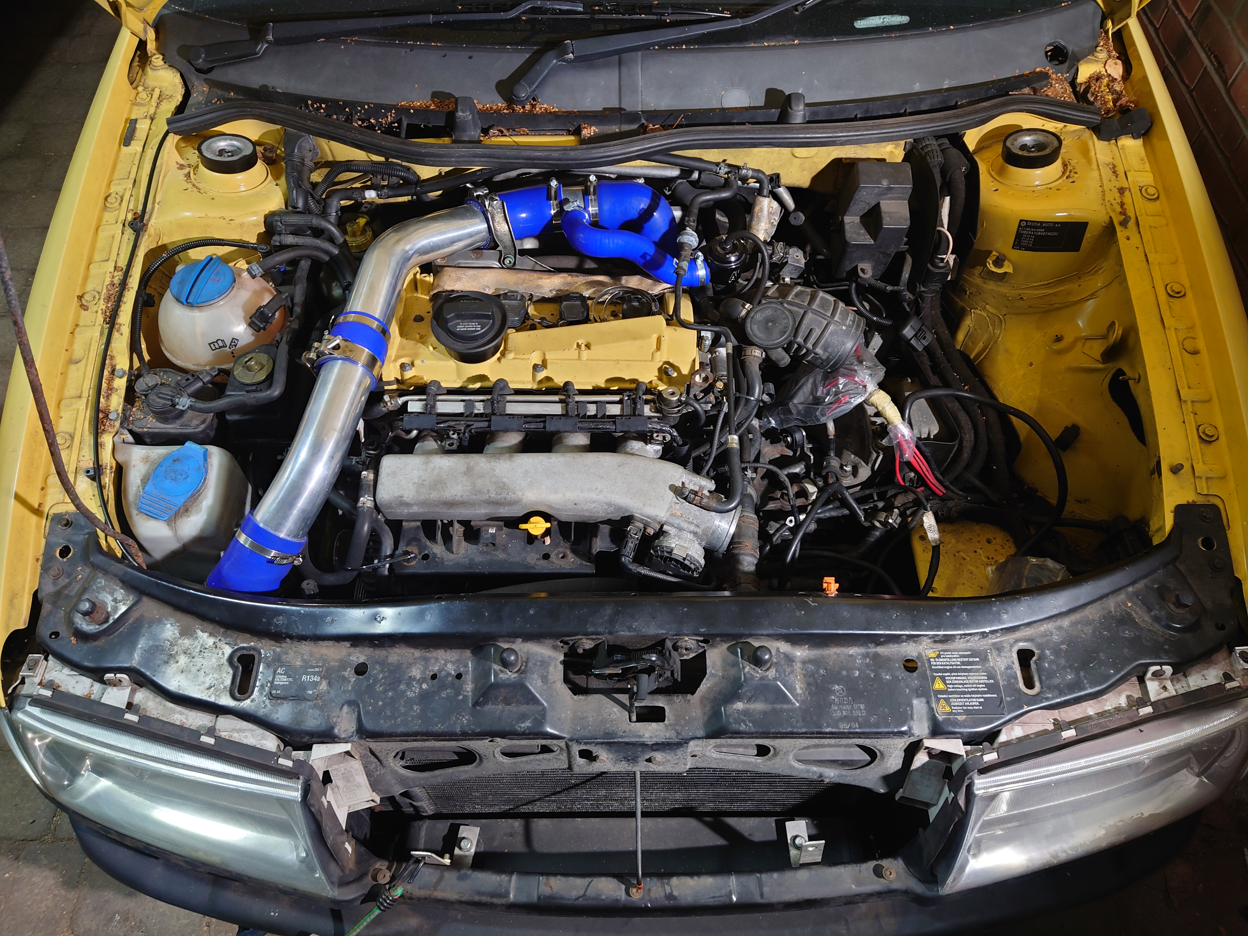

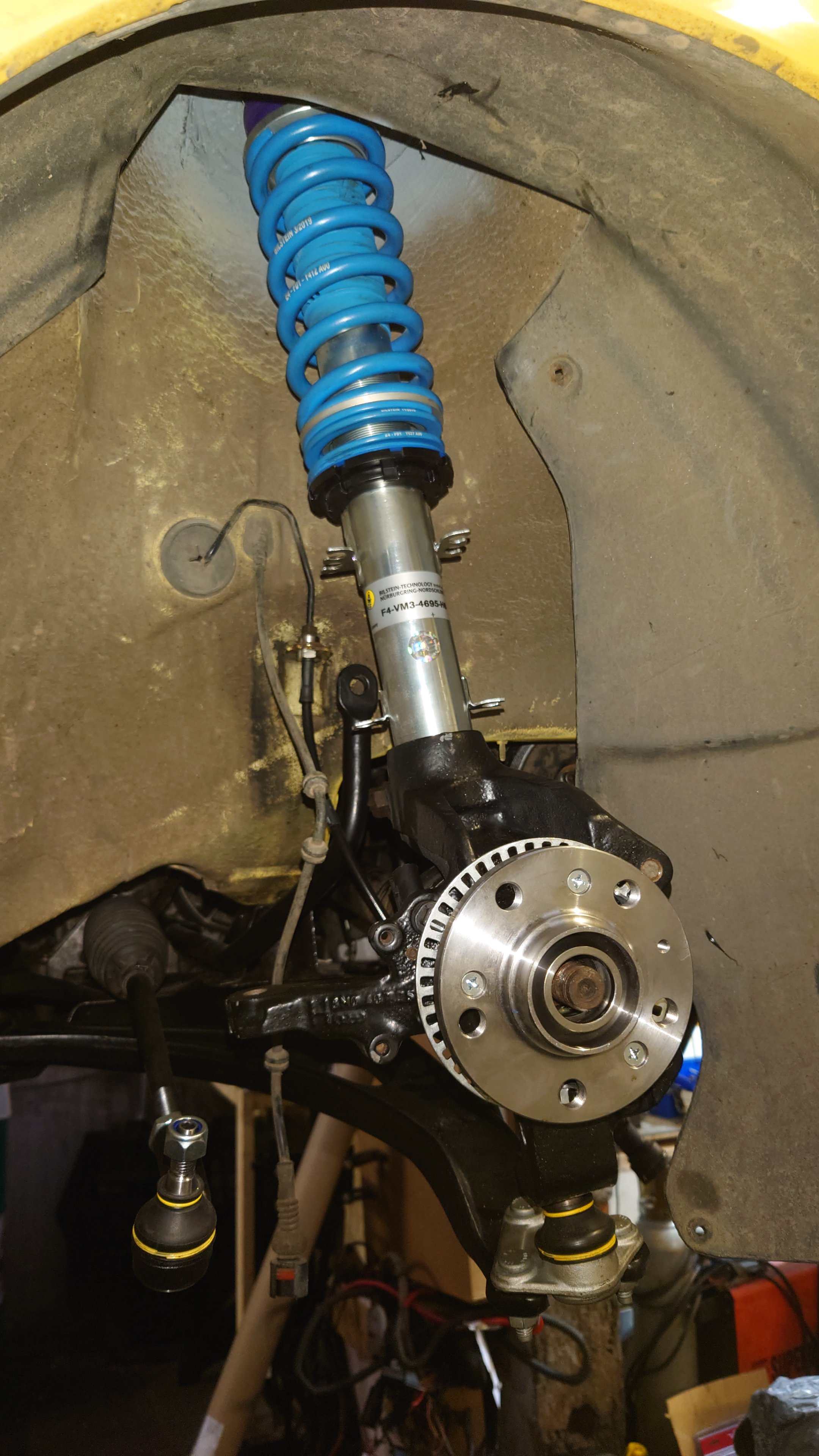

Since then the subframe and suspension have all gone on, driveshafts fitted, vacuum lines plumbed in (I hope), coolant lines plumbed in, intercooler pipework fitted, wiring pretty much all connected up, and S3 ECU reprogrammed and swapped over.
I've spent the last few days tidying up wiring and pipework to make sure nothing is fouling on anything or rubbing. I'm now ready to fit the battery, wang some fluids in, and hopefully she'll fire up... first time!

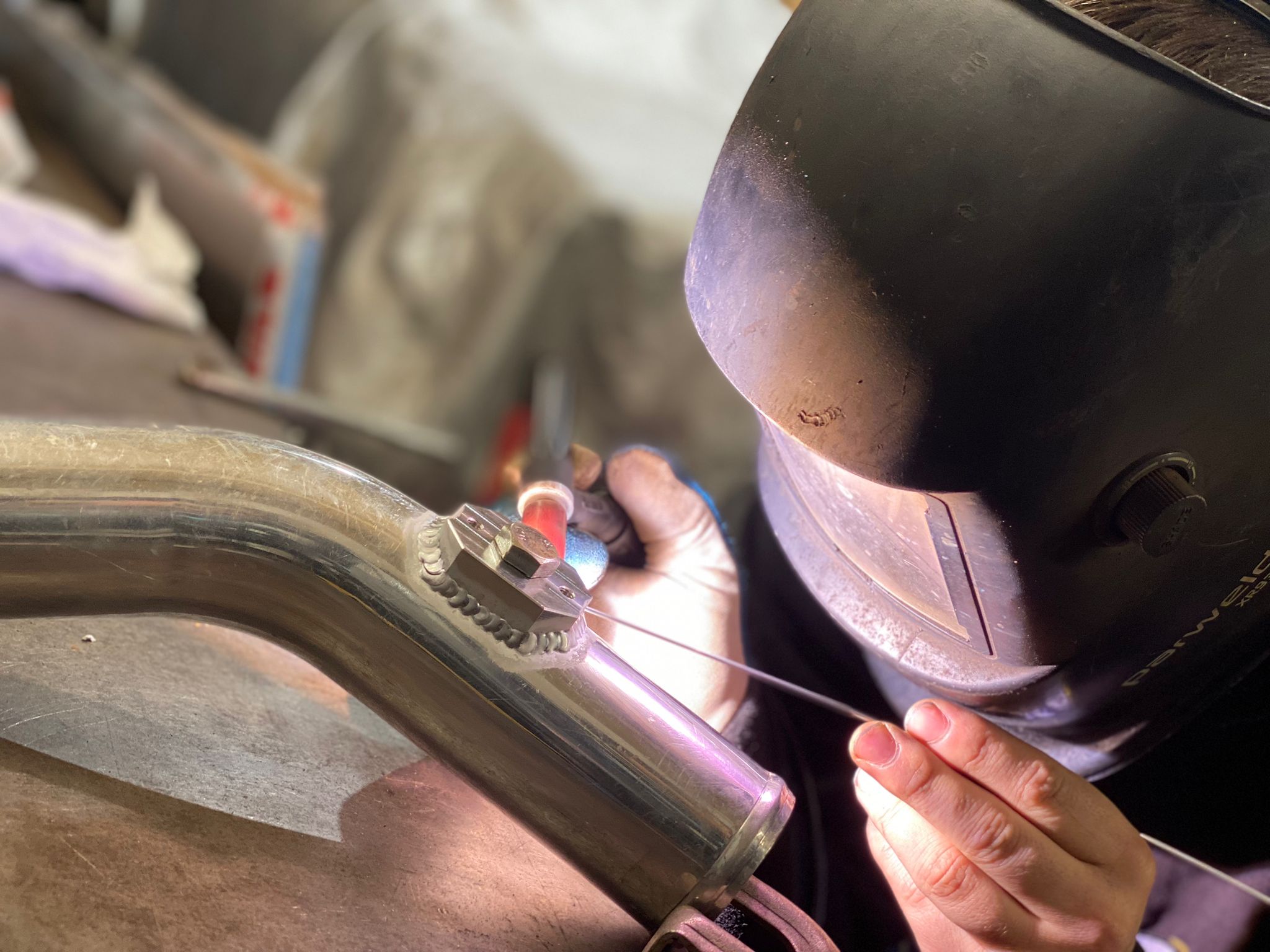

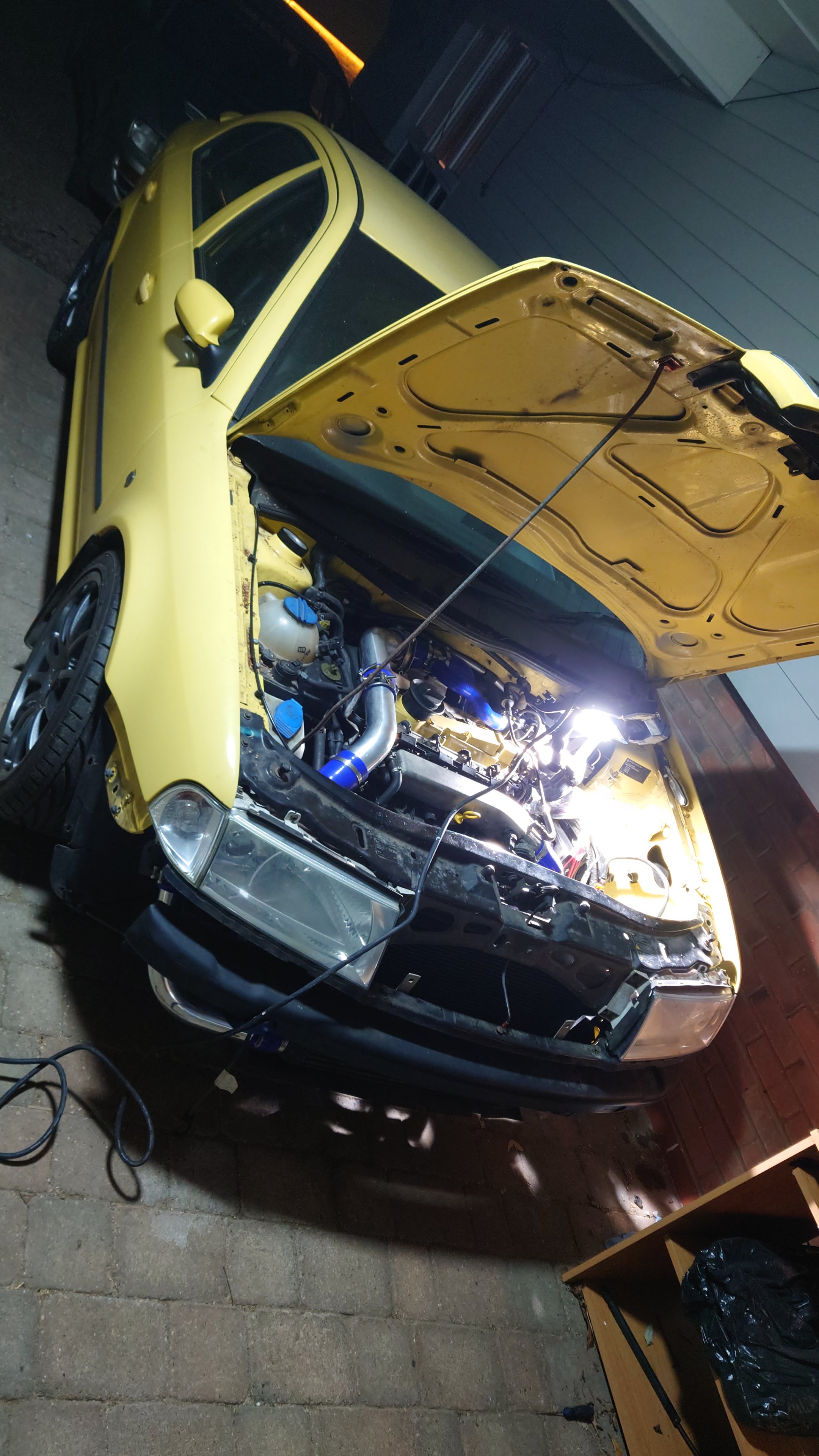

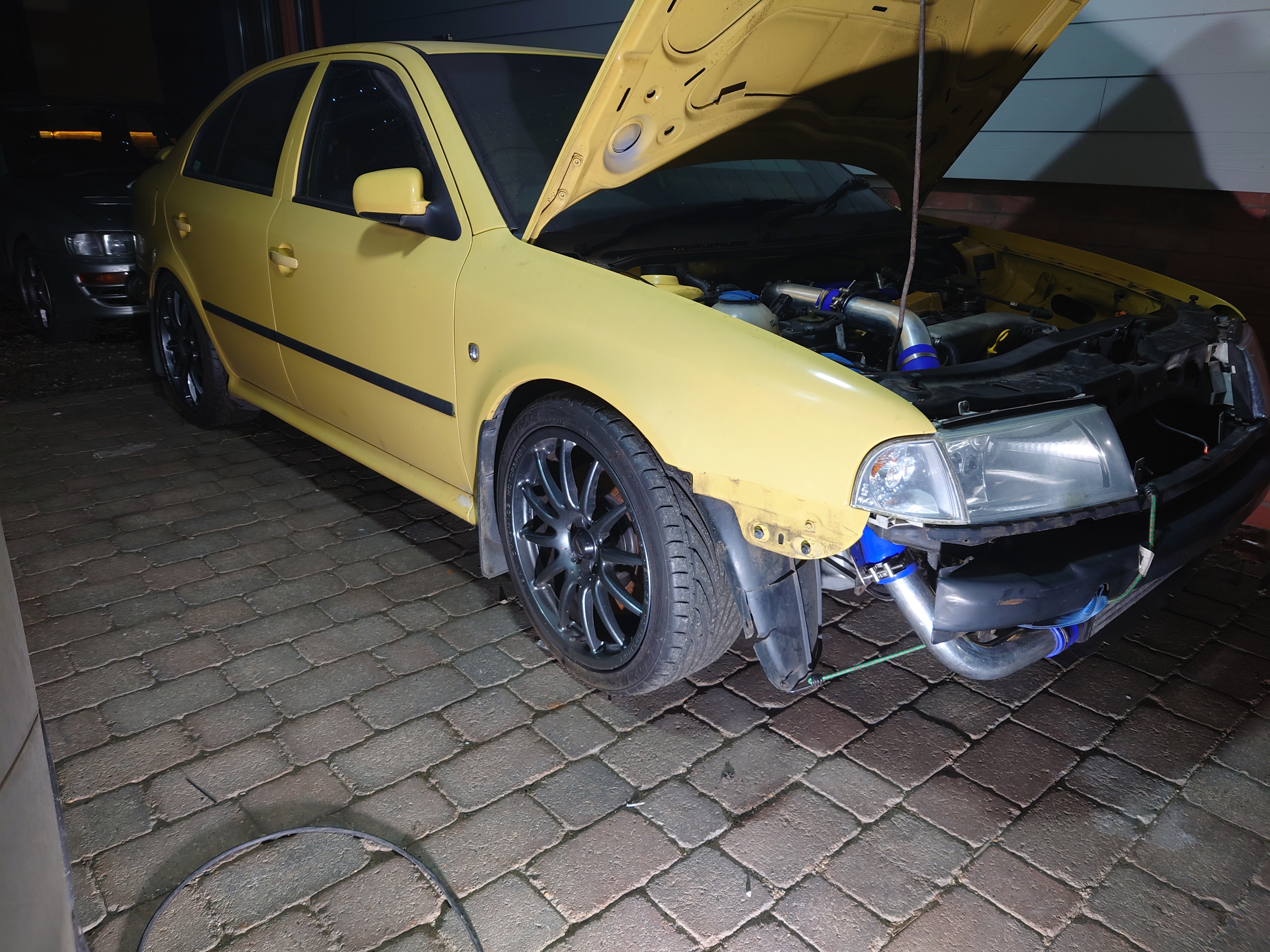

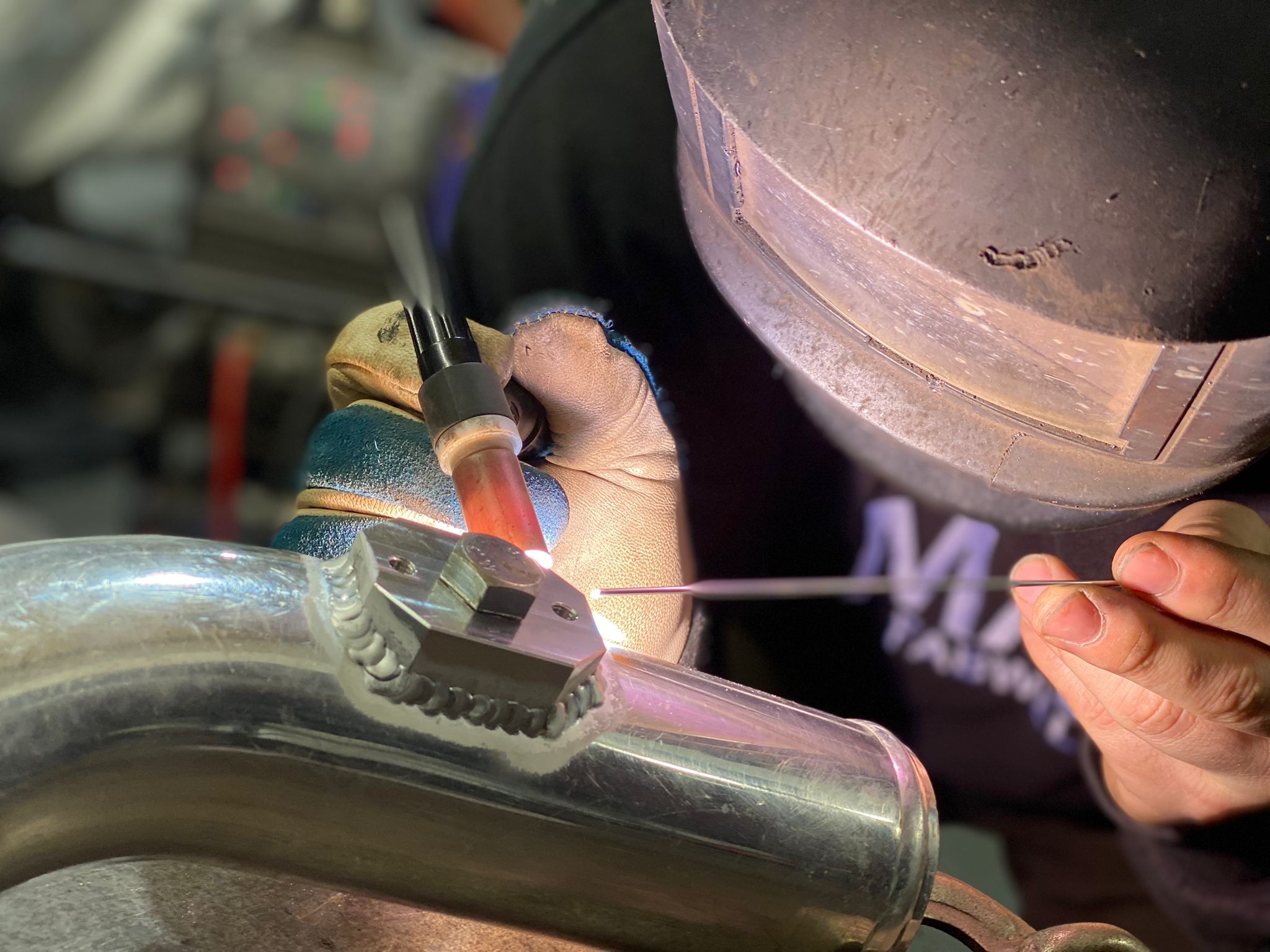

Pics are of (in no particular order) the front suspension looking all shiny, engine bay with intercooler pipework fitted, flange for MAP sensor being welded, and the car as it looks now sat on its new wheels.
After I get it running... I need to source some wheel spacers. The wheels currently clear the coilovers by about 2mm! I don't like spacers as they mess with alignment so much, namely scrub radius which is important. But they will need fitting, so I need to measure up and get them ordered. Then I will fit the brakes and bleed them along with the clutch, power steering fluid, tighten a few screws here and there, and fit the front bumper and the Leon Cupra R splitter. Then she should be good to go!
