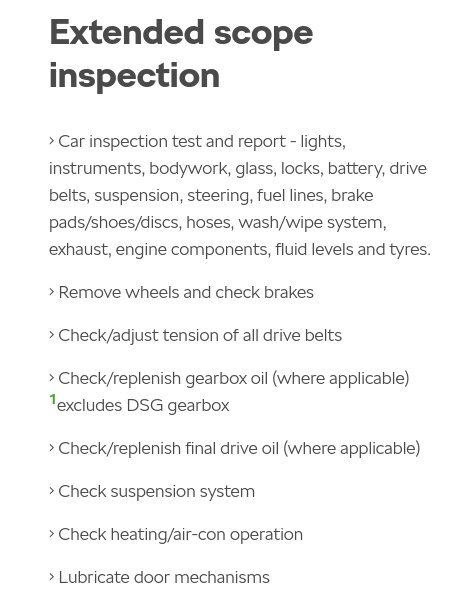

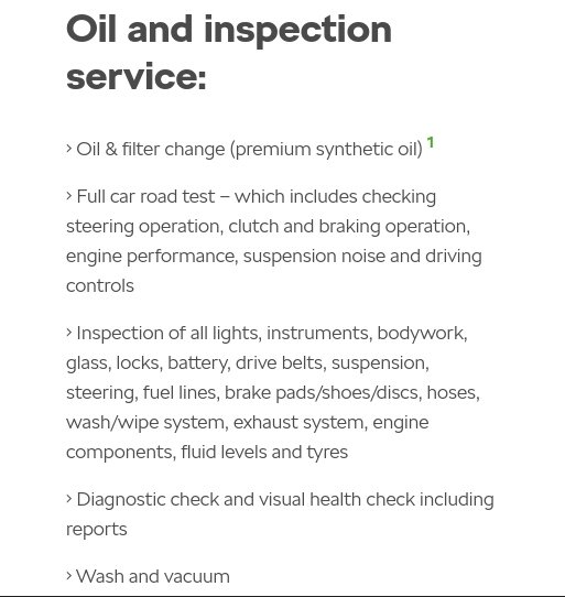

922218293_Screenshot2022-09-2115_58_57.jpg.3711dc86397a804fc83f268add4ae736.jpg.ece7ad63bf3be1dd444132de450cade0.jpg
368071363_Screenshot2022-03-2511_55_58.jpg.edf9de7f74f6008ca469ca99fb9091d8.jpg.59c8e70155a4cf78e8950a1f2f6ef6be (3).jpg
Edited by toot

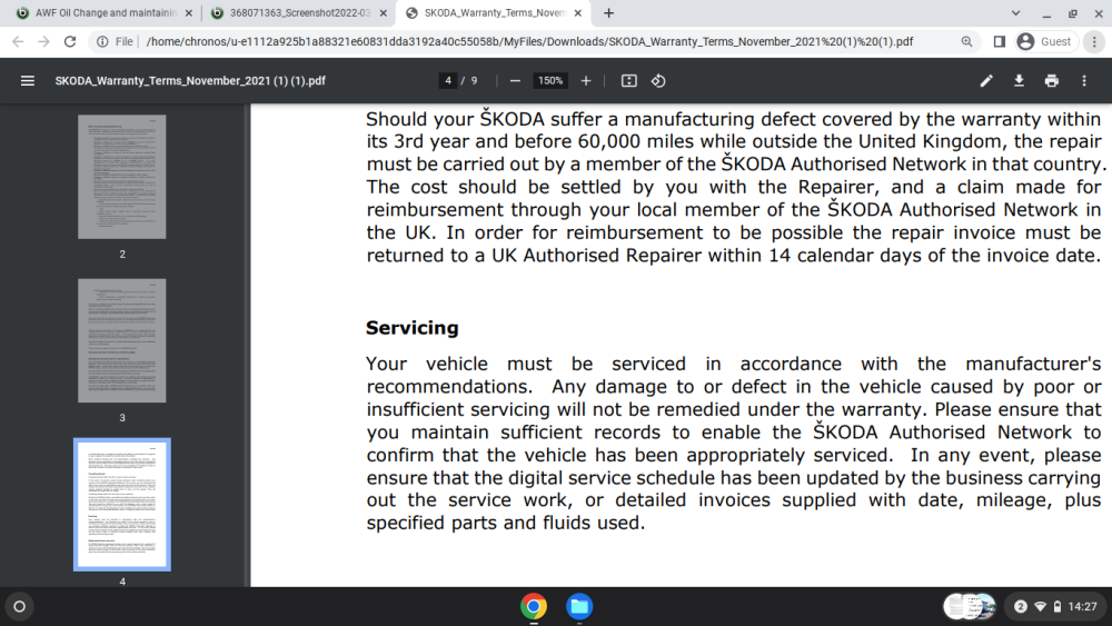

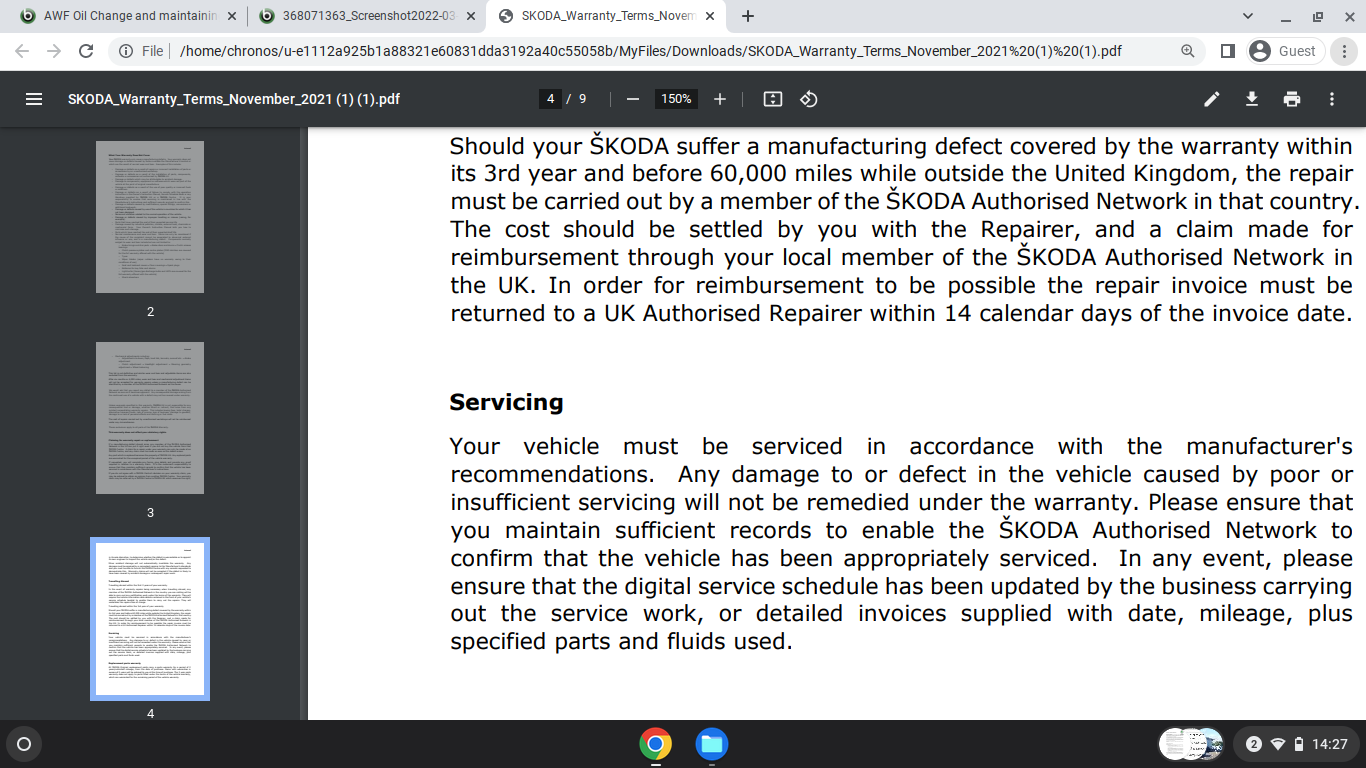

Re the Manufacturers Warranty.
The car has to be serviced to the Manufacturers Recommendation, Guidelines, Schedule or Specifications using the factory parts, fluids etc,  (The term Schedule does not appear. Not VAT Registered, it changes what is in the T&C's over the years, it used to be 'guidance', at one point 'Specification'.)
record kept, VAT registered place etc.
So what ever terms they use.
Pity a Main Dealership does not know the Recommendations, Guidelines, Schedule or Specifications and often who not to service a Haldex properly.
They even sell Skoda Approved Used cars with a FMDSH but not serviced as per recommendations, guidelines, schedule or specifications and they put a warranty on them.
Is the car a keeper?
If so decide what you want and are you extending the warranty beyond 3 years?  Read the T&C.s.
SKODA_Warranty_Terms_November_2021 (1).pdf
Edited by toot
