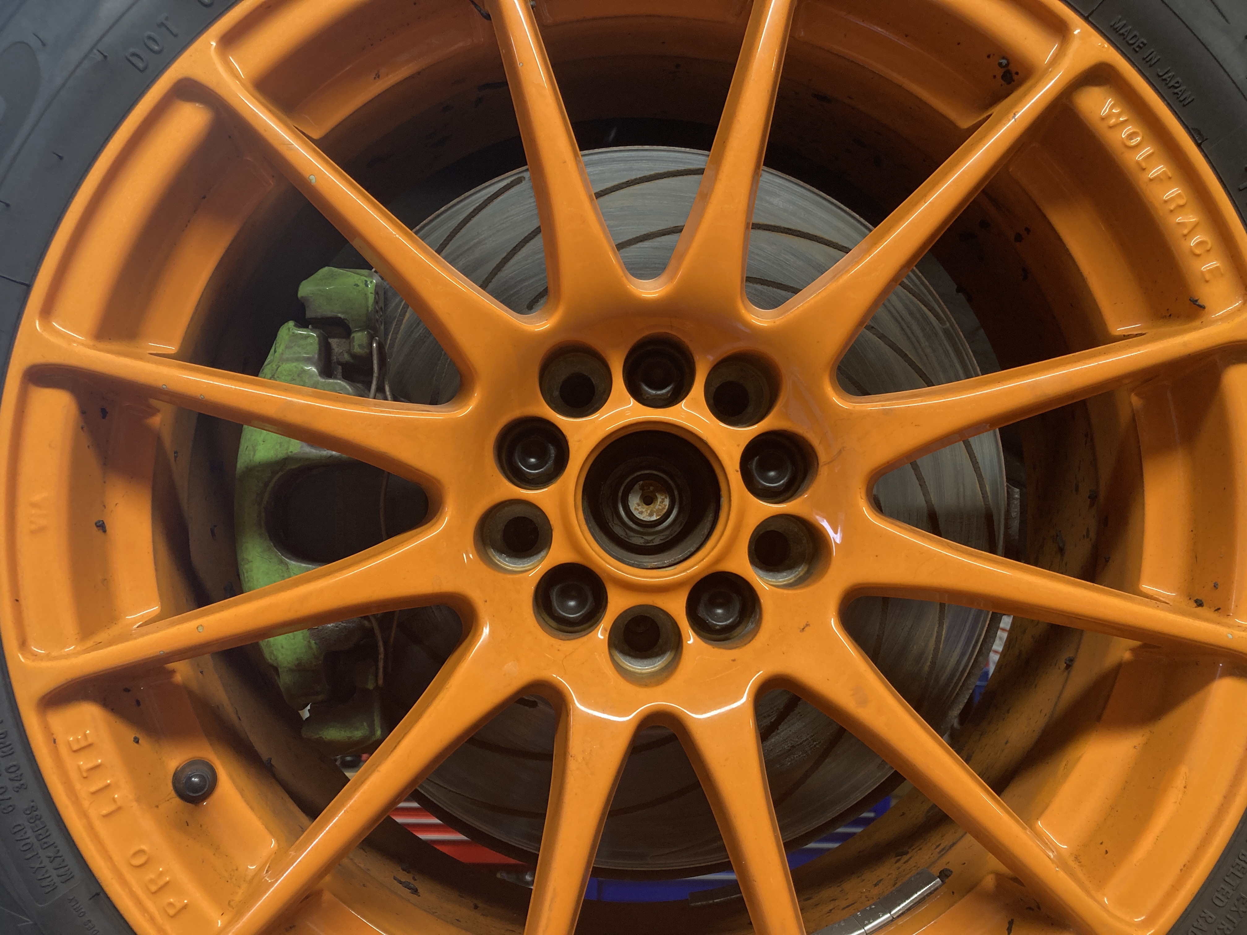

Here's hoping that they fit under my nice set of 17" Wolfrace Prolites...
From what I remember, they didn't fit behind Spiders, minimum 3mm spacer was required(i think), if your Prolites have thinner spokes and a higher offset than Spiders you could be OK.

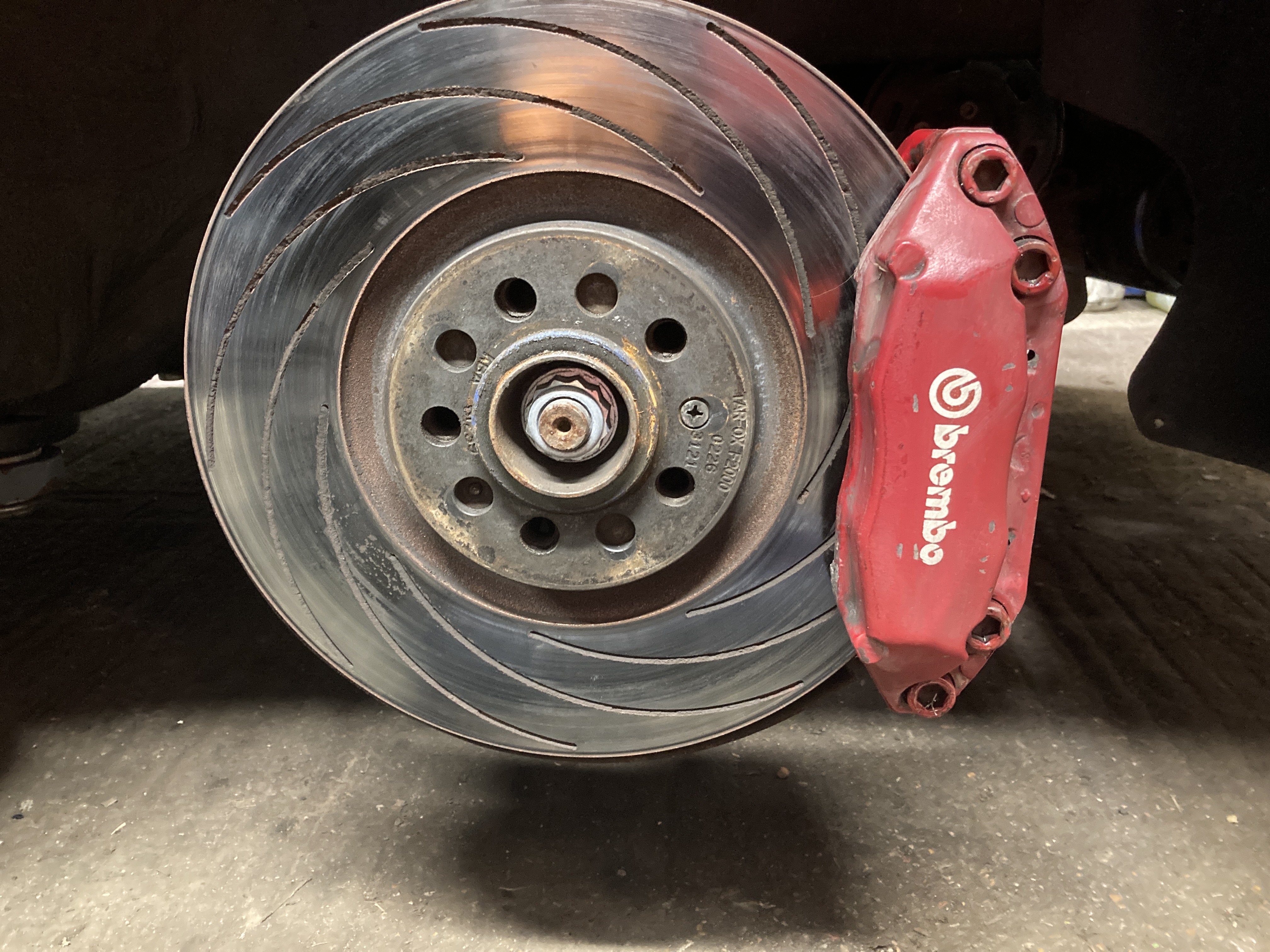

Problem solved! got the parts from the guy I got the calibers from.
Will order new discs tomorrow. Was thinking these as they are high quality. Any other recommendations?

States that they are for 17" wheels... I would hate to loose my Wolfrace wheels and a fairly new set of Toyo R888's. There seems to be plenty of space with the standard callipers...
My standard size discs, (312mm?). Looks like I will need a pair of the 323mm Discs.
Brembo calibers are fine on the diameter of the 17" wheels. The callipers foul the back of the spokes as the Brembo callipers are deeper in thickness to the front!  Alternative is about a 3-4 mm spacer, hmm.
I did a proper mock up the other day. With the correct size discs and calipers fitted I would need a 10 mm spacer.
I would not run anything more than a 3 mm spacer as this car is used for Track Days. The G force that is generated with sticky track tires puts such a strain on the front suspension front/axle et cetera that I would not risk it. Also, with a 10 mm spacer, the tyres would foul the wheel arches.
Looks like if I want to go ahead with this, I need another set of wheels with the correct offset.
Question, I assume that wheels from an LCR have the correct offset? Not keen on losing my niece Wolfrace Prolites…
