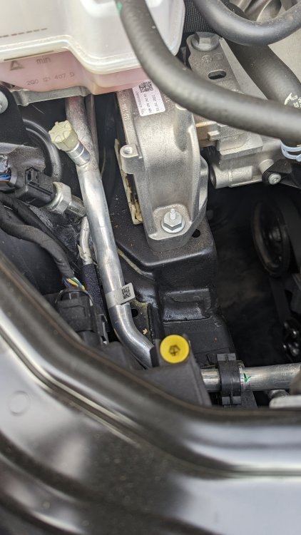

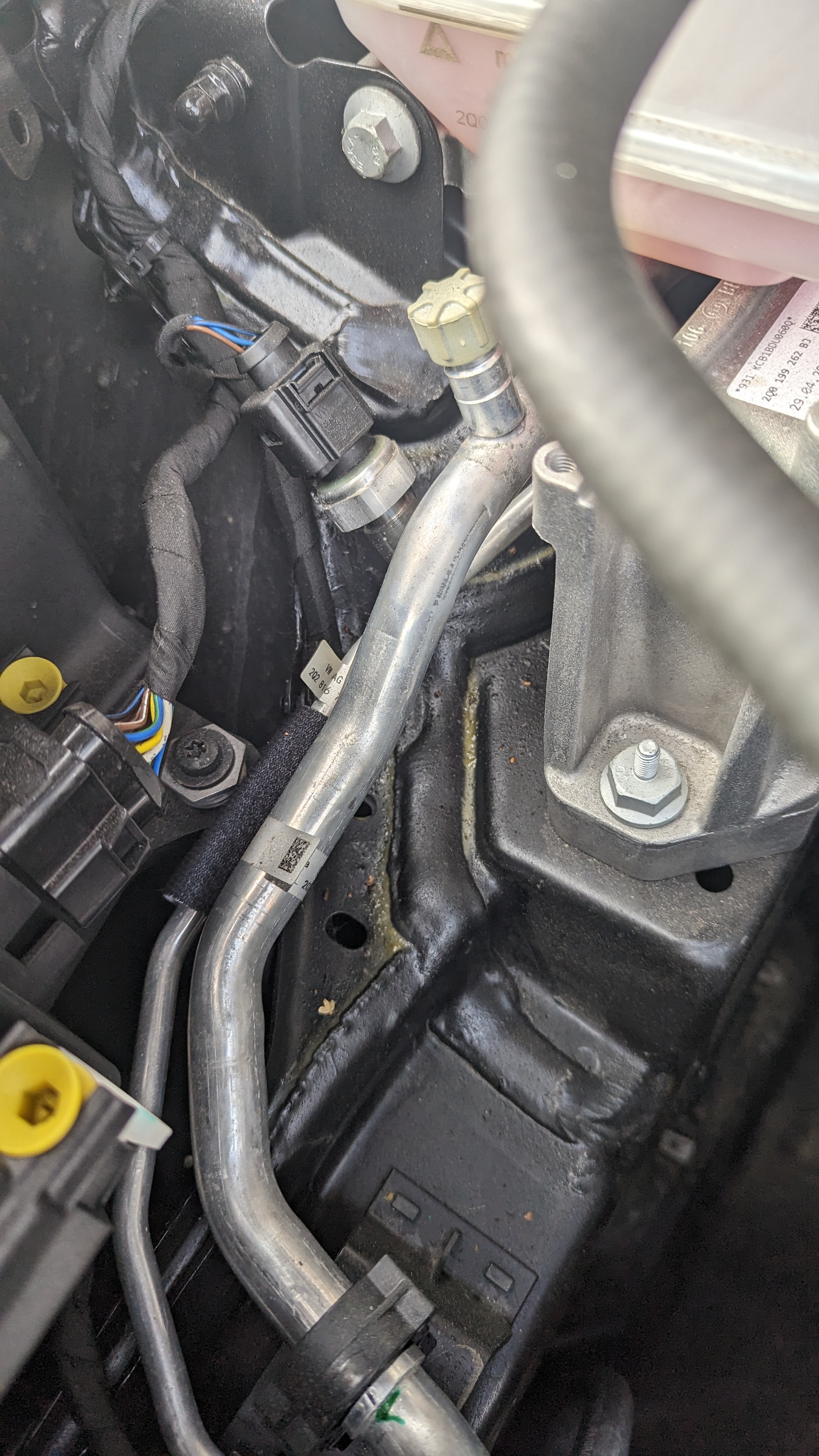

My Kamiq has just hit 15,000 miles. I've noticed there appears to be some sort of fluid leak close to the top left engine mount. It looks like the fluid is coming from the mount (are the mounts oil filled?)
Has anyone had similar?

It is the engine mount that has leaked the fluid, my Kamiq is now on 32k and I still haven't replaced it.
The mount has got progressively worse and I get some vibrations on full throttle above 60mph.
My local garage quoted me £250 for the part from Skoda, strangely the mount for LHD cars is a lot cheaper than RHD.
I will get round to changing it.

Or just miscommunication, left side engine mount rather than LHD?
Pictured one being right side.

Managed to magnify your second image to see that the part number fitted is 2Q0199262BJ, which is a current (not superseded) part number retailing at £192 + VAT. No indication in the parts catalogue that it is RHD-specific.
Are you certain that the fluid isn't coolant, from the reservoir that seems to be immediately above that area?
