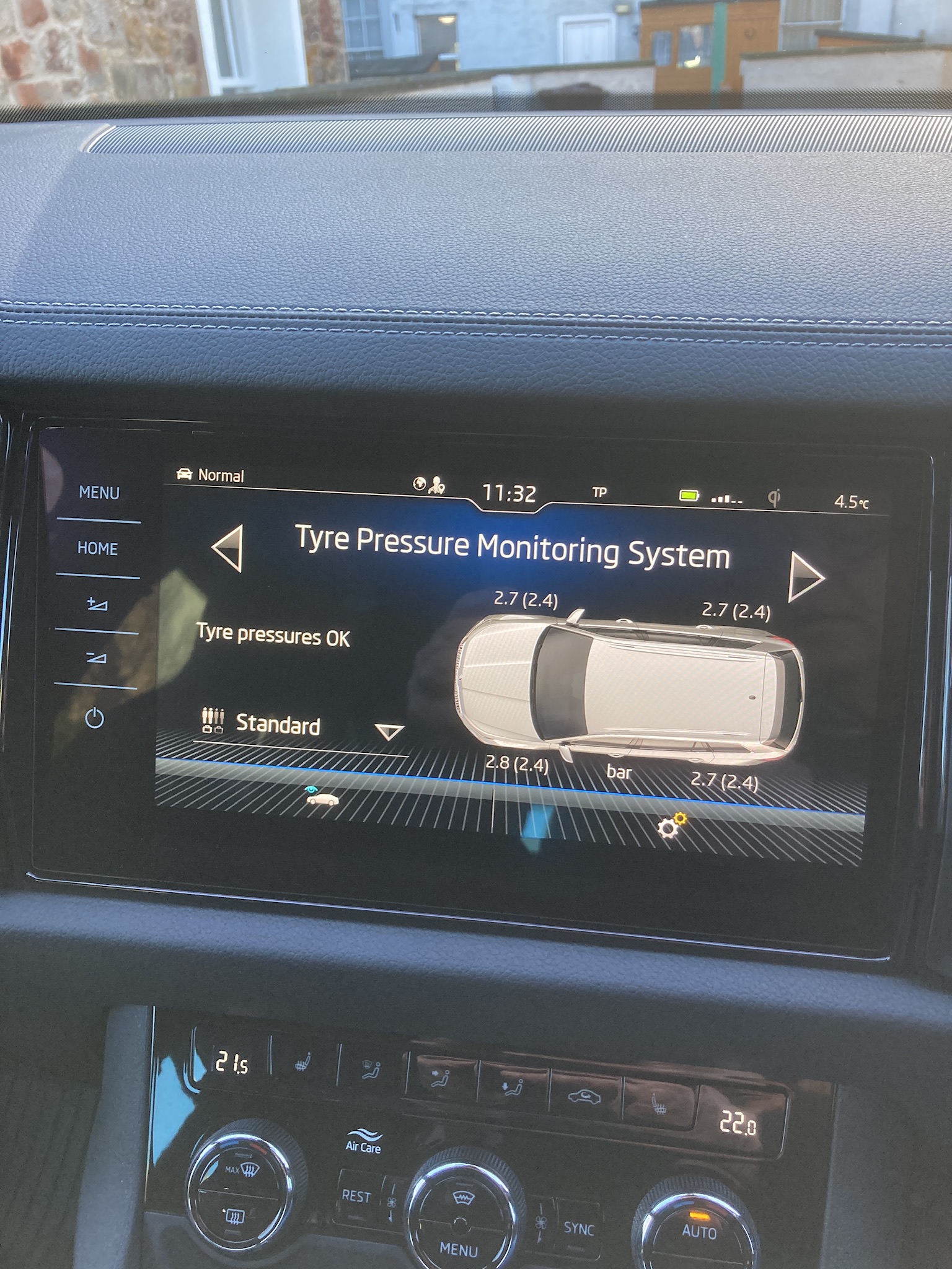

Well managed to dodge the rain for a few minutes and checked all the pressures added a few more psi in each.
Am I being thick? I can’t find anywhere to rest the pressures, Menu - Vehicle - settings - tyres. Takes me to a screen that shows wheel size and suspension settings ie 5 seats or 7 seats also winter tyres yes or no and speed rateing limit.
nowhere can I reset the tyre pressures.
But the screen that shows the 4 wheel pressures has updated to new pressure for each wheel.
So I’m guessing it does it automatically, like my Tesla did.

With the direct tpms the display  shows the current tyre pressure and the recommended pressure in brackets. No need to reset as in previous indirect tpms.
Ok thank you, that’s the screen I got.
