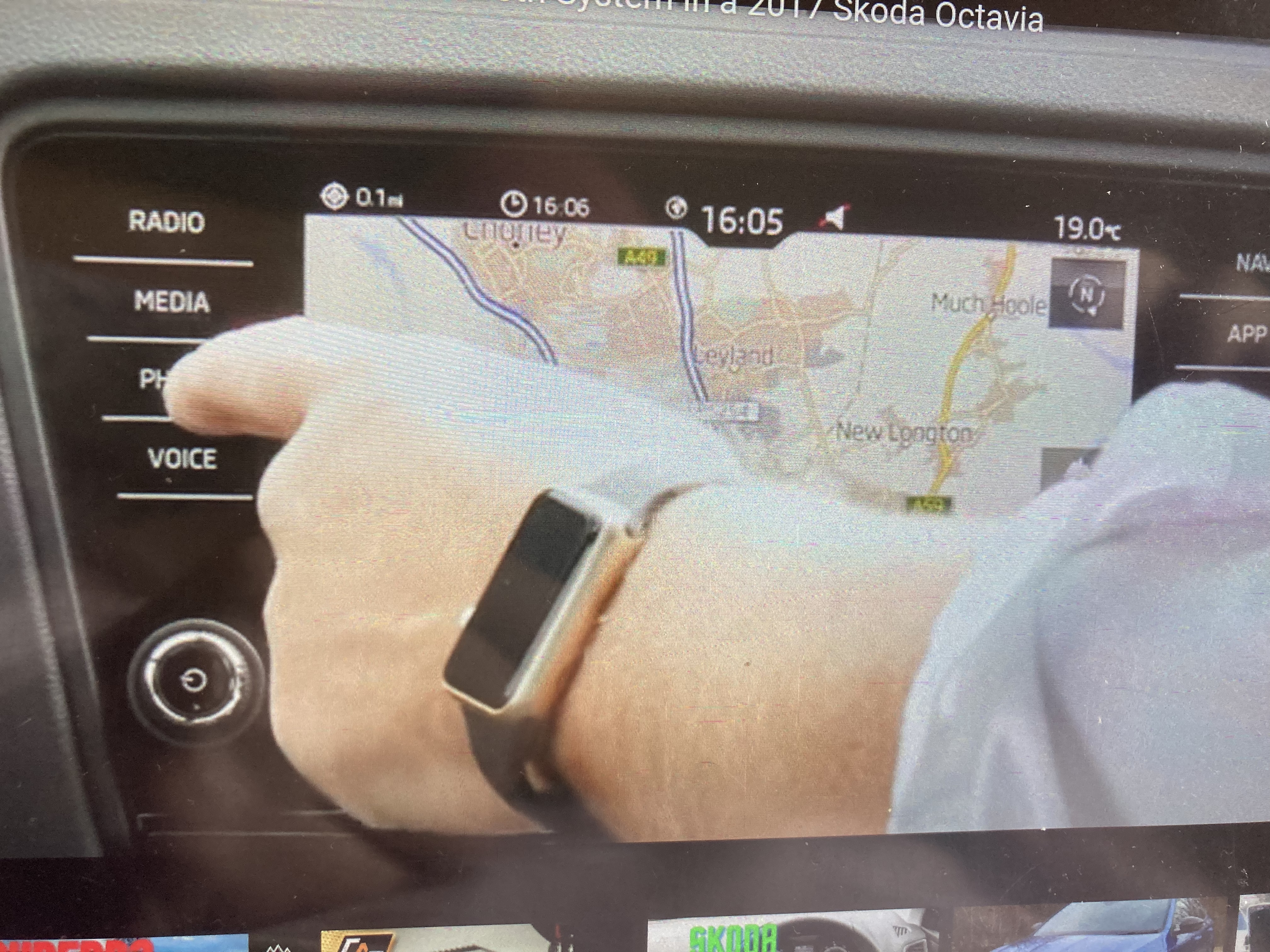

My phone connected, hooray!
Download, downloaded, hooray!
Two unwanted Phones in the menu, STILL there. I resorted to you-tube but the Skodas
there had different infotainment set ups.

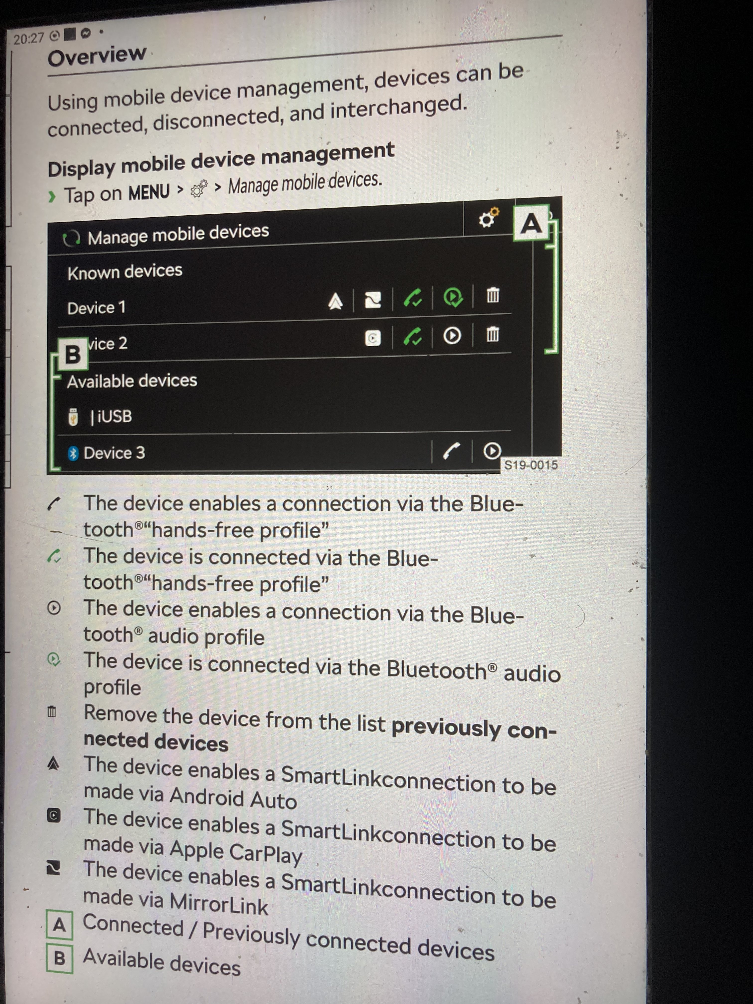

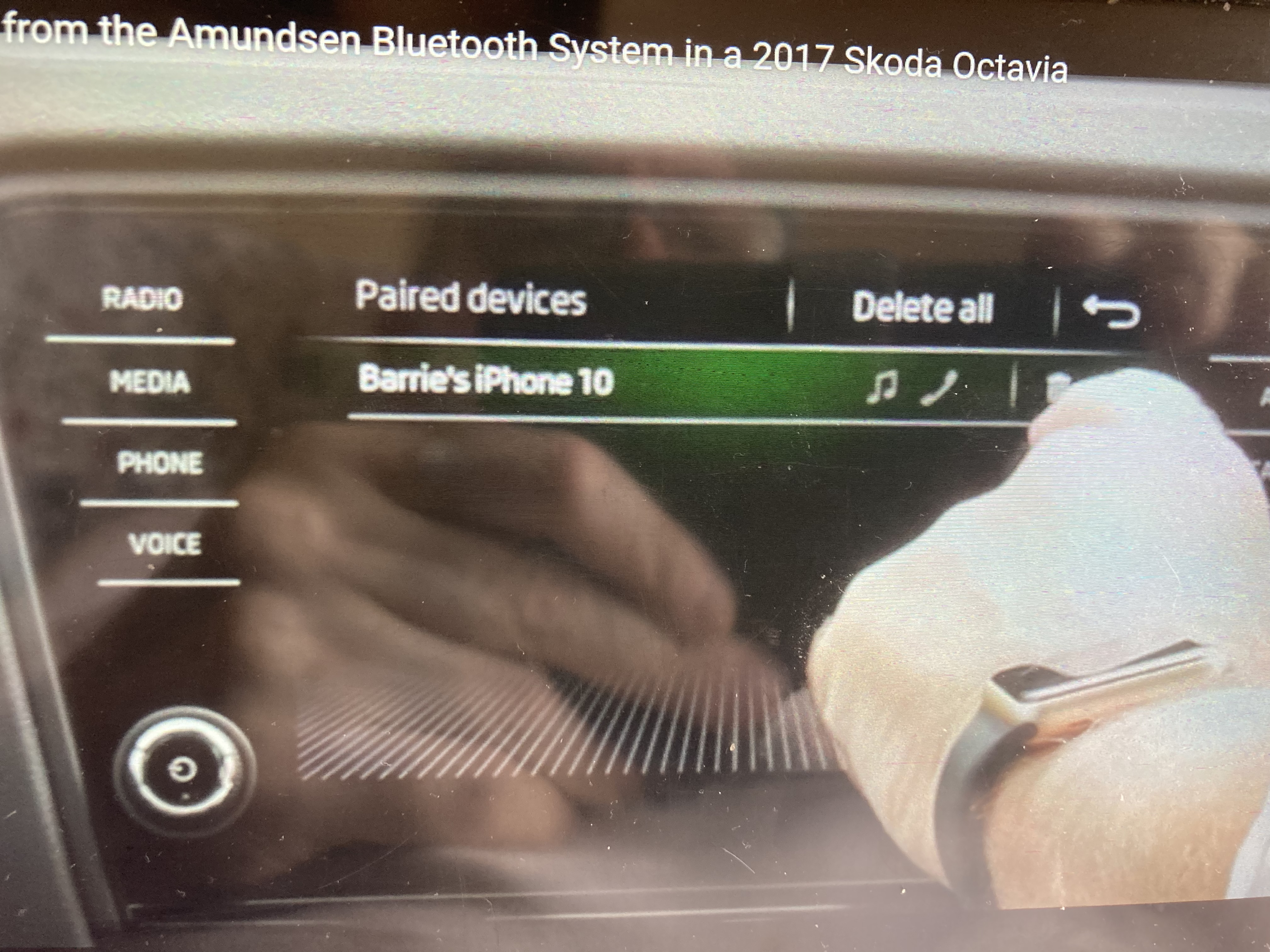

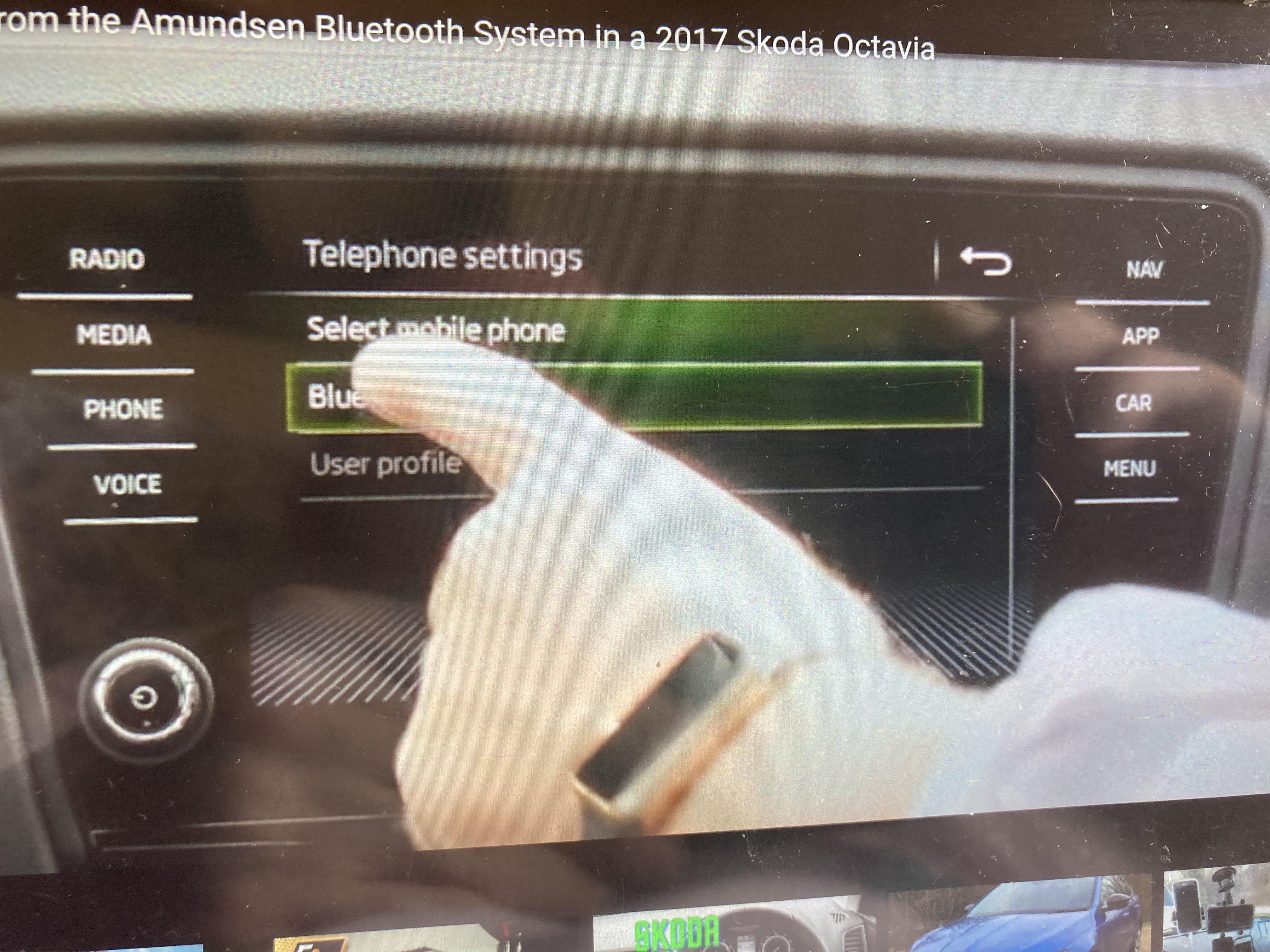

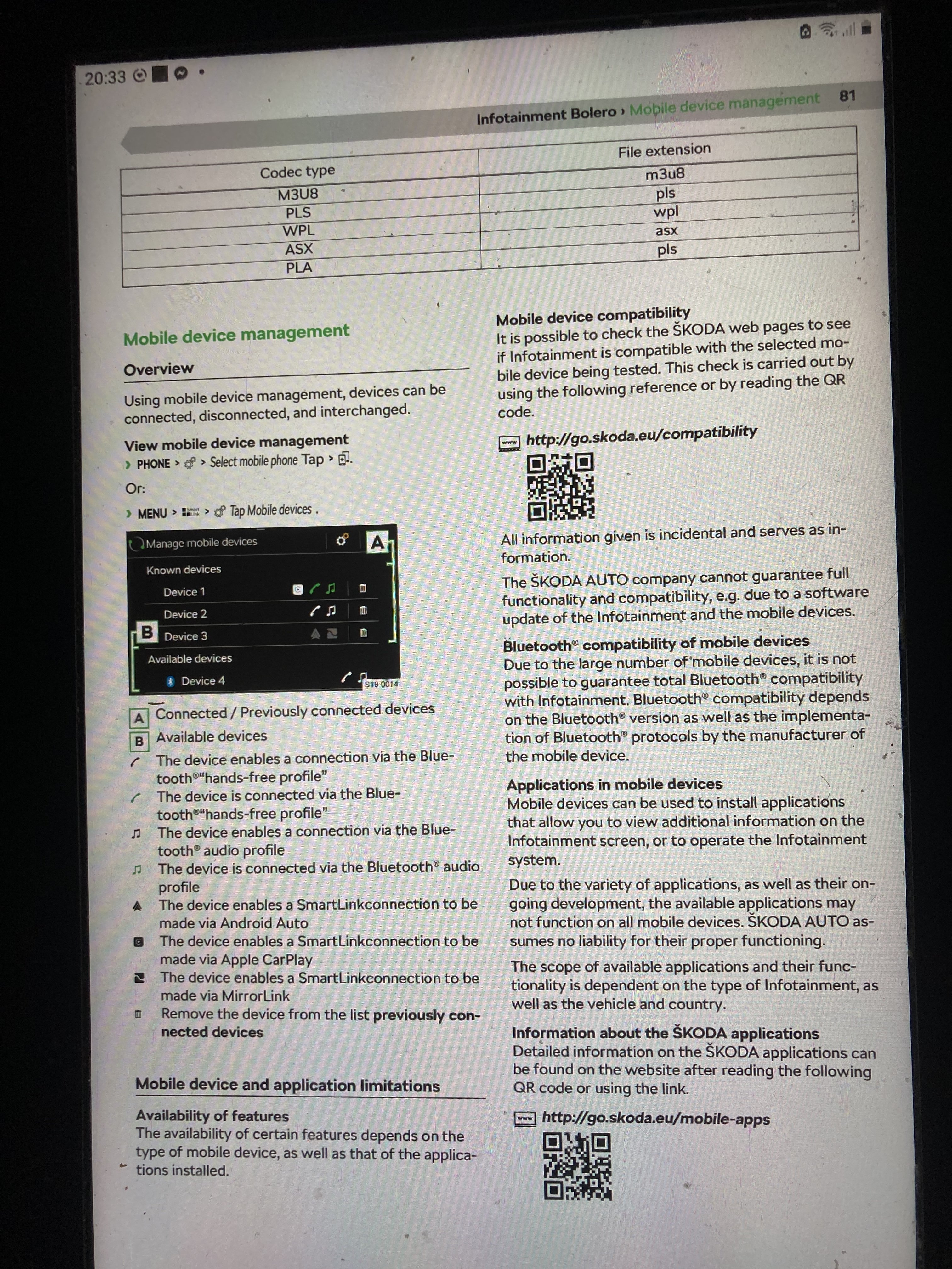

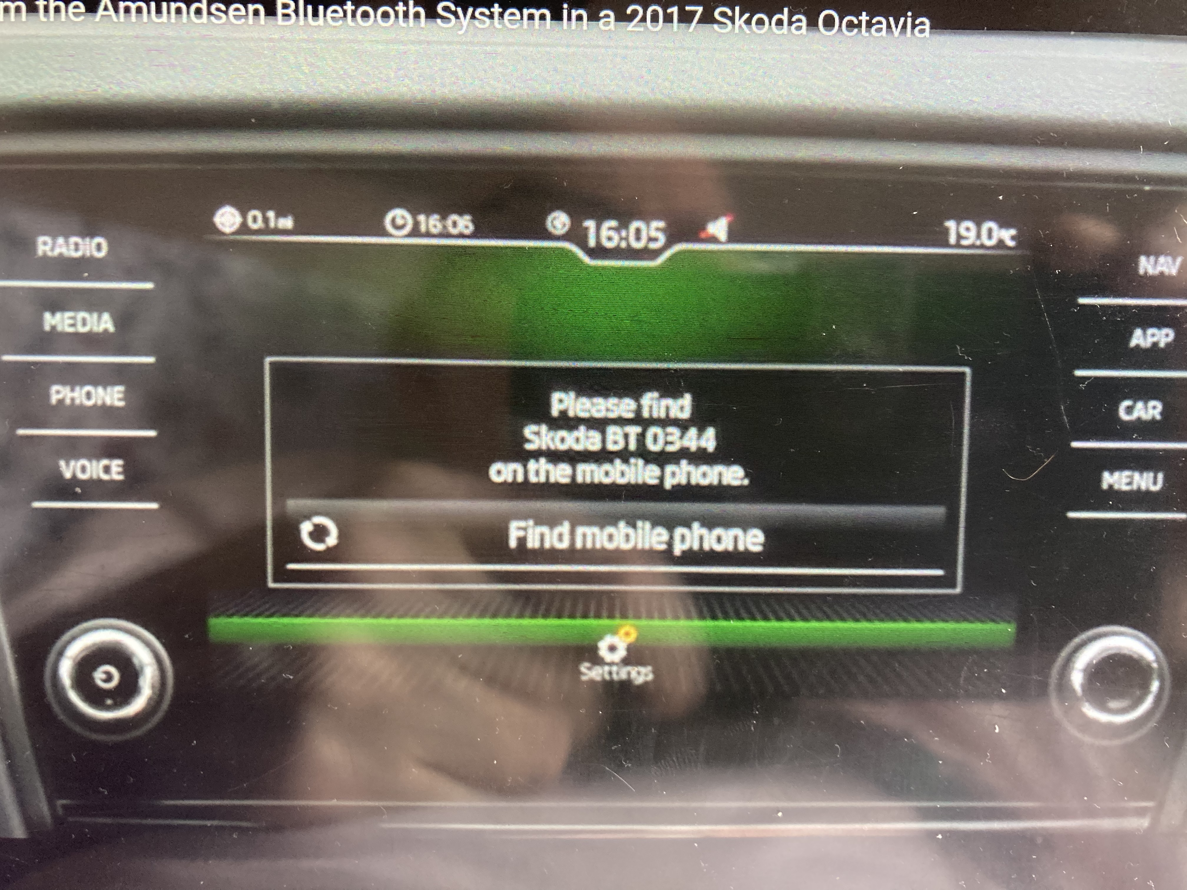

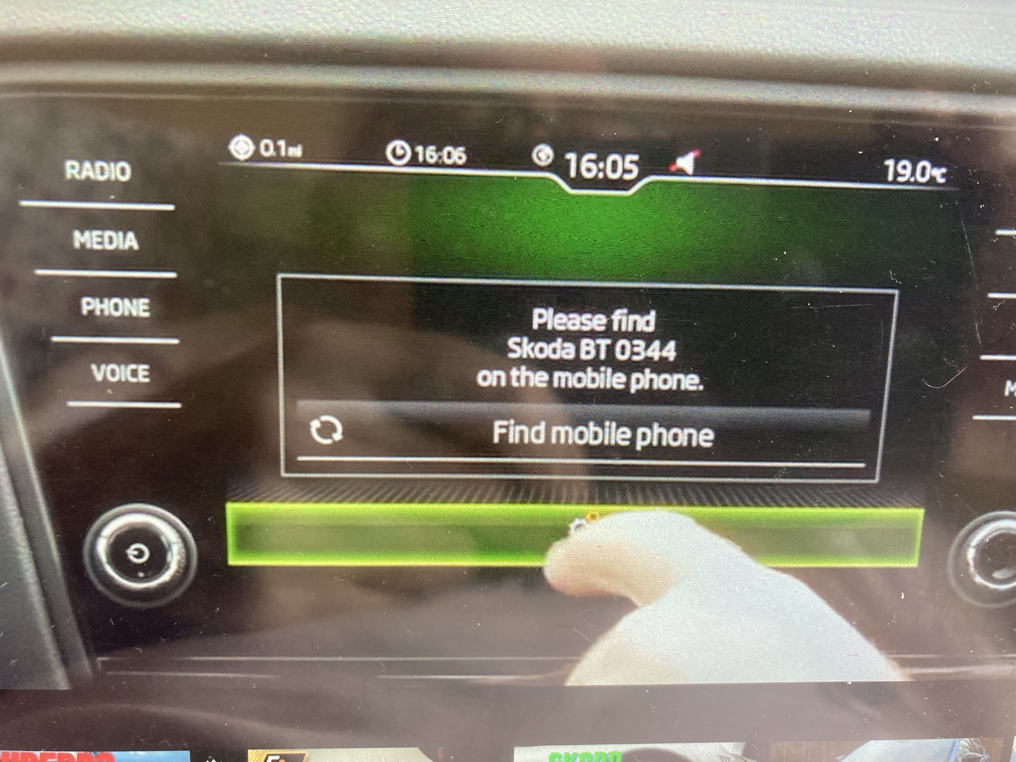

 Owner’s manual First is Balero second is Amunsden
Edited by skoda1982
I have no idea what my infotainment system is but none of the screens look like these. Thanks for trying.
They are photos I took out of the owners manual they are not on your screen  just follow the instructions. What spec of car do you have do you have knobs or just a flat screen on your informant. It’s the Bluetooth you get rid of not the phone. Delete the Bluetooth connected to the phone it deletes the phone.
try the steps in the photos starting with the first then work down
Edited by skoda1982

Got a pond myself it is hard work. Your unit is Amundsen then follow second picture
