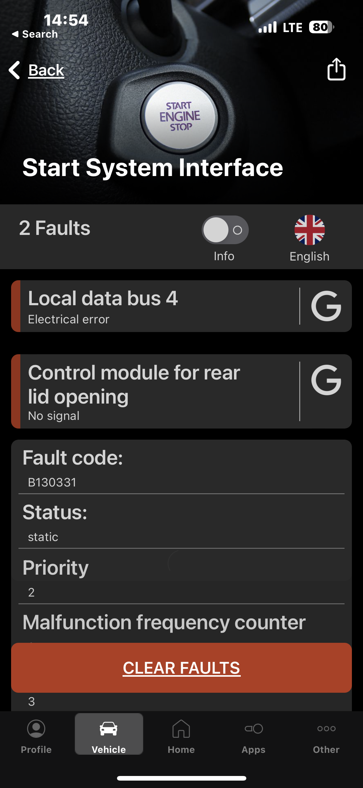

Today my trunk didnt open, when i try it to open with foot.
I scan with obdeleven and i got this fault code.
One day before i normaly open trunk with foot.
What can be wrong?

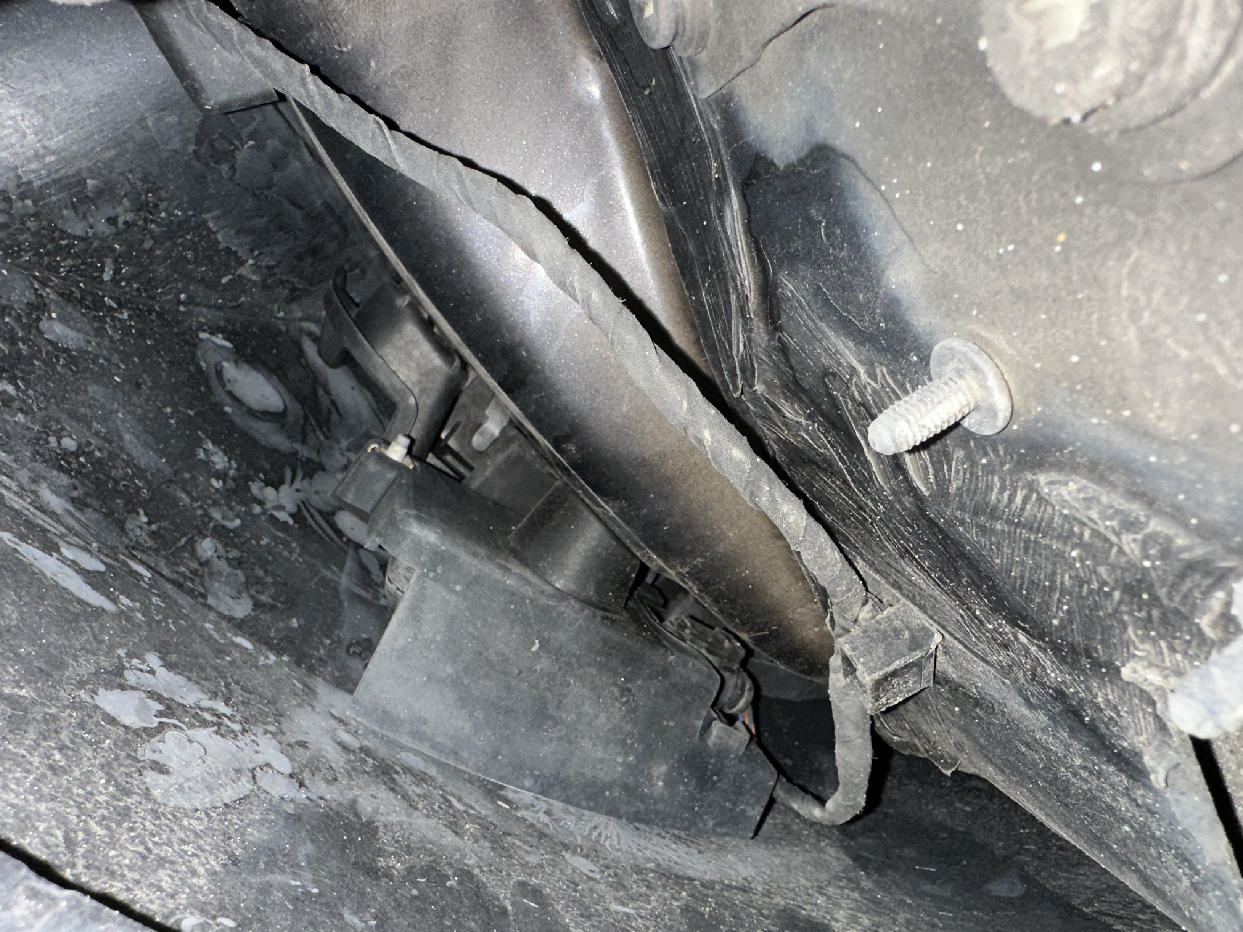

Above exhoust i see one box with one plug and i thing this is radar for blind spot detect.
Can you please paste picture how looks this box?
Probably easier for you to take and paste a pic of what you can see on your car, so AS can comment on that?
Edited by numskull
I found it.  Both conectors are plug in.
And for what is this fault code?

On 26/03/2023 at 14:30, Seba800 said:
This isn’t it. It fits on the top of the rear splitter with 2 visible connectors
Your diagnostic tool isn’t giving much detail and this is where the genuine tool or genuine vcds gives more details to assist.
What is that “thing/sensor” he’s shot there, AS?
That will be the blindspot monitor/radar
Cheers….👍🏻

               B130331 - Control module for rear lid opening
           No signal
               static
                   Priority - 2
               Malfunction frequency counter - 1
               Unlearning counter - 10

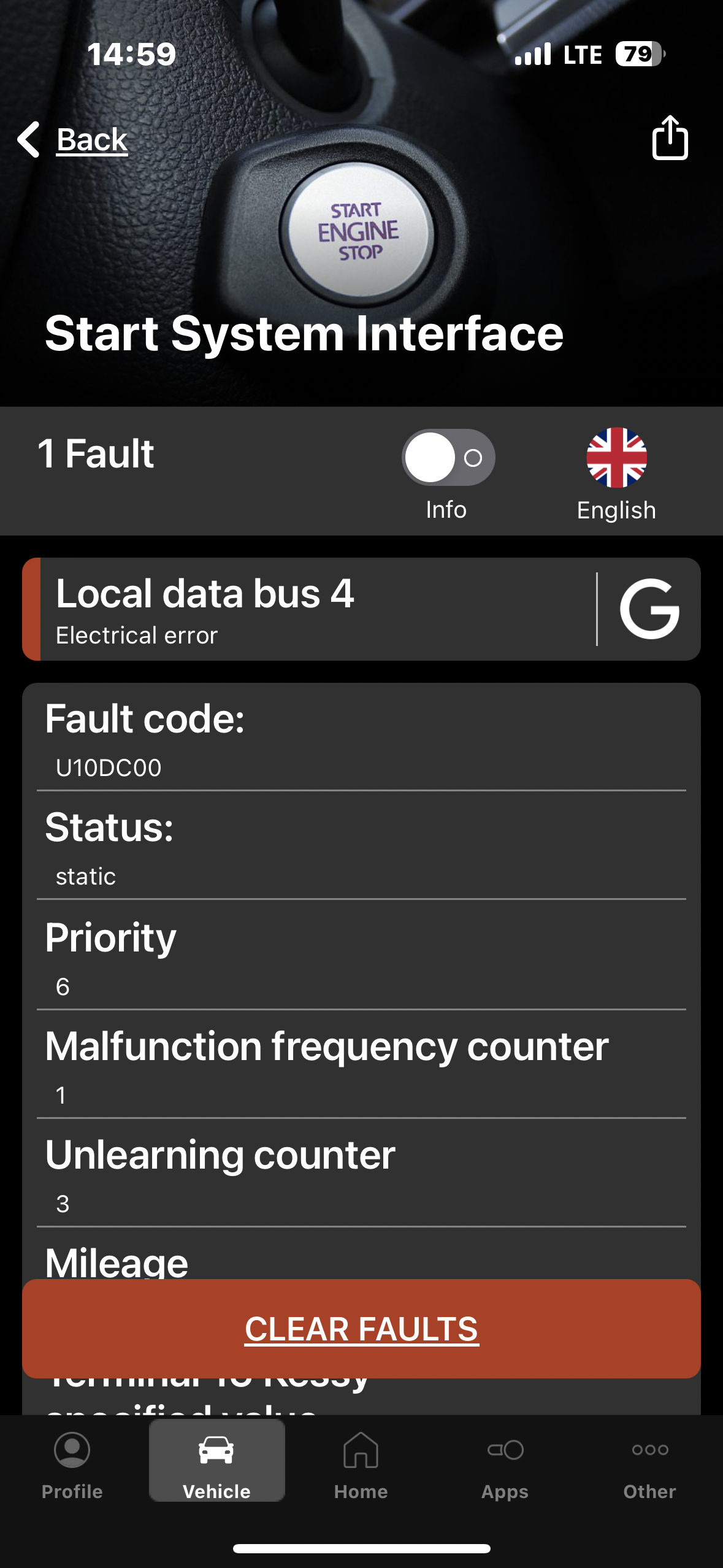

Update:
I have disconect conectors and there was one pin litle corodet.  I clean it and plug them back.
There is no more fault code for control module for rear lid opening.
But There is stil fault code  for
Local data bus 4
Electrical error

Hello
Update:
Today i try open trunk with foot and it works open and close flyless..
But it works only when car is not locked.
when its locked doesent work.
Can be that obd eleven has mess up with coding other things (auto coding feautures in app) ?
