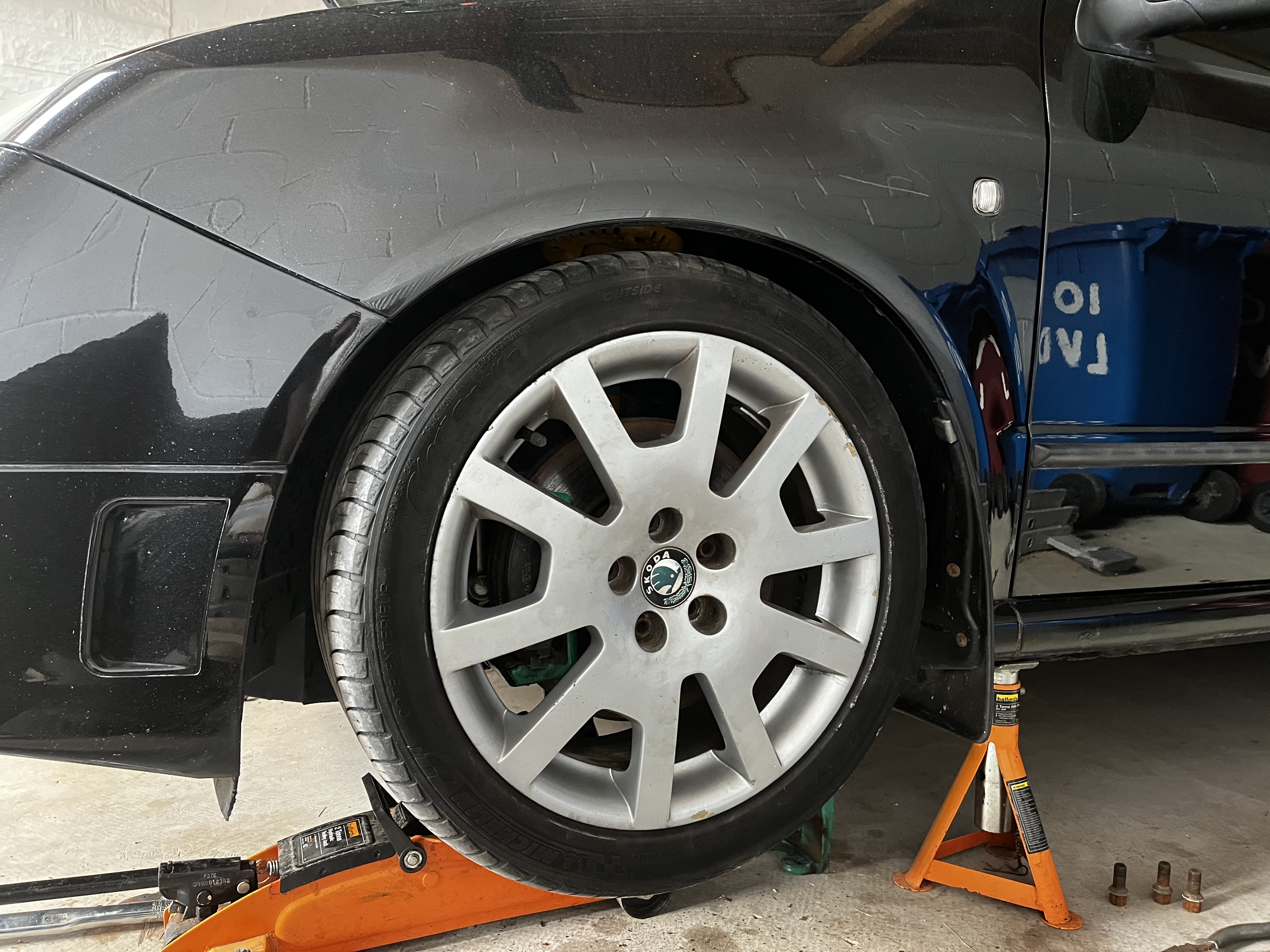

wouldn’t go past 25mm. I did some measurements. On stock springs on the front you have around 2.7inch of bump travel before hitting the bump stops and 2.1inch of rebound. Problem with going more than 25mm (1inch) is you run the risk of hitting the bump stops which you don’t want to do. So when you seen anything slammed on springs then their riding on the bump stops.
To give you an idea. This is with the spring removed and the damper compressed to the point it hit the bump stops. So basically no suspension travel left.
Edited by faboka vrs
But, hey, you've minimised that crucial "arch gap" that the idiot babies hate so much, now all it needs is some 18's with rubber bands fitted!
That's very enlightening thanks for that 👍
