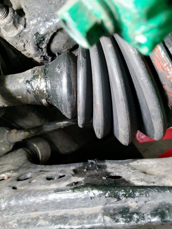

Just cleaning car underneath and noticed grease drips on front left wheel from a split in outer CV joint boot near the inner crimp. Probably caused during timing belt change with engine hoisted up straining rubber boot on driveshaft and age related wear.
At 95k miles do I change the CV joint outer or just the rubber boot? I read CV joints do 70k to 130k miles. Reading on, I have to take the old CV joint outer out before fitting the new rubber boot. Or is this is what the CV boot tool is for? Which is recommended for the Fabia? Is it doable without taking off driveshaft, I don't want to mess with inner CV joint. Watched a few videos and some mechanics take CV outer joint off, some use the cone tool (and remove driveshaft into a bench vice). Opinions please?

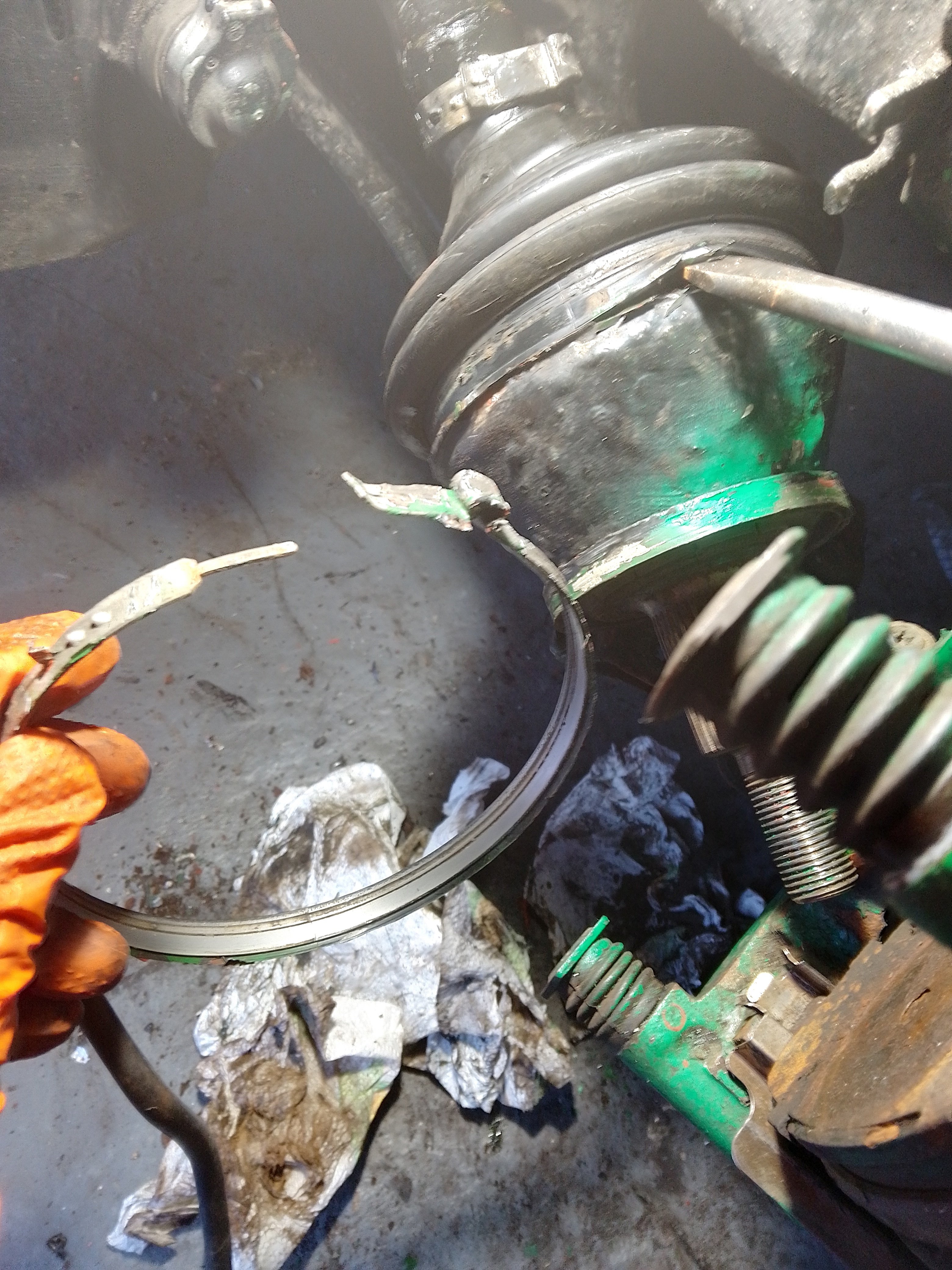

Ok, I had another go this pm.
Watching both videos I posted above involving CV joint puller I realised the problem. My outer CV joint metal cup is too wide for the puller. The two metal prongs touch the CV joint jamming it.
See photo
The end of the puller goes over the hub nut threads but then is a few cm from touching the CV joint over the threads that engage the wheel bearing - gap between my thumb and index finger.
See photo
Tightening the 12 point 35mm hub nut only serves to squeeze apart the two puller prongs. I took the clamp out btw of the puller. Reversing the tool, the hole at end is wider than the threads so this not the issue.
I only seen this tool and those for use on trucks. Surely a Fabia doesn't have the largest CV joint of all cars?
Distance between prongs of puller is 9.8cm
I put driveshaft back on hub and ball joint back on. Probably going to take to garage 1/4 mile away and bag CV joint and tape ends to protect.
Seems to be one of those jobs which is seldom done and needs pricier tools.
I had to hammer prongs to position. Risks damage to threads when tightening if offset.
