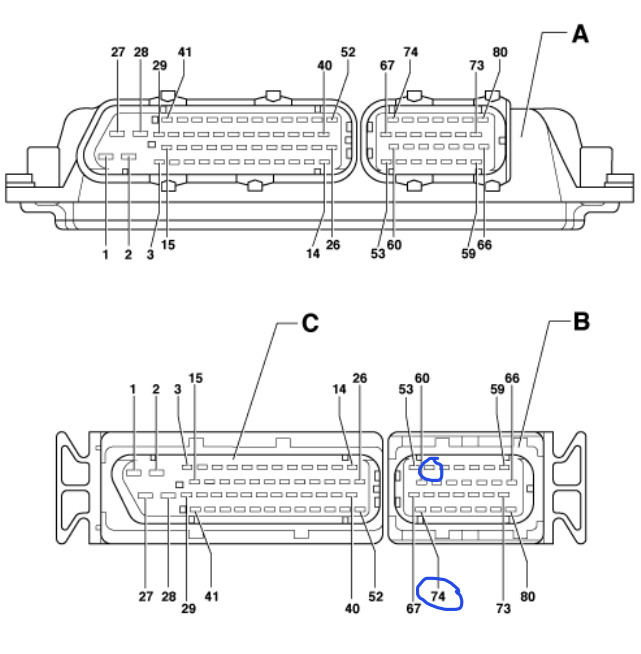

Hi thanks for your reply.  Unfortunately I have no technical docs at all for this so winging it at the mo. If glitch in data is found still don't know if cause is ecu or wiring unless - I cut the two wires close to the ecu and maybe connect a suitable resistor to show the ecu a constant 1 volt or something (about 90 degrees i guess) and eleminate the wiring all together ?
Iv done a lot of corsas and ecu faults were very common but because they are more crap and expensive now, Im doing VAG only due to ross tech.
Maybe I might try and use the max value on my DVM and check once it comes back if it went over 5 volts but still could be either.
Is so nice to have details like these, really appreciate it.
if that brown goes elsewhere then my initial plan of cutting and running an exclusive pair from ecu to temp sensor will cause problems.
I always see it as the ecu supplys the earths to each of it sensors rather than the earths going to the ecu, Normally each sensor has an exclusive earth so thats interesting. Do you know what other sensor(s) are supplied from that splice?
Thanks.
there you go... cam sensor or crank would be one of my guesses. I thought you were gonna say all of them lol. So there are other earths on that socket of the ecu. Chances are its one of these shared components that are less sensitive than the temp sensor. Should be able to pull of the cam sensor once running. Ill have a play with it later and report back! May have to use my 80s oscilloscope so that'll be nice. 👍

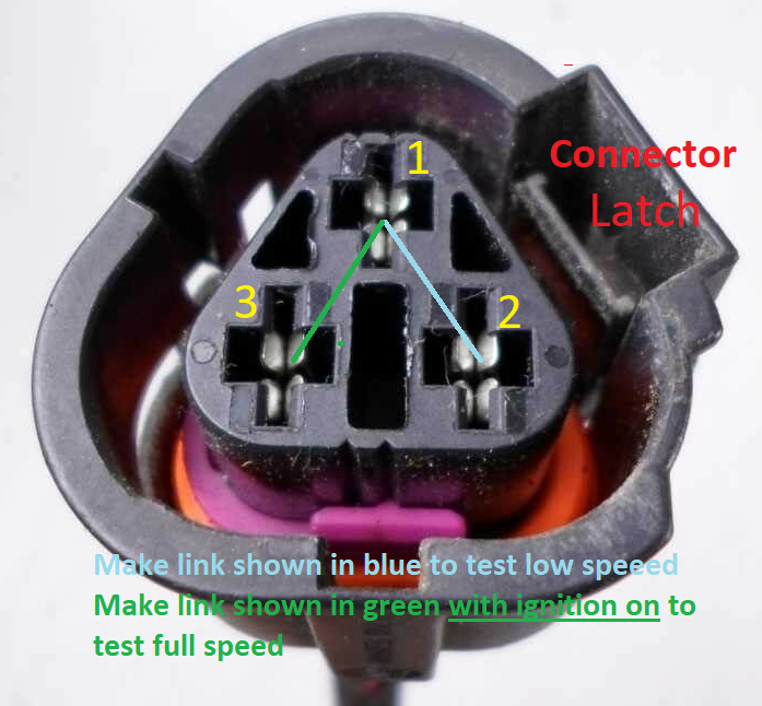

Also found that VCDS only provides 2 output tests for the engine so will test cooling fan the old way. So far then no real problems but will come back if I find any. Thanks for your help Pete.

The rad with fan are brand new after market type Im sure its ok at this end tho am yet to get the fan on by itself. Went to 99 degrees and nothing so switched off. I need to take it out on the road and boot it to be sure its bled properly but got bumper off ATM. Im getting new MOT mid week so we'll see if there are actually any problems, for now all seems well!
